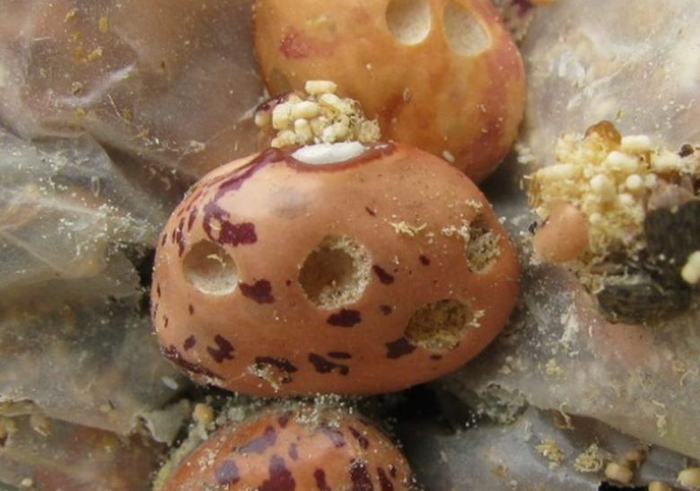

Damage of weevils to beans
This small beetle lives mainly on the seeds of the bean. The damage is caused by the larvae that penetrate inside the seeds and develop there. From the seeds, then, the adults come out, which open their way by making a net round hole. Each bean seed (depending on size) can house up to 8-10 weevil larvae. Beans infested with weevils lose their germination capacity and, of course, also their food and commercial value.
