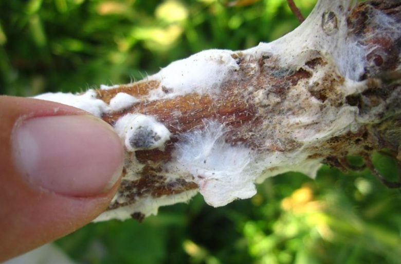

Identification of sclerotinia and damage to plants
Sclerotinia is recognized by the formation of areas of rot near the collar or along the stem. The attack usually develops on already developed plants and the affected areas appear browned and then rotten. The rot is due to the formation of a whitish and cottony mass. On this mass, then, the typical blackish spots called sclerotia, circular in shape and about 5-10 mm in diameter. Affected plants perish in a short time and wither, eventually collapsing if the infection progresses by attacking the internal tissues. Fruit close to the ground can also be affected, resulting in blackish-brown lesions.
