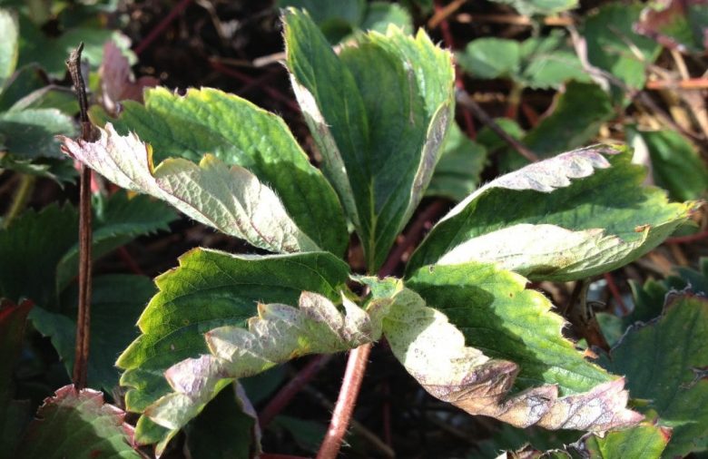

Strawberry powdery mildew
Powdery mildew is the most common and fearful disease that affects strawberry plants. It is widespread in all cultivation areas, both protected (greenhouse) and in the open field. Specifically, the powdery mildew of strawberries is caused by fungal pathogens Sphaerotheca macularis (sexual form) e Oidium fragariae (asexual form). The wintering of the pathogens occurs as quiescent mycelium in the stolons, or, in the sexual form, as cleistothecia, which differ in autumn on the various organs.
Also on this fruit the symptom is the typical one, that is the formation of a powdery whitish efflorescence which, on the strawberry, manifests itself on the underside of the leaves. Over time, the scrub spreads over much of the vegetation, the leaves roll up and deform, and finally dry up. Stolons, petioles, flowers and fruits are also susceptible to attack, especially in the pre-veraison phase. Then the plant stops its growth, aborts the flowers and rots the fruit.
Conditions favorable to the disease
The oidic infection is favored by conditions characterized by high environmental humidity, but not rain, and by temperatures that are not too high, around 18-20 ° C. These conditions are typical of spring and autumn. Conversely, the pouring rain washed away the powdery mildew conidia and stops the infection.
