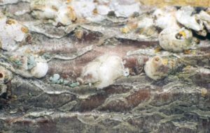

The female follicle is circular or sub-circular, creamy white with reddish exuvia in a displaced or, more rarely, central position. It measures 2-2.8mm in diameter.
The adult female form is orange in color, slightly piriform in appearance, with the most developed mesothoracic part and well-marked lobes of the thorax and abdomen. The antennae are close together, with a large conical basal tubercle surmounted by a bristle. This species of white cochineal is characterized by the presence of forked lateral glandular spines.
Then we have the male follicle, linear and weakly keeled, white with yellow apical exuvia. Measures 1mm in length.
The egg-yellow adult male has a single pair of wings and a long tail stylet. Measures 0.9mm in length.
Finally, the eggs, of orange color if females originate, white-yellowish if male individuals are born from them.

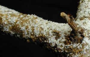

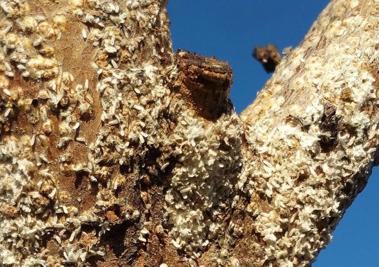

There Pseudaulacaspis pentagona it mainly infests the branches and the stem of the various host plants, giving rise to thick encrustations. The vegetative parts attacked perish and, in the most serious cases, dry up.
On fruits, such as peaches and cherries, reddish spots appear at the attachment points, very similar to those caused by San Jose cochineal (Quadraspidiotus perniciosus), only slightly more nuanced. The fruits affected are qualitatively deplorable and certainly not marketable.
