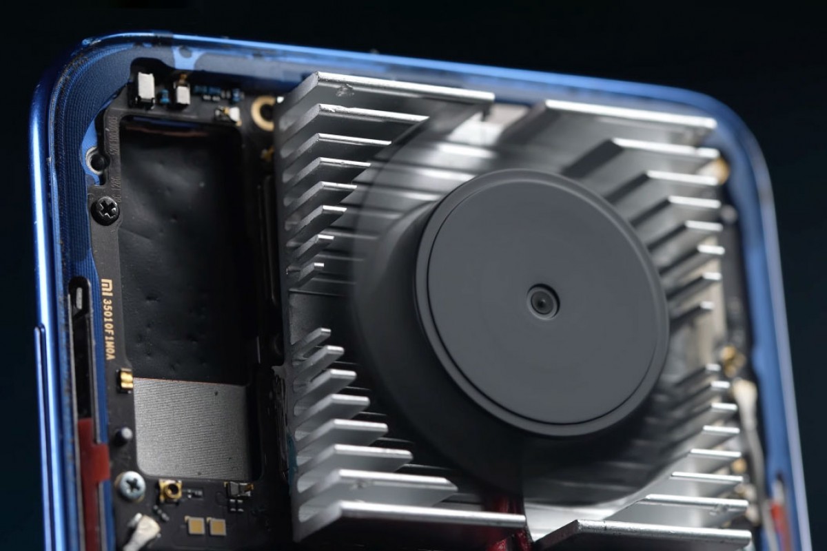

The cost of these modifications is heat. So a custom thermal management system is needed. At the factory, the smartphone is not optimized for extreme heat, which is why the camera module has been removed and a heat sink with 40mm cooling fan with thermal compound has been added. Of course, you will need to tap into the battery to power the fan. In this case, a DC to DC converter board is added to adjust the current for the 5V output to the cooling fan. They also added switches to control the fan speed.
