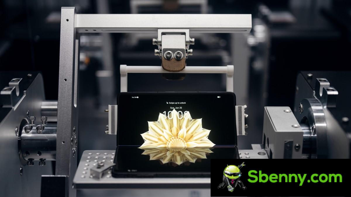

Lastly, the hinge earns certification from SGS, ensuring that the mechanism can withstand 400,000 folds. That makes up to 100 folds per day for 10 years. Not too shabby.
