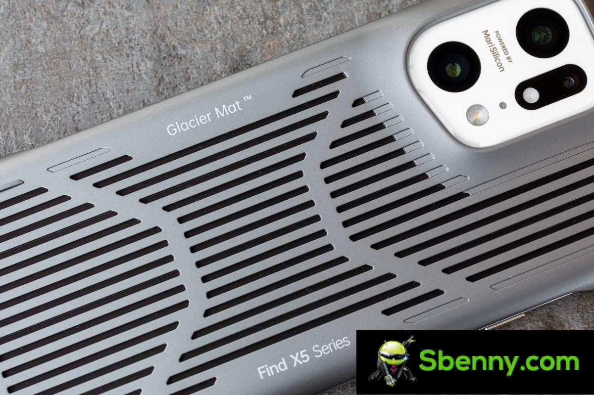

The Ice-Skin case is unique because it incorporates a soft hydrogel layer all over the back. The hydrogel is stored inside a soft, rubbery casing, which can be seen from both the inside and the outside of the case.
Inside, the rubbery surface is flat and unbroken, keeping full contact with the back of the phone.
On the outside, the hydrogel is covered with a series of plastic strips, which offer flexibility and protection at the same time. They allow the hydrogel some contact with the environment, which presumably is all it needs to regenerate its cooling abilities. The case should collect heat from the back of the phone, continuously transfer it to the ambient air, and do it much more efficiently than any other case.
