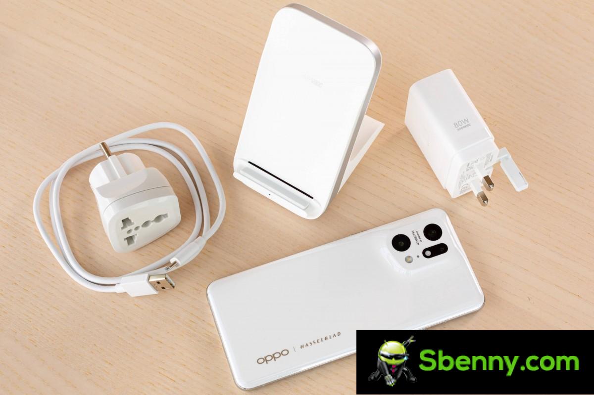

So what comes with the AirVOOC 50W wireless charger? Just a USB-A to USB-C cable. You don’t get the required 65W SuperVOOC power supply, so you’ll need to provide your own brick.

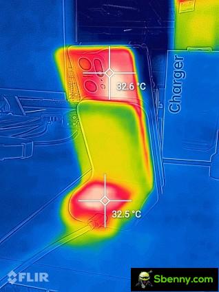

The temperatures of the AirVOOC 50W wireless flash charger during the test and Oppo Find X5 Pro after being charged to 100%
Surface temperatures on both the charger and our Oppo Find X5 Pro review unit remained low and never exceeded the 33 ° C mark during our tests. As soon as we charged the phone, we immediately tested how hot it was and it was just under 32 ° C.

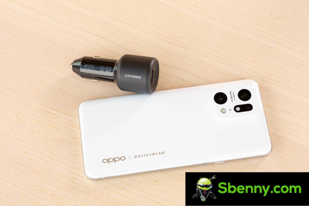

We also had the chance to test the 80W SuperVOOC car charger which promises the same charging speeds as the 80W SuperVOOC power supply bundled with the Oppo Find X5 Pro. It’s really impressive given the size difference between the two chargers.
The 80W car charger is compatible with USB PD 3.0 and has a traditional design with USB-C and USB-A ports and an LED charge indicator. Oppo again uses a six-layer protection system like on the AirVOOC wireless charger. It is important to note that you will need to use a genuine Oppo USB-A to USB-C cable (the one that comes bundled with Find X5 Pro) to reach the claimed maximum speeds of 80W (11V @ 7.3A).
Charging via the USB-C port will get you speeds up to 30W (11V @ 3A) on any USB PD compatible device. You can also charge two independent devices via both ports at the same time, although the maximum speed will be limited to 33W via the USB-A port and 30W on the USB-C connector. With all this information at hand, let’s see what Oppo’s car charger managed with our Find X5 Pro.
