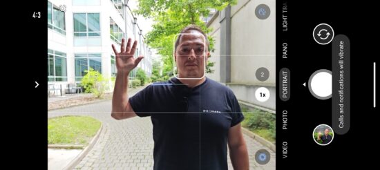

Preview tests analyze the image quality of the camera app’s image preview, with a focus on the difference between capture and preview, particularly with respect to dynamic range and the application of bokeh. The smoothness of exposure, color, and focus adaptation when zooming from the minimum to the maximum zoom factor available is also evaluated. Preview frame rate is measured using the LED Universal Timer.
Asus Zenfone 11 Ultra – Preview – Bokeh effect much less pronounced than the final capture
