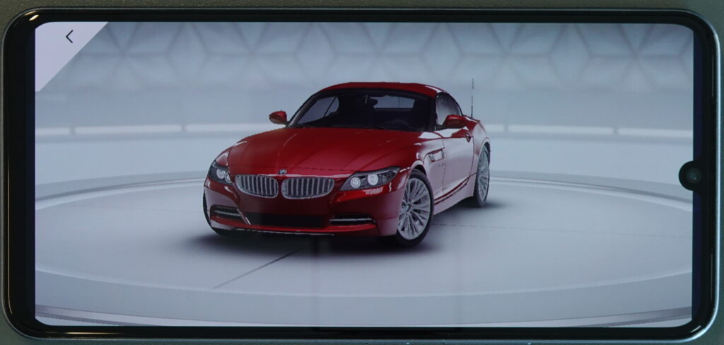

The Vivo X80 Lite 5G has good color fidelity, along with good uniformity for both brightness and color. Its biggest drawback is its readability in low light conditions, where it shows instability, i.e., even at the same level of ambient light, the display produces different levels of brightness. Also, the device’s high-brightness mode gives an unnatural look to skin tones in outdoor conditions. While frame drops are rare when playing video games, the X80 Lite 5G does not offer a comfortable user experience because it is not very smooth and exhibits visible aliasing.

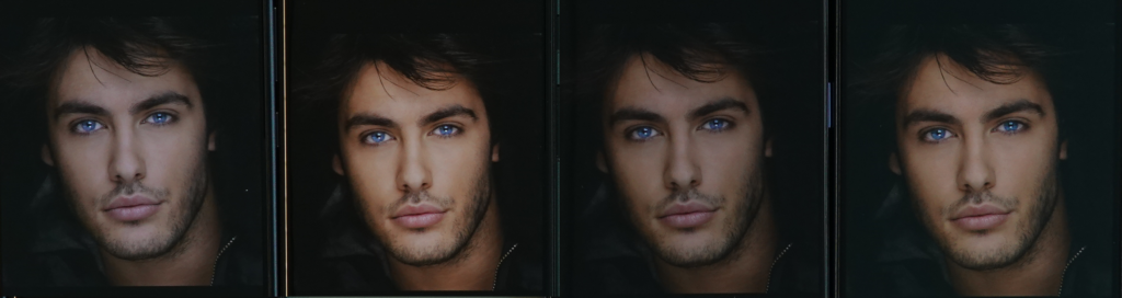

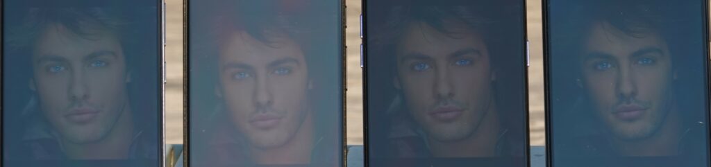

Readability evaluates the ease and comfort with which users can read the still content (photos and web) on the display under various real-life conditions. SBMARK uses its Display Bench to recreate ambient light conditions ranging from total darkness to bright sunlight. In addition to laboratory tests, perceptual analysis is also performed in real-life environments.
From left to right: Vivo X80 Lite 5G, Google Pixel 6a, Oppo Find X5 Lite, Samsung A53 5G
Readability in a sunlight environment (>90 0000 lux).

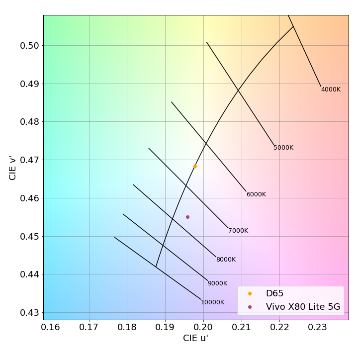

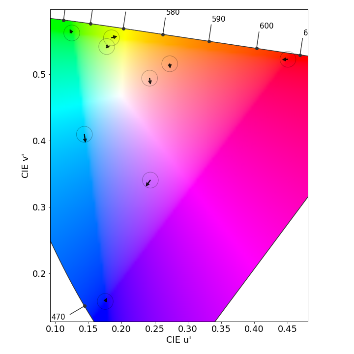

The color attribute evaluates the device’s ability to faithfully reproduce colors. Measurements taken include fidelity, white point color, and gamut coverage. We perform color assessments for different lighting conditions to see how well the device can handle color in its surroundings. Colors are measured using a spectrophotometer in a controlled lighting environment. The perceptual analysis of the color rendering compares with the reference model displayed on a calibrated professional monitor.
Color fidelity measurements
Vivo X80 Lite 5G, color fidelity at 1000 lux in the sRGB color space
Vivo X80 Lite 5G, color fidelity at 1000 lux in DCI-P3 color space
Each arrow represents the color difference between a target color pattern (arrow base) and its actual measurement (arrow tip). The longer the arrow, the more visible the color difference. If the arrow stays inside the circle, the color difference will only be visible to trained eyes.

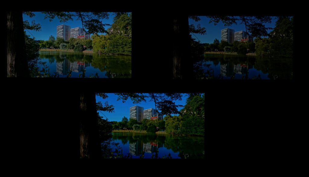

Our video attribute evaluates each device’s Standard Dynamic Range (SDR) and High Dynamic Range (HDR10) video handling in indoor and low-light conditions. We measure the tone mapping, color gamut, brightness and contrast of the display. We perform perceptual analysis Cons our professional reference monitor (Sony BVM-HX310) to ensure rendering respects artistic intent.
Clockwise from top left: Vivo X80 Lite 5G, Google Pixel 6a, Oppo Find X5 Lite

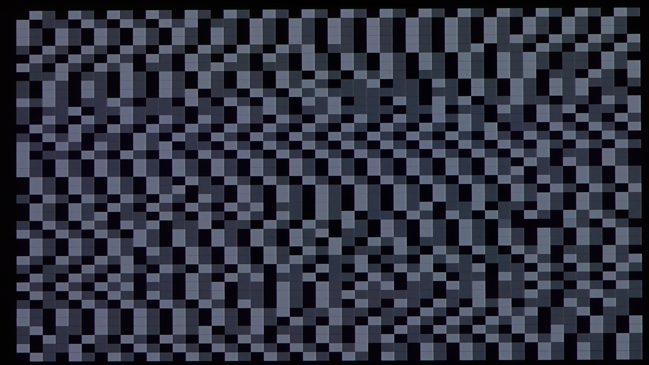

Evaluating artifacts means checking performance, image rendering, and motion artifacts that can impact the end-user experience. SBMARK accurately measures device reflectance and flicker, and evaluates the impact of residual aliasing when playing video games, among other characteristics.
Aliasing (foreground)
Vivo X80 Lite 5G
