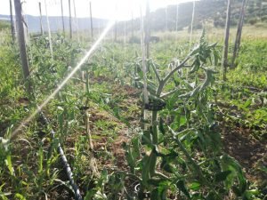

- Head post and tie rod
- Intermediate support pole for tomatoes

During the crop cycle, the support for the tomatoes tied with the wire must be carried out progressively, as the plant grows. In other words, we will grow the plant around the wire. There are two ways to keep the plant attached to the wire.
The first is to turn it around the wire itself, paying great attention to make the wire rest on the leaves and not on the flowers, which could get damaged. Every 20 cm there is a turn. The other system is to use special and practical clips, which anchor the main stem of the plant to the wire, which rises vertically and in tension.
- Plant fixing by clip
- Clip fixing
- Support for tomatoes with growing plants
