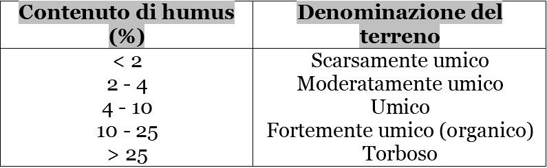

Land denomination
The humus content of a soil it is very variable and largely influenced by climatic, chemical and agronomic factors. These can be for example, the temperature, the pHthe nitrogen content and oxygen, the processing.
The cultivated lands, and which therefore undergo repeated processing, are generally poorer in humus. For this reason, the innovative techniques of organic and conservative agriculture limit the tillage of the land to what is strictly necessary.
The use of the plow, a cornerstone of modern agriculture, is restricted. This is because it is the worst tool for maintaining the humus present in the superficial layers of the soil and therefore the fertility of the same. This is the main reason why, in organic fruit growing, the technique ofgrassing to the continuous processing.
In nature, the richest humus soils are those managed with permanent grass and pasture. But also soils located in humid and cold environments, where mineral decomposition is scarce (mountain forests) are rich in it.
Finally, let’s see in the following table how a soil can be defined based on its humus content.
