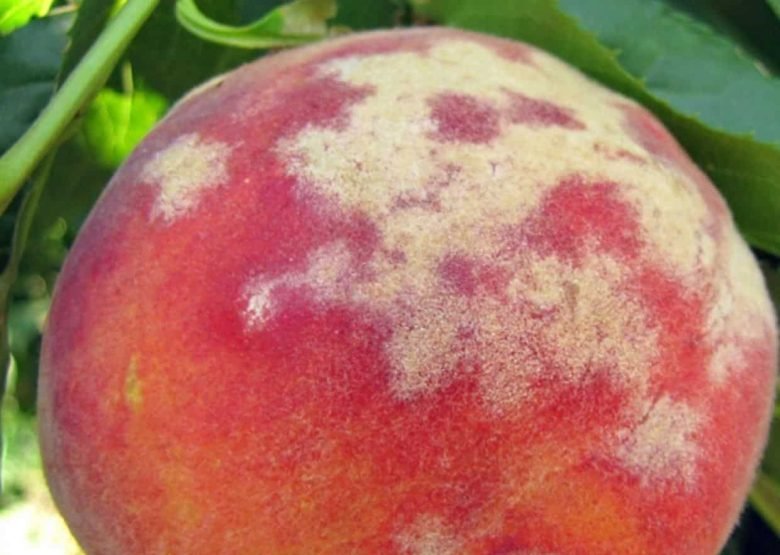

Peach powdery mildew
The powdery mildew of the peach tree (Sphaerotheca pannosa od Oidium leucoconium) is a disease that mainly affects peach orchards in the hills or in central-southern Italy. The first attacks of the disease occur in spring, initially on small fruit, after the pinafore. After a phase of stasis in the hottest and driest months, the disease resumes virulence towards the end of the summer.
On the leaves, the oidium of the peach tree is highlighted at first with discolored areas of irregular shape, then there is the appearance of the typical white mold.
Fruits affected early undergo drop and deformations, with a consequent strong deterioration in quality.
Prevention and defense
The prevention of peach powdery mildew is carried out with sulfur-based products, in particular wettable powders (like these). It intervenes in the period that goes from the phenological phase of the end of flowering, during the pimping and up to the enlargement of the fruit.

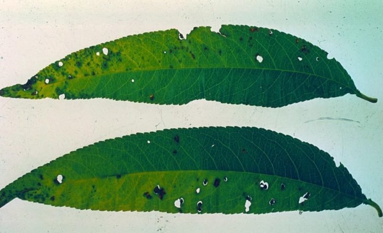

Bacteriosis of the peach tree
Bacteriosis of the peach tree (Xanthomonas campestris or Arboricola, pv. thorns) is also called bacterial blotch and is a disease caused by bacteria. This pathology affects peach trees with high vigor more severely (usually caused by excessive fertilization and large water availability or by grafts on vigorous rootstocks). It affects young shoots, leaves, branches and fruits.
On the affected peaches there are brownish spots of a rounded and depressed shape, accompanied by ulcerative cracks.
The affected leaves fall early, while on the branches the bacterium causes apical desiccation with necrosis of the buds in late spring and late summer.
The penetration of bacteria into the plant tissues is favored by prolonged rains and mild temperatures and occurs through stomata, lenticels and various lesions.
