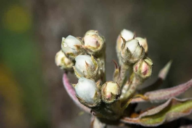

However
Gems
In the pear, the mixed buds have a conical and swollen appearance. They originate a bud and above all a large racemic inflorescence, formed by 7-15 flowers. The flower induction takes place between July and August.
Mixed buds of good quality are found at the apex of the lamburde or also of the brindilli and mixed branches.
Wood gems, on the other hand, are pointed in shape and small in size. They can be provided with two sub-buds that sprout only in case of need, replacing the main bud.

In the pear tree, the mixed branch is provided with vegetative and mixed buds. The mixed buds in the apical position is the one that produces the fruits. There are some in a lateral position which, however, are often not able to produce. The brindillo is provided with vegetative buds along the axis and a mixed apical (and in some cases also lateral) bud.
The lamburda, as in the apple tree, is a very short branching, with a mixed apical bud which, after fruiting, gives rise to a bag to later form the legs of a rooster. In some pear varieties, the rooster’s foot ages quickly, in others it remains productive for many years. The three types of branch therefore have different importance for production purposes according to the variety.
