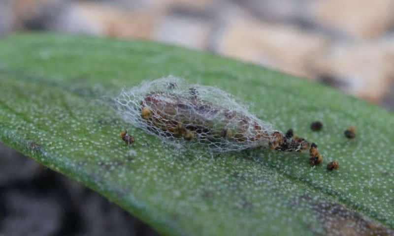

The chrysalis of the moth
Finally, the chrysalises, up to 6 mm long, brown in color and sub-conical in shape.

Chrysalis of Prays oleae
