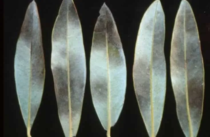

On the foliar apparatus we have several symptoms, different between the lower and the upper page.
- On the lower page you can see irregular spots, from where a thin layer of conidiophores caused by the pathogen comes out. The color becomes gray, hence the vulgar name for plumbing of the olive tree.
- On the upper page, in correspondence with the underlying spots, you will see first yellow spots (chlorosis) and then necrotic. As the disease progresses, in the spring period, the leaves fall off completely.
- On the young branches there may be the presence of irregularly shaped, grayish spots.
