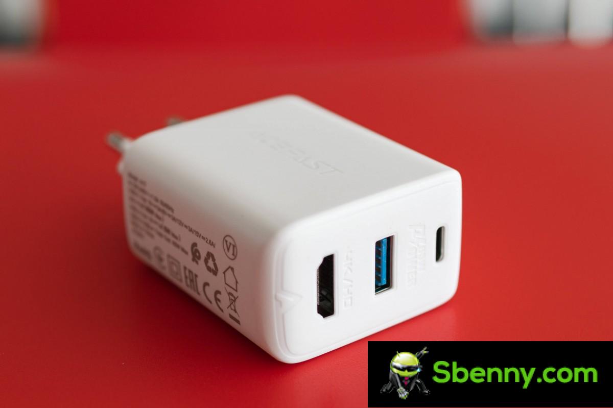

The device is inconspicuously called “Smart Wall Charger-Hub A17 GaN PD65W”. You all know what a wall charger is and we’re sure most of you know what a Type C “hub” style device is. Sure the latter is a broad category, but it’s basically a plug-in device. to a Type-C port and offers more ports and features, usually based on the basic USB spec or something more elaborate like Thunderbolt that might sit behind a Type-C port. Well, the Charger-Hub A17 combines the two into one.

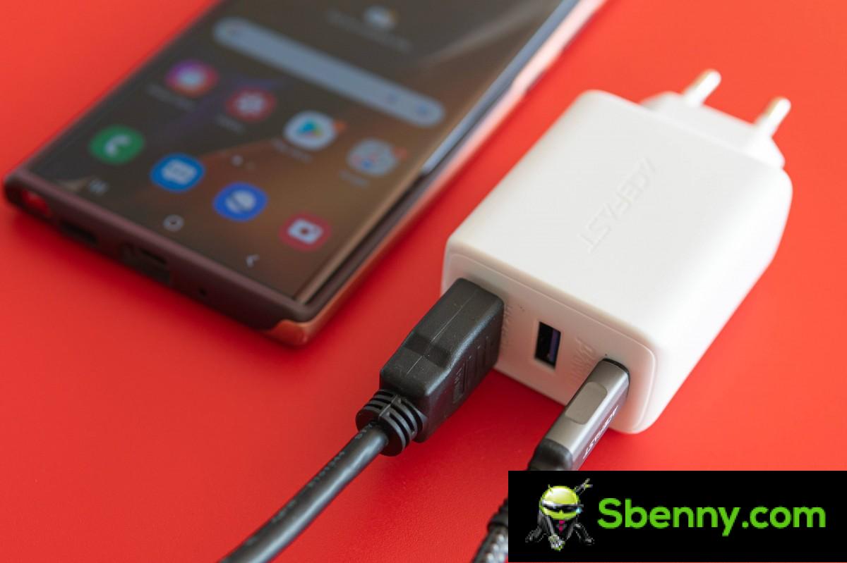

The other potential use case for us is a clean setup. Hubs are great, but the vast majority come with a short male Type-C cable attached, meaning the hub itself is meant to go right next to the laptop, phone, or other device you’re plugging in. With the ACEFAST-Hub A17 charger, you can hide all bulky plugs and cable ends and handle them properly with just one Type-C cable that goes to your device on your desk.

There really isn’t much to the individual parts that make up the Charger-Hub A17 once everything is broken down. There are a total of three ports on it. Type-C is good for up to 60W of power delivery (the 65W value on the packaging is actually cumulative for it and the USB Type A port). It also carries a USB data connection and a video output from the connected device.
The USB Type A port is for connecting a USB device to the host. It is advertised as a UBS 3.1 port, which means very little. The port itself is good for 5W of power and, according to our tests, achieves 10GBps of data throughput, making it a “gen 2” port.
The HDMI port is also not “basic”. It supports up to 4K @ 60Hz output, which makes it HDMI 2.0. It’s great to see as many Type-C hubs out there are limited to 4K @ 30Hz on an HDMI 1.4 port.

We were able to get both video output and a USB connection with the Charger-Hub A17 on a total of three laptops we tested, including Apple’s. We have also had success with some Samsung and Huawei devices with their respective DeX and Desktop Mode implementations. We also got a perfectly stable experience with a Nintendo Switch, which is known to have poor compatibility with some third-party dongles. ACEFAST did their homework in this department. You can find a longer list of devices verified to work with the Charger-Hub A17 on its Amazon listing.
