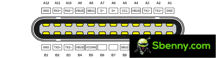

USB was born as a data port. USB 1.0 and 1.1 are slow and barely remembered now, USB 2.0 is still very much alive. USB-C has a total of 24 pins, 12 on each side (well, 22 pins, but let’s not get bogged down in the details). Right in the middle is a single D+/D- pair, which is the data connection of the typical USB 2.0 cable and is mandatory for USB-C. This ensures that all cables have at least some connectivity.
The pinout of a USB Type-C cable
USB 3 added extra pairs of cables for data transfer: there are four extra pairs in a USB-C plug. While USB 2 is limited to 480Mbps, the additional cabling of a USB-C cable allows for transfer speeds of 10, 20, 40, and even 80GBps.
