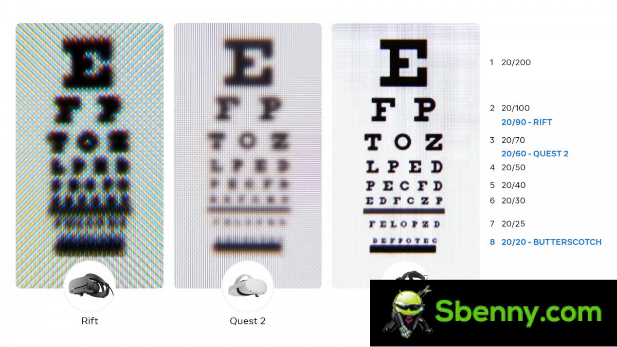

The first prototype is dubbed “Butterscotch” and its goal is to increase the number of pixels to achieve what the team calls “retinal resolution”. That is about 60 pixels per degree. The prototype achieved 55px / deg, using 2.5 times more pixels than the Quest 2 covering only half of the field of view. Either way, the goal is for the display to be sharp enough for users with 20/20 vision to read the smallest letters on an eye test chart.

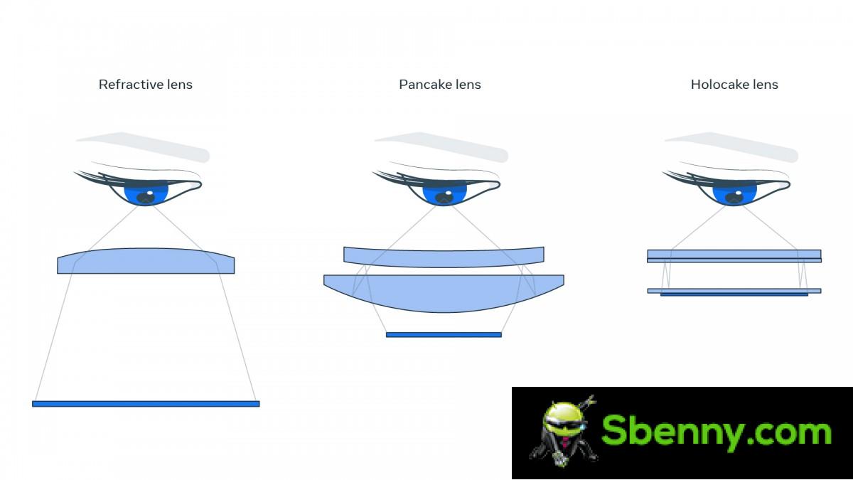

The latest prototype shown is Holocake 2, a working VR headset that can already handle PC VR games. It’s the thinnest and lightest VR headset built by Meta so far, but the dream is to use a holographic lens, which reduces the thickness even more.
