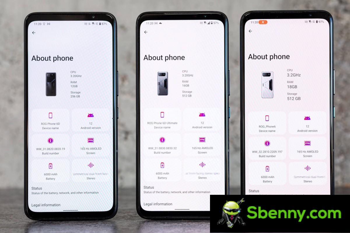

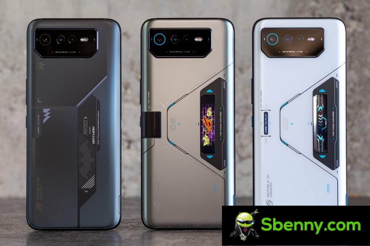

We recently reviewed both the ROG Phone 6 Pro and the ROG Phone 6D Ultimate. As you may already know, the former is based on Qualcomm’s Snapdragon 8+ Gen 1 chipset, while the latter uses an optimized version of MediaTek’s Dimensity 9000+ chipset. The ROG Phone 6D Ultimate also has the unique Asus AeroActive Portal on the back: an active air duct with thin thermal fins and a direct path into the phone’s internal cooling. It’s intriguing hardware we’ve already tested in our 6D Ultimate review.
Today we turn our attention to the vanilla ROG Phone 6D, the non-Ultimate model. Just like its 6D Ultimate sibling, it is based on the Dimensity 9000+ chipset. Unlike him, however, it lacks the AeroActive portal, which means that, at the very least, there are some thermal management differences between the two. Since this and the absence of a ROG Vision display on the back of the ROG Phone 6D are the only differences to note between the vanilla and the Ultimate, we won’t be doing a full review. It would be very redundant, to say the least. What we’ll do, however, is compare the ROG Phone 6D and test its thermal throttling behavior to see how it compares to its sibling, which would answer the question of which ROG Phone 6 is the best performing.
synthetic benchmarks
Before going into reference numbers, some additional information is needed. The ROG Phone 6D unit we have for testing is the Batman Special Edition. Just like his brother Ultimate, he has an essentially overclocked MediaTek Dimensity 9000+ chipset. Users get a single primary Cortex-X2 core, clocked at up to 3.35 GHz instead of the default 3.2 GHz. The three Cortex-A710 cores are also overclocked to 3.20 GHz instead of the default 2.85 GHz. The remaining four “small” Cortex-A510 cores are left at their default 1.8 GHz, which makes sense to see how they are designed for efficiency rather than performance.
In terms of GPU, the ROG Phone 6D and 6D Ultimate are both rocking the Mali-G710 MC10 without mentioning an overclock of any kind. The chipset is paired with 256GB of UFS 3.1 storage and up to 16GB of RAM, which seems odd at first, as ROG Phone 6 Pro offers up to 18GB of RAM. However, ROG Phone 6D and 6D Ultimate use the latest LPDDR5X RAM, which currently only comes in 16GB modules, which explains the decision. Our particular Batman unit, however, is not the top tier model, so it has 12GB of RAM available.
