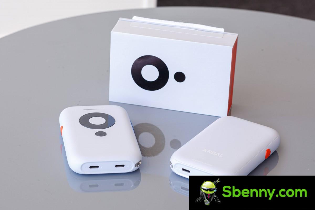

XREAL Beam at a glance:
- Dimensions: 105.8mm x 65.86mm x 18.2mm, 153 grams.
- Interior: 4GB RAM, 32GB ROM.
- Drums: 4870mAh (advertised for up to 3 hours of operation), up to 27W PD charging support.
- I: Two USB Type-C ports (one for XREAL Air goggles and one for DP video and power input), volume rocker on the right side. Display mode switch button on the left side, four-way controls, OK and back button on the front, multicolor LED status indicator strip, power button and fan air outlet on the top.
- Other characteristics:Built-in cooling fan.

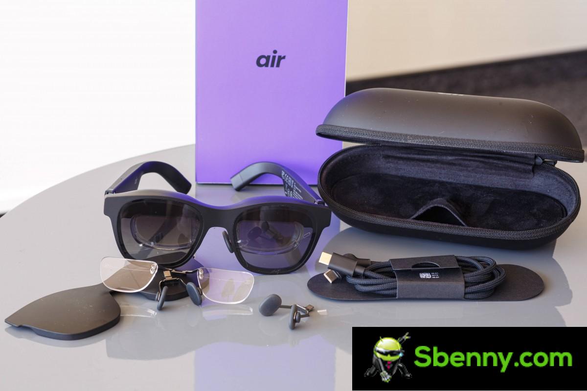

XREAL Air goggles come with a lot of stuff in the box. In addition to the main unit, you get a very sturdy travel case with a zipper, two compartments and a lens protector for the front of the unit.

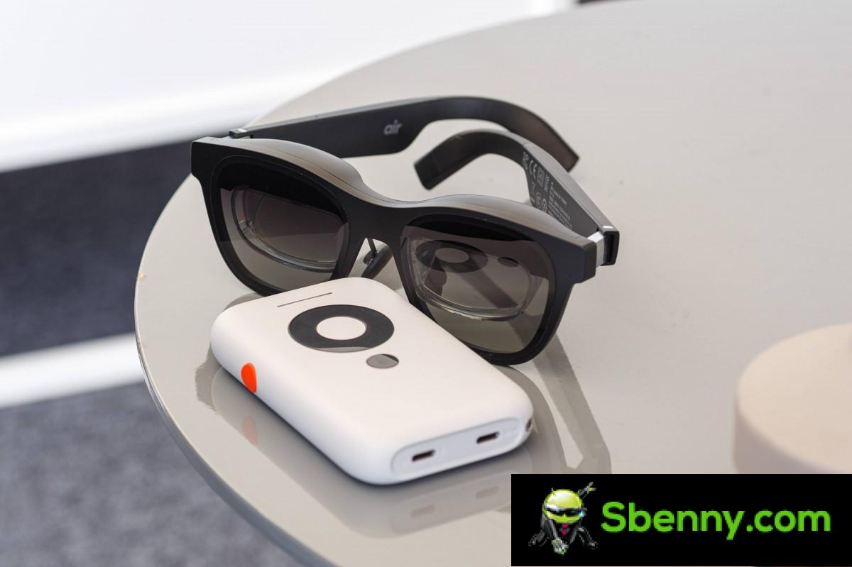

Three different sized nose pads are also included. Swapping them is a very simple process. The same fixing mechanism is also used for the included prescription lens frame. Also in the box is a plastic light shield to place over the glasses, a USB Type-C to Type-C cable, and a cleaning cloth.
The XREAL Beam, for its part, comes in a sturdy two-piece box with virtually no additional accessories inside. There is only the unit itself and some flyers.

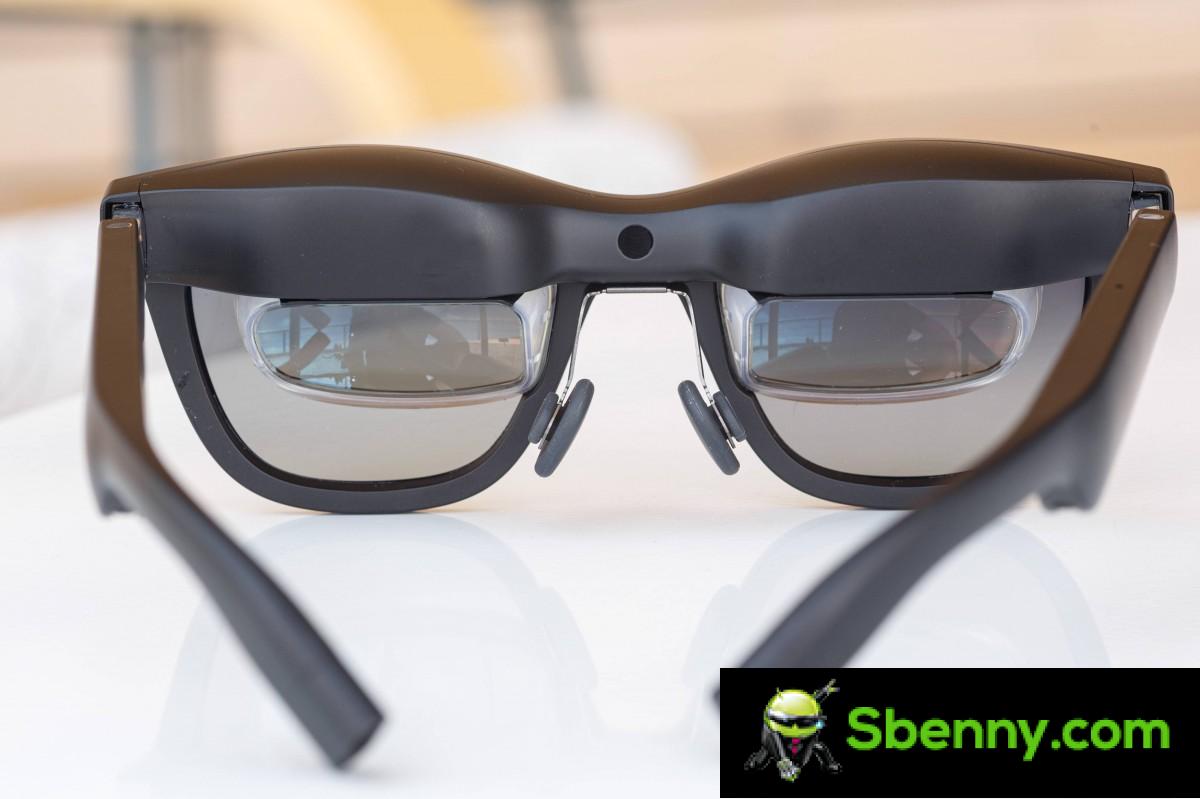

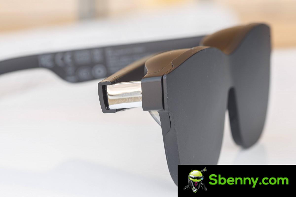

XREAL Air goggles are mostly made of plastic, which certainly contributes to their fairly light weight 79 grams. There really isn’t much hardware inside, other than Sony’s two FullHD OLED displays, a pair of speakers, and a few sensors. There is no battery, computing power or wireless connectivity hardware. All data and power is transmitted through the cable, which is the standard setup for AR glasses nowadays.
All of this also allows the glasses to be quite compact, measuring 148mm x 52mm x 60mm when folded and 148mm x 52mm x 159mm explained. The unit tends to fit snugly on the face, without too much wobbling or play, and it’s not heavy at all. However, it can put uncomfortable pressure on your nose after prolonged use.

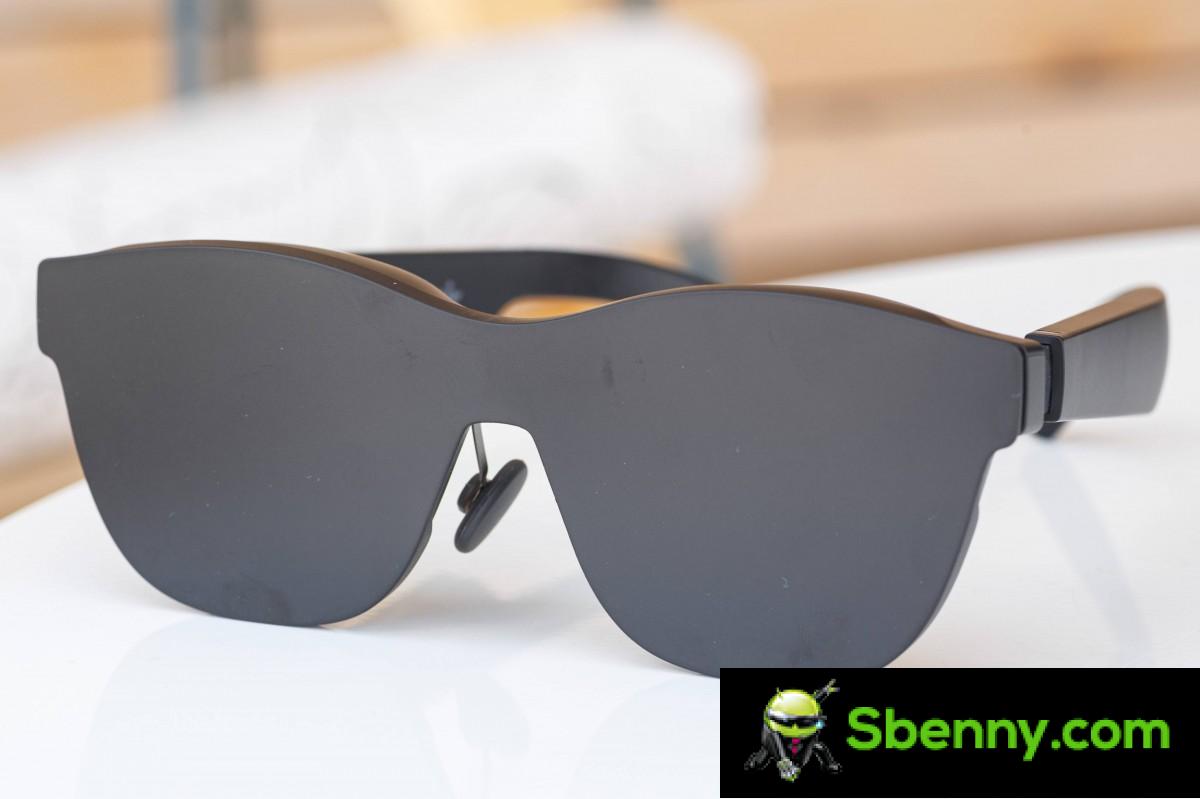

Let’s start our hardware tour from the front. The XREAL Air glasses are absolutely flat on this side and successfully sport a traditional sunglasses look with the lenses flush with the frame. This contrasts with some alternatives, such as the TCL NXTWEAR S glasses, which have a funky front look that immediately reveals their “smart” nature.
Going a little further than the TCL eyewear comparison, unlike the clear front lenses on these, XREAL Air has tinted tints by default. Just like NXTWEAR S, XREAL Air goggles have an optional snap-on attachment with solid shades. They don’t stick with magnets but are friction mounted to the top of the frame and sit very securely.
The lampshade attachments spoil the inconspicuous look of the XREAL Air glasses. It feels weird to wear fully blocked glasses. Then again, all it takes is a quick second glance and spotting the USB cable dangling from your ear to realize that something strange is going on, so you can’t realistically expect to go into “stealth mode” with glasses on.

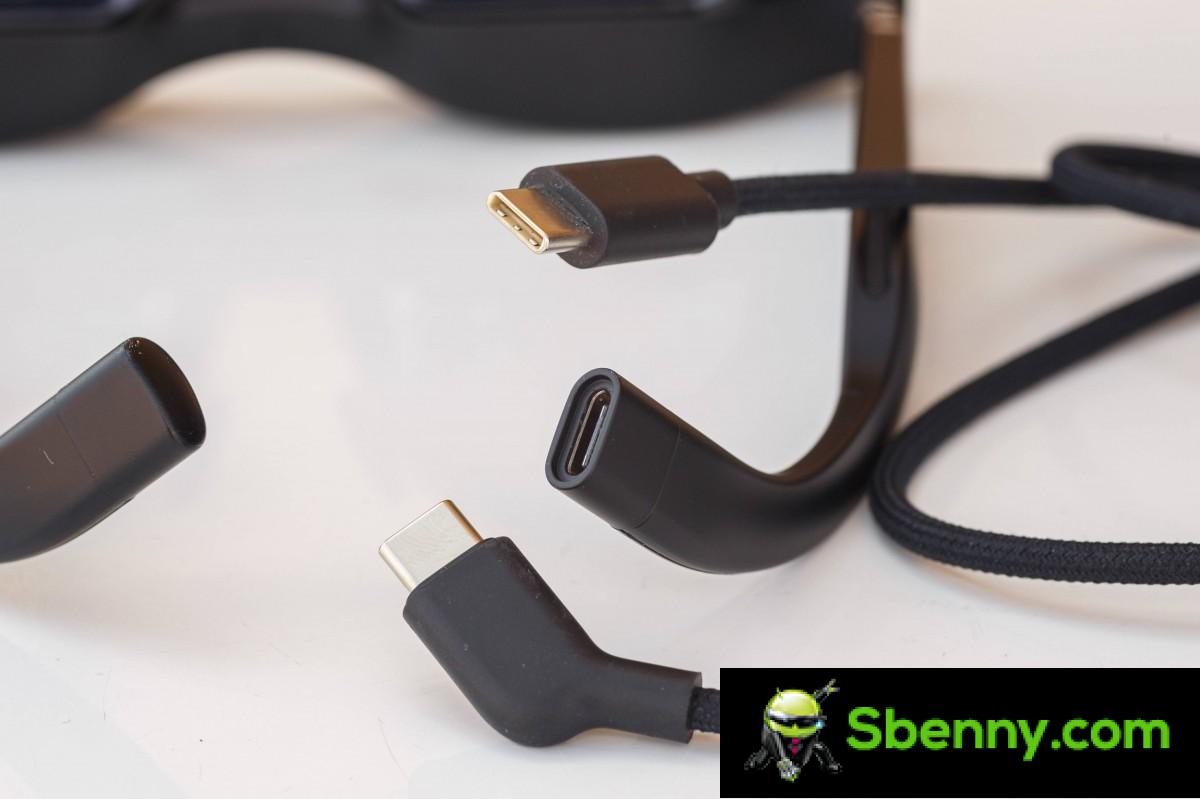

After all, the cable will always be plugged into the XREAL Air since it’s the only power and video source for the goggles. There’s a braided USB Type-C to Type-C cable, angled on one end to fit more snugly over the glasses that come in the box. You can use any of your own decent enough cables, but the one provided is pretty great. It is soft and flexible, yet very sturdy. It’s not too often either. We never found it in the way while wearing the goggles.
On the one hand, we like the Type-C connector with its strong physical connection. There’s virtually no chance of accidentally yanking the cable out of your goggles. However, that also means that if you happen to get caught, chances are you’ll knock your glasses off your face. The magnetic connector on the NXTWEAR S goggles is better in this regard.
As far as cable length goes, we’ve never needed more than we have. It’s long enough to be comfortable while sitting in front of a device or holding it on your lap, and it also fits nicely into most pant pockets if you really feel like walking around with glasses on, which is admittedly weird but it can be taken out.

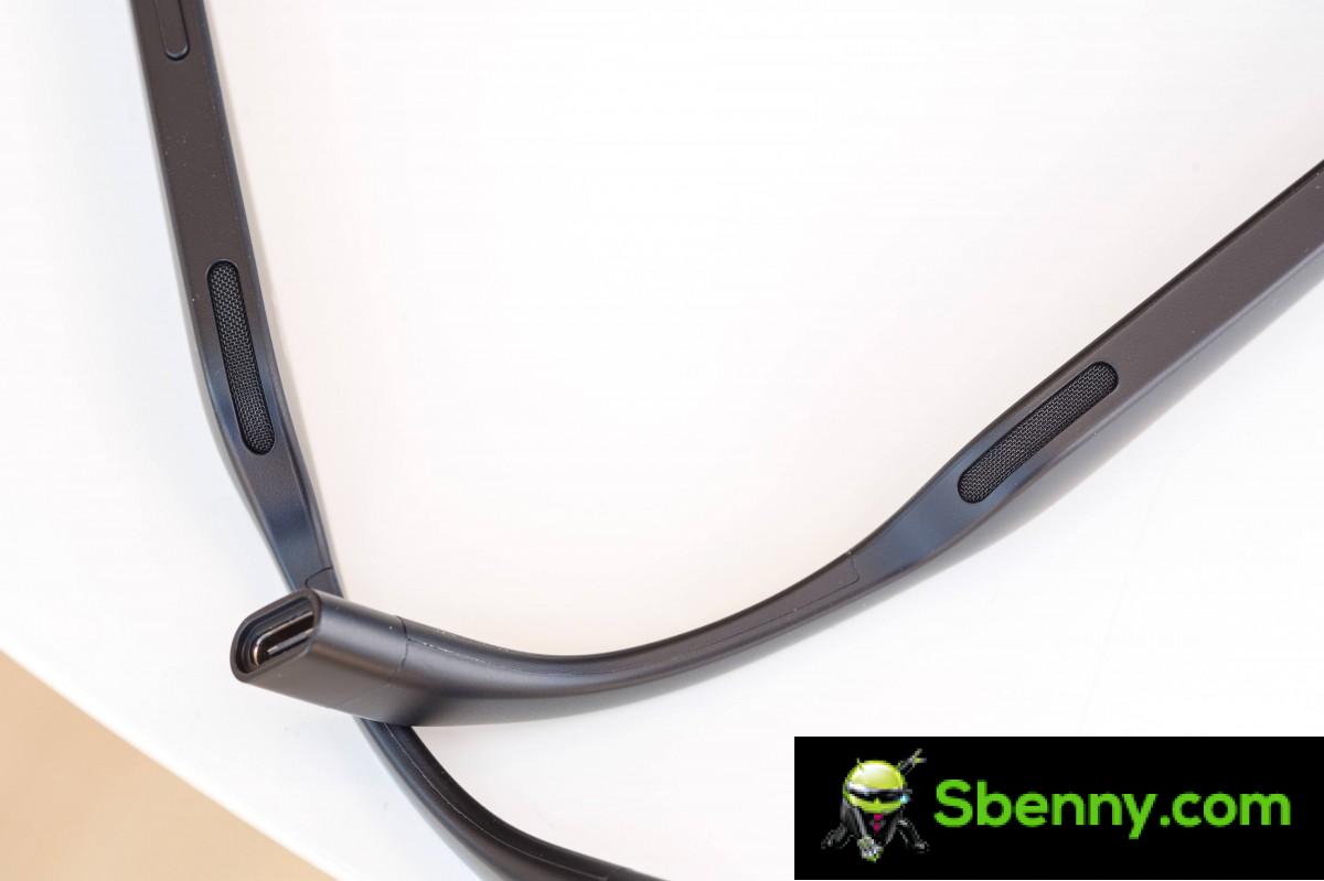

Let’s talk about the speakers for a moment. The XREAL Air has a pair, one on each arm. They are conventional compared to bone conduction units, which are sometimes included in wearable technology. The speakers actually have grilles pointing down towards your ears, which makes sense.
In practice, the speakers sound good, but only as good as can be expected from small units positioned a bit away from the ears. The output is relatively clean, with nice highs and mids and clean vocals. There’s absolutely no bass and it’s not particularly loud, which may have been a necessary trade-off to ensure minimal noise leakage. In practice, even at full range, the neighboring parties, even those sitting next to us, heard nothing, which is impressive.

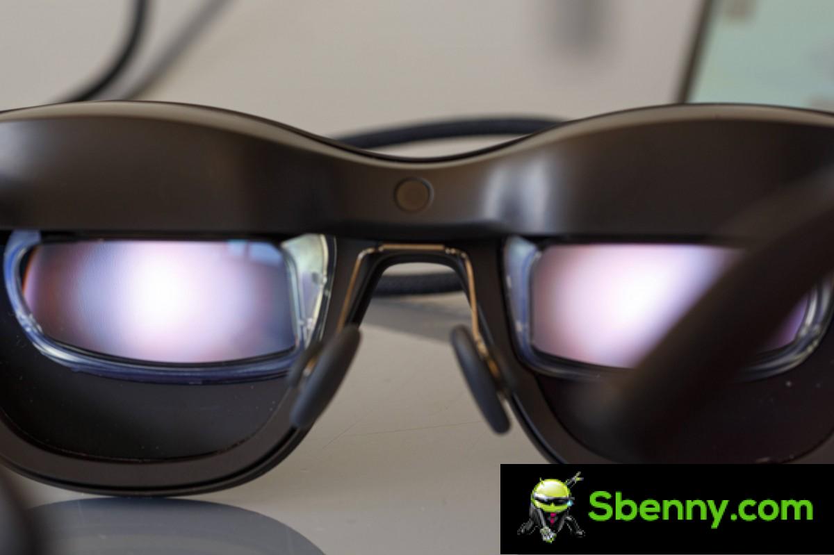

XREAL Air goggles have a fantastic extra feature: a wear sensor. It’s positioned in the center of the glasses, just above the nose pads, and appears to be a simple proximity-based unit. Works great and turns the glasses off seconds after you take them off and turns them back on almost instantly once you put them back on.

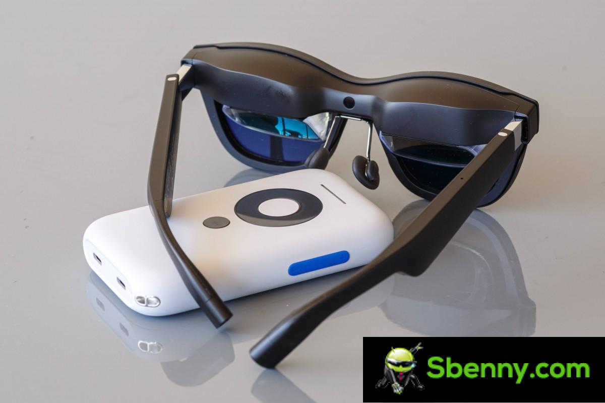

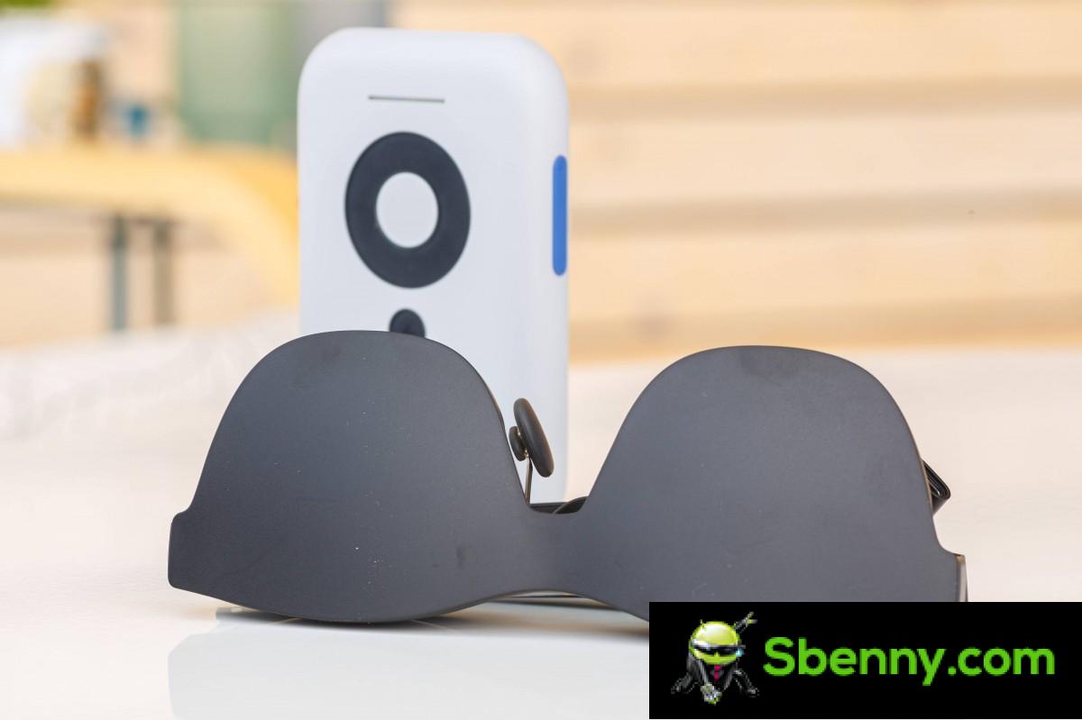

The XREAL Beam is a cute looking gray device about the size of a compact power bank 105.8mm x 65.86mm x 18.2mm AND 153 grams. Most of that weight is probably the 4870mAh battery, which according to XREAL is good for everything 3.5 hours of operation. The small device also has some computing power on board, enough to need active cooling, provided by a built-in fan, which is sometimes audible, but never distracting or intrusive. It’s not that the beam is expected to reside near your ears anyway.

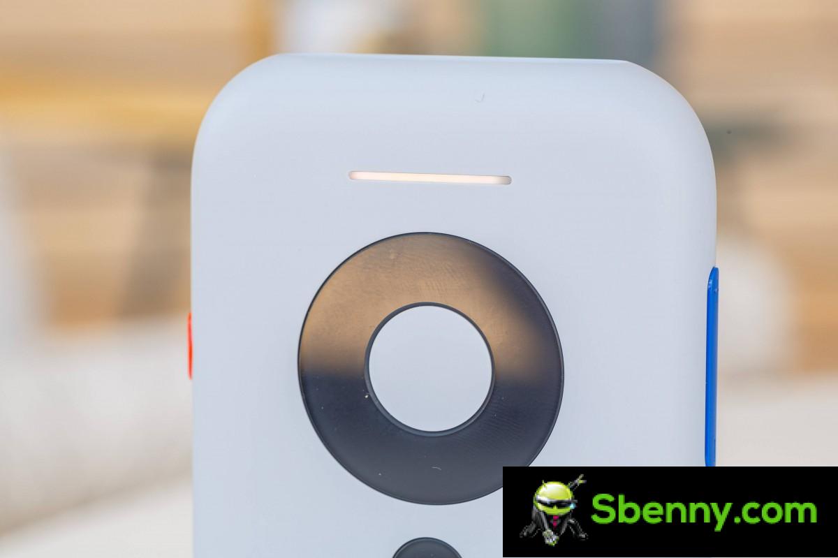

There are a surprising number of controls and I/O on the Beam. First, two USB Type-C ports are at the bottom. One is meant exclusively for connecting Xreal Air glasses, while the other can receive video input via Type-C and power. The beam can charge up to 27W via PD, it can run while it’s charging and should go from dead to 50% in about 30 minutes. In the next section of the review, we’ll talk at length about the Beam’s connectivity support, both wired and wireless.
In terms of controls, the Beam has an iPod-inspired D-pad on the front along with back and OK buttons. There’s a volume switch on the right side and a “mode dial” button on the left side. A hidden button on the top controls power up, but the device also turns on automatically when you connect it to XREAL Air goggles. A multicolor status LED strip on the front shows the current battery level.

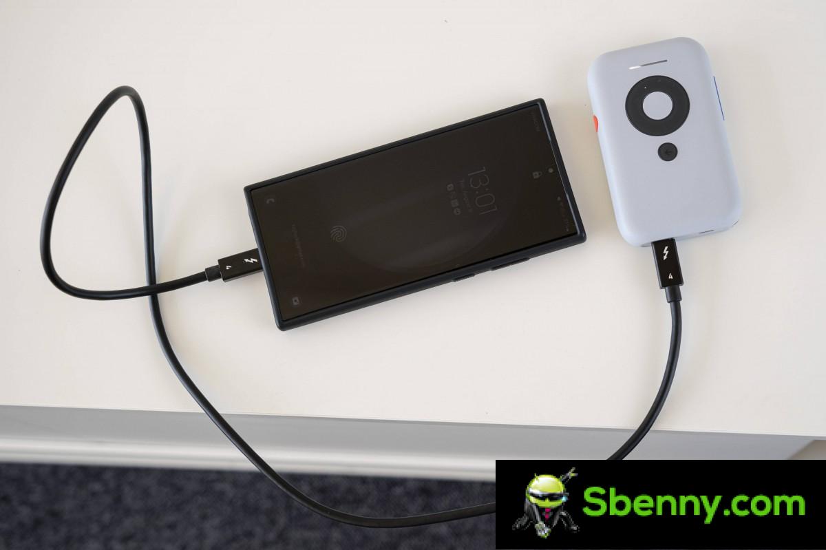

And then there’s XREAL Beam. Its main function is to provide wireless transmission capabilities to XREAL Air goggles. In fact, we tried both Miracast on a supported Android device and AirPlay on an Apple iPhone, and both worked fine. Wired connectivity support on the Beam also appears to build on regular Air support.
From our tests, it appears that the Beam accepts Display Port (DP) over Type-C, just like the glasses do without any limitations. We can also confirm that, unlike the glasses themselves, the Beam supports direct connection to the Nintendo Switch. As for the other advertised game consoles, such as the Xbox and Play Station models from the Beam support list, these require the use of a very strange HDMI to Display Port (DP) and USB Type H cable. We grabbed one straight from XREAL for testing, but don’t believe it comes in the box with the Beam. Be prepared to grab one in case you want to connect an HDMI source to the XREAL Beam.
