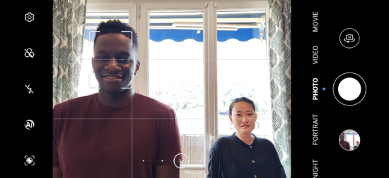

Preview tests analyze the image quality of the camera app’s preview of the image, with particular attention paid to the difference between the capture and the preview, especially regarding dynamic range and the application of the bokeh effect. Also evaluated is the smoothness of the exposure, color and focus adaptation when zooming from the minimal to the maximal zoom factor available. The preview frame rate is measured using the LED Universal Timer.
The Honor’s preview image shows some differences to the final capture. Dynamic range of the preview is much more limited than in capture, with higher levels of highlight clipping. Target exposure is usually quite close between preview and capture, and in bokeh scenes, the blur effect is properly applied to the preview image. Blur intensity is a little lower than in capture.
Honor Magic4 Ultimate, preview: stronger highlight clipping than capture, similar face exposure
