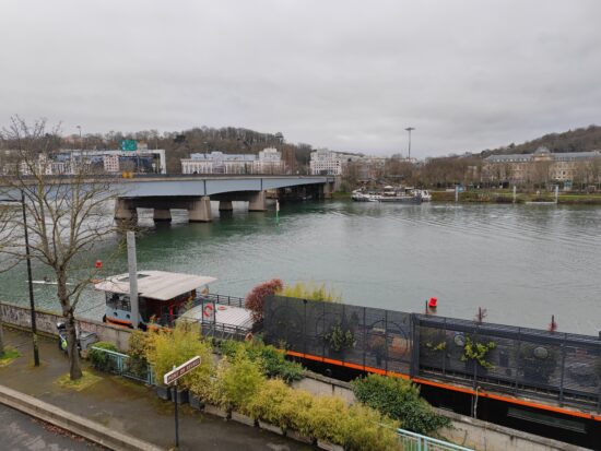

This Honor Magic4 Ultimate picture has a wide dynamic range, nice color, and contrast as well very high levels of detail and very low noise.

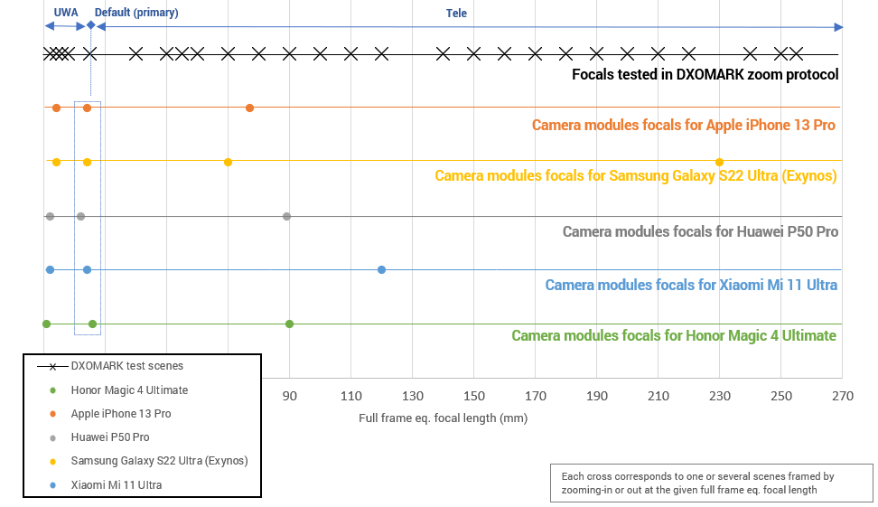

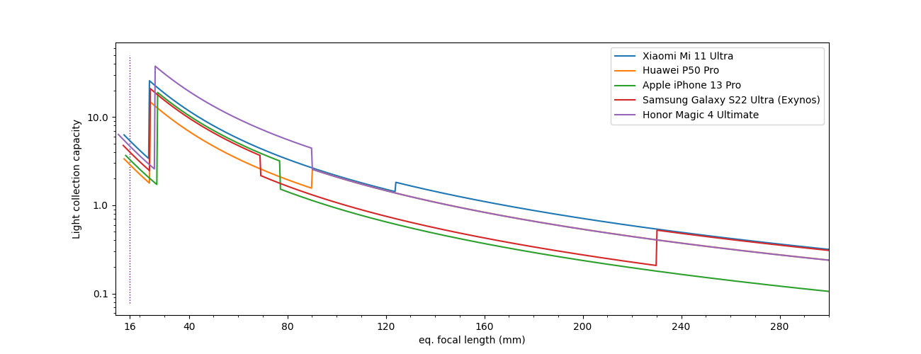

The Honor is also one of the best phones we have tested to date for zooming in or out. With its 11mm equivalent ultra-wide camera, it offers the widest field of view of any camera we have tested to date. Despite the wide lens, distortion and anamorphosis are well under control, making the device a good pick for wide-angle portraits. In addition, the camera captures better detail than the competition at 16mm, which is the default ultra-wide setting. This is achieved by fusing image data from the ultra-wide and primary cameras. On the downside, some fusion artifacts in the shape of a local loss of detail can sometimes become noticeable. But target exposure and color rendering are usually accurate. White balance is pleasant in all conditions.
The Honor Magic4 Ultimate is also outstanding for tele zooming, thanks to the combination of a 64MP 90mm equivalent tele module with a number of image fusion solutions that result in excellent detail and a wide dynamic range at all tele zoom settings. At close range, levels of detail are high and on par with the direct rivals, while capturing a lot of dynamic range. The high levels of detail are likely explained by AI fusion algorithms that improve fine detail in the most important areas of the frame. But this technology comes at a cost because a variation in the level of captured detail is often noticeable across the frame.
Medium range (approximately 3.5x) is where the Honor Magic4 Ultimate really shines. Detail is very high compared to the direct competition. Dynamic range is wide, and color rendering and target exposure are pleasant in all tested conditions, including low light.
Comparison: Focal lengths of flagship phone camera modules

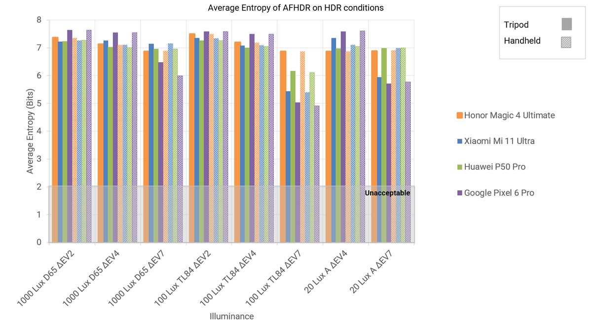

In these tests, we analyze target exposure, contrast, and dynamic range, including repeatability across a series of images. Tests are undertaken in a wide range of light conditions, including backlit scenes and low light down to 1 lux. The score is derived from a number of objective measurements in the lab and perceptual analysis of real-life images.
The Honor Magic4 Ultimate delivers very high contrast entropy values in all test conditions. Contrast entropy is a measurement of the quantity of information (in terms of levels of gray) contained in a given part of the scene. When shooting handheld, the Honor usually manages to capture more information in areas near saturation than its rivals. Performance is consistent across all conditions, even where the comparison cameras struggle, for example, 100 lux TL84 with a brightness difference of EV7.
This graph shows the average entropy for multiple HDR lighting conditions. Contrast entropy (measured in bits) is a measure of dynamic range and is computed on the gray patches on the HDR charts within the autofocus HDR setup. A value lower than 2 is unacceptable.

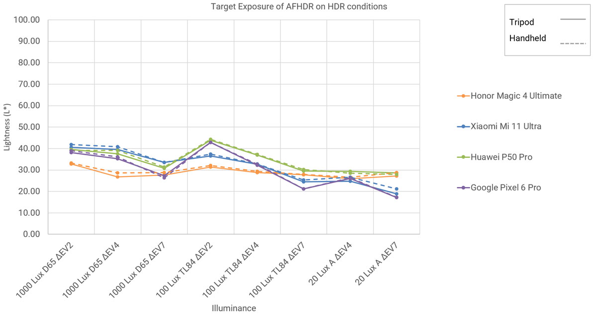

Some cameras have a tendency to slightly underexpose in order to protect the highlights in an image. This is not the case for the Honor, which delivers consistent target exposure and high entropy values at the same time. This is true even for difficult high-contrast and low-light conditions.
This graph shows the lightness of the 18% patch of the deadleaves chart in the autofocus HDR setup SBMARK AFHDR setup for multiple HDR lighting conditions.

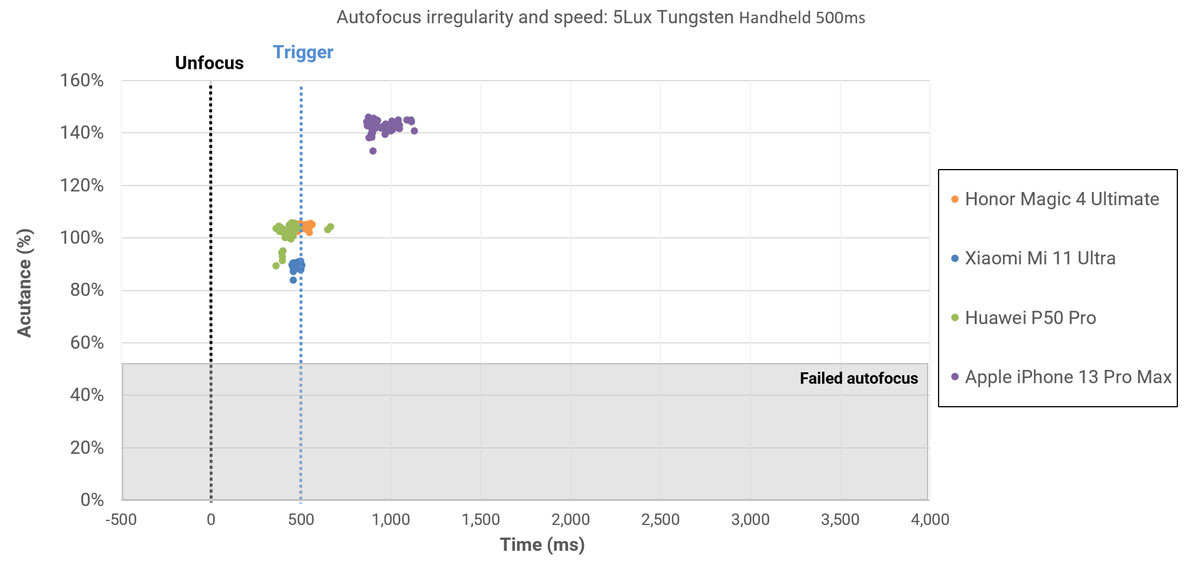

In these tests, we analyze autofocus accuracy and shooting time, including repeatability, in the lab. We test focus failures, depth of field, and tracking of moving subjects using perceptual analysis of real-life images.
The Honor Magic4 Ultimate uses Zero Shutter Lag (ZSL) technology, which allows for image capture exactly at the same time the shutter is triggered, without any delay. To achieve this, images are continuously buffered while the camera app is open. The autofocus is very consistent in all conditions. This graph shows autofocus-reaction performance in challenging low light. The closer together the points are, the more stable the autofocus. The farther apart the points are from one another indicates autofocus instability. The Honor does very well, with a short focus delay and high acutance in all shots. The comparison devices are a little more unstable in terms of both delay (Huawei P50 Pro) and acutance (Xiaomi Mi 11 Ultra).
This graph plots edge acutance Cons shooting time measured on the AFHDR set up on a series of pictures. All pictures are taken at 5 lux with tungsten illuminant, handheld, 500ms after the target is defocused. Edge acutance is measured on the four edges of the deadleaves, shooting time is measured on an LED Universal Timer.

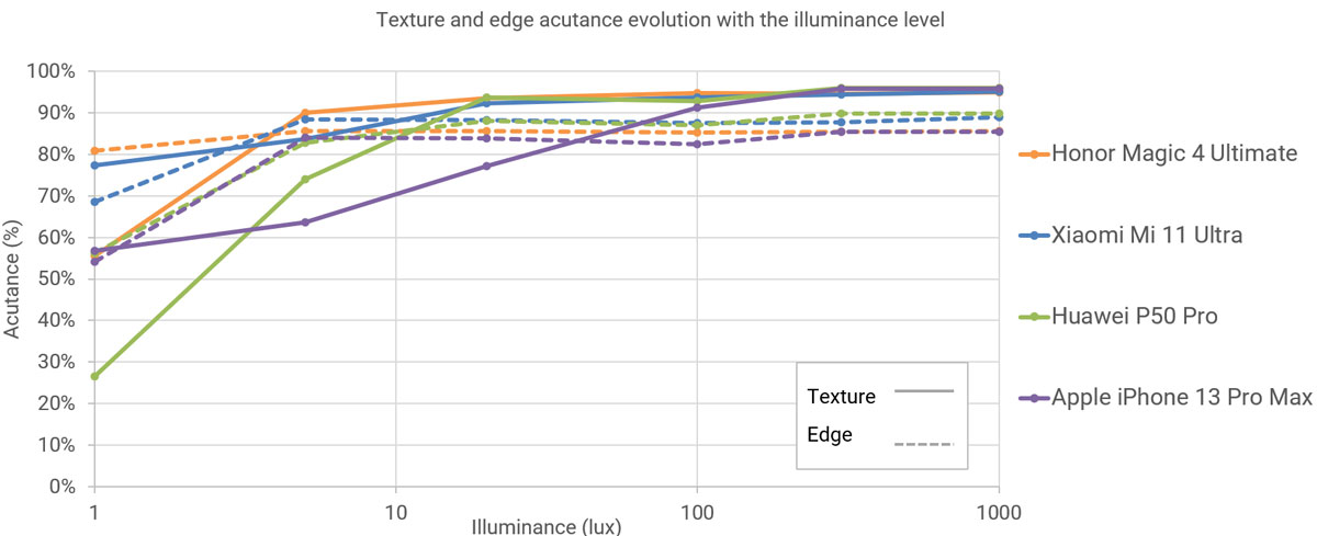

In these tests we analyze texture on faces and objects, including objects in motion, in a range of light conditions, using several lab test setups and perceptual analysis of real-life images.
The Magic4 Ultimate captures high levels of detail in all conditions compared to its rivals, especially when shooting handheld in low light. Results are quite similar between handheld and tripod-based shooting. On the comparison devices, the differences are more pronounced.
This graph shows DMC detail preservation Cons the light level (in lux) for handheld and tripod-mounted shooting.
DMC detail preservation metric is an AI-based texture analysis trained on three selected crops of our SBMARK chart. The closer the value is to 100, the higher is detail preservation.

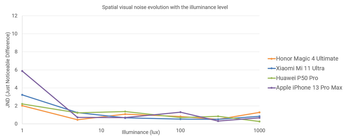

In these tests, we analyze noise on faces and objects, including objects in motion, in a range of light conditions, using several lab test setups and perceptual analysis of real-life images.
The Honor camera usually keeps image noise very well under control and overall the Magic4 Ultimate’s performance is close to its flagship rivals and better than the iPhone 13 Pro Max in all conditions.
This graph shows visual noise Cons the light level (in lux) when the camera is handheld. The visual noise metric is the mean of visual noise measurement on all patches of the deadleaves chart in the AFHDR setup.
Noise levels are very low, even in high-contrast conditions. In this low light scene (5 lux), hardly any noise is visible.

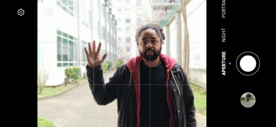

The Honor’s preview image shows some differences to the final capture. Dynamic range of the preview is much more limited than in capture, with higher levels of highlight clipping. Target exposure is usually quite close between preview and capture, and in bokeh scenes, the blur effect is properly applied to the preview image. Blur intensity is a little lower than in capture.
Honor Magic4 Ultimate, preview: visible difference to capture in terms of highlight clipping; bokeh simulation is well done in preview, but blur is slightly lower than on capture.

In these tests, we analyze all image quality attributes at focal lengths from approximately 40 to 300 mm, paying particular attention to texture and detail. The score is derived from a number of objective measurements in the lab and perceptual analysis of real-life images.
The graph below shows the light collection capability of several devices across all equivalent focal lengths. Light collection is an estimation of the amount of light that the sensor can capture in a single exposure. It is defined as follows, with S being the effective area of the sensor and Fn the aperture. The higher the value, the higher the number of photons that arrive at the sensor.
We see decreasing curves in the graph because as we frame to a given field of view (or equivalent focal length), the effective sensor areas decrease. The vertical purple dotted line marks the default focal length of the Honor’s ultra-wide camera. The graph shows that, at least on paper, the Honor Magic4 Ultimate is capable of capturing more light than its competitors in a single exposure of the primary sensor. At ultra-wide and long tele settings only the Xiaomi Mi 11 Ultra collects more photons. Please also note that the Honor Magic4 Ultimate offers an up to 100x digital zoom option for those really long tele shots.
Comparison: light collection capability across focal lengths

In the lab, the Honor achieves a high level for both texture and edge acutance. In this graph, you can see that in most conditions, texture acutance is on a similar level as on the flagship rivals.
This graph shows texture and edge acutance Cons light level (in lux). Texture and edge acutance are measured on the deadleaves chart in SBMARK’s video deadleaves setup.
In bright outdoor light, fine detail is rendered pretty well. Detail preservation is slightly better than on the Huawei P50 Pro but not quite as good as the Xiaomi Mi 11 Ultra.

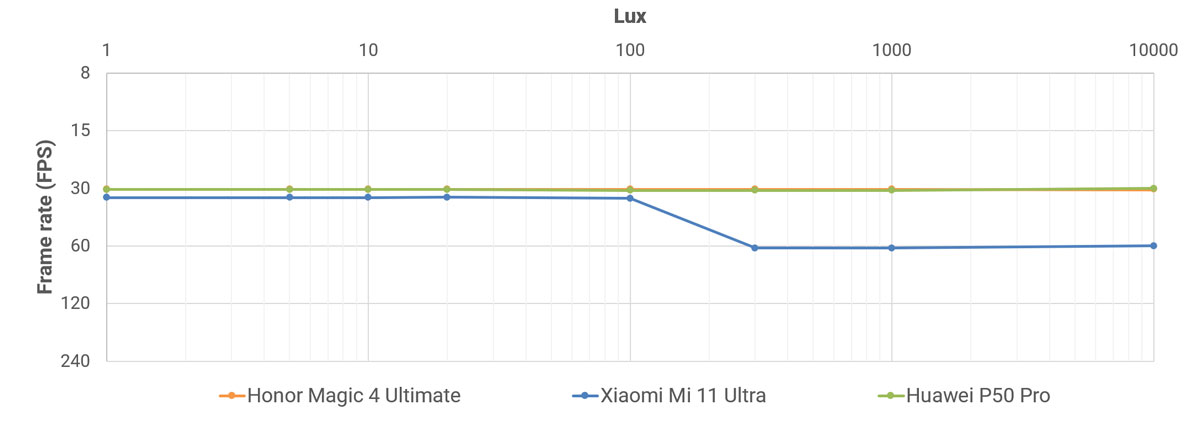

For video artifacts, we check for the same kinds of artifacts mentioned in the Photo section, along with such video-specific artifacts as frame rate variation in different light conditions, judder effect, and moving artifacts (artifacts such as aliasing, color quantization, and flare can often be more intrusive when moving than in a still image).
The Honor Magic4 Ultimate does not feature adaptive frame rates and records video at 30 frames per second in all light conditions. As a result, a judder effect can be noticeable when panning the camera. In contrast, the Xiaomi Mi 11 Ultra increases the frame rate to 60 frames per second in indoor and bright outdoor conditions in order to reduce judder.
This graph shows video frame rates Cons light level (in lux).
