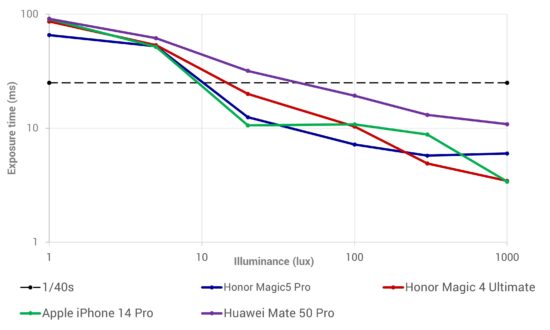

Motion blur was fairly well under control, thanks to pretty fast shutter speeds in daylight and indoor conditions. As a result, the Honor was capable of freezing subjects in motion, as long as the autofocus worked well and zero shutter lag kicked in.
Exposure time (ms) measured was very low for indoor and outdoor conditions (lower is better).

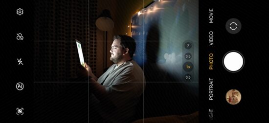

Preview
74
Apple iPhone 14 Pro Max

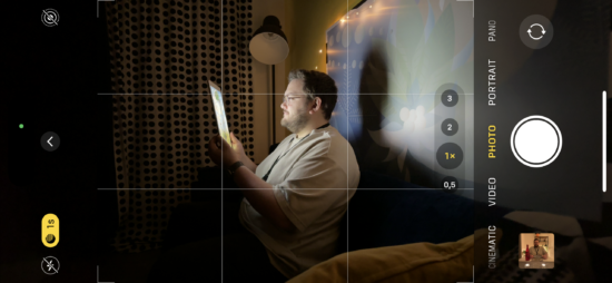

Preview tests analyze the image quality of the camera app’s preview of the image, with particular attention paid to the difference between the capture and the preview, especially regarding dynamic range and the application of the bokeh effect. Also evaluated is the smoothness of the exposure, color and focus adaptation when zooming from the minimal to the maximal zoom factor available. The preview frame rate is measured using the LED Universal Timer.
Preview was good but not on par with the latest iPhone devices. When capturing high-contrast scenes, the iPhone preview image was much closer to the final capture in terms of dynamic range, but the Honor was on the same level as other top-end Snapdragon-powered devices. The Honor also applied a bokeh effect to its preview image when shooting in bokeh mode, but the differences to the capture were quite noticeable.
Honor Magic5 Pro – capture – wide dynamic range
Honor Magic5 Pro – preview – noticeably reduced dynamic range, darker exposure
Apple iPhone 14 Pro – capture – good target exposure, slight highlight clipping
Apple iPhone 14 Pro – preview – very similar to capture
