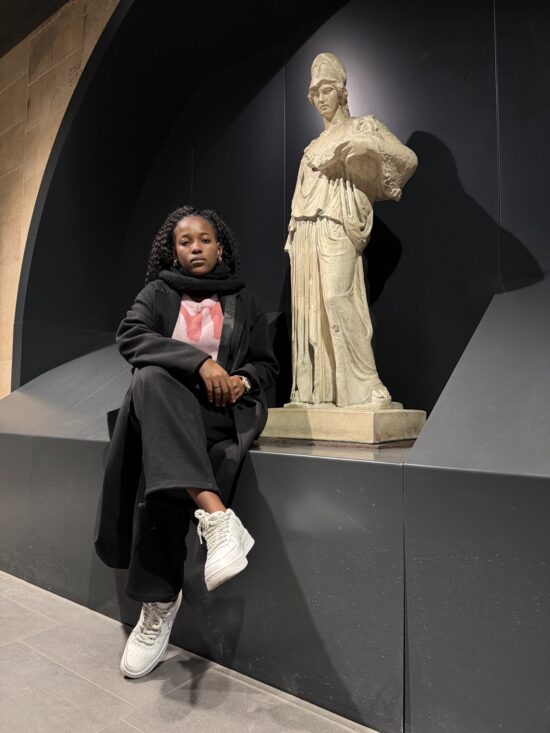

  • Accurate exposure and wide dynamic range in photo and video
  • Neutral white balance and nice color in photo and video
  • Very good photos in very low light
  • Good depth estimation and nice skin tones in portrait mode
  • Fairly high levels of photo and video detail in most conditions
  • Very low image noise in photos

Thanks to a very decent and well balanced performance in the SBMARK Camera tests, the Motorola Signature earns itself a spot in the top ten of our ranking and shows that good image quality and camera performance are not incompatible with a very thin smartphone body.
In photo mode the Motorola Signature camera captures very pleasant images with good exposure and a wide dynamic range. White balance is generally neutral, resulting in nice and natural colors. When shooting with the primary camera module, the Motorola maintains an excellent trade-off between detail retention and noise reduction, resulting in clean, noise-free images with high levels of detail. In addition, a face detail recovery algorithm improves detail on background faces in group portrait shots. Overall, image quality is very good across all light levels, from daylight snapping down to very low light scenes. Even night shots are nicely rendered. When taking simulated bokeh pictures in portrait mode, subjects are isolated from the background with great precision.

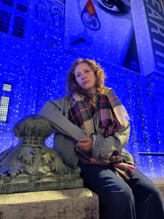

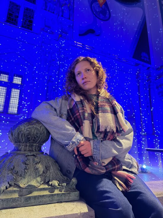

In very low light, the Motorola Signature offers a very good photo performance. Subjects are nicely exposed and images show a good dynamic range. Colors are nice, with a neutral white balance. Image processing maintains a good compromise between texture retention and noise reduction, resulting in good detail and very low noise levels.
In video mode the Motorola Signature produces low light clips with good exposure and nice colors. Video noise reduction works quite well but a loss of fine detail is noticeable. Our testers also observed some exposure and/or noise reduction instabilities.
Motorola Signature – Good exposure and color rendering
Apple iPhone 17 Pro – Good exposure, color quantization on the wall
Vivo X300 Pro – Good exposure, color quantization on the wall

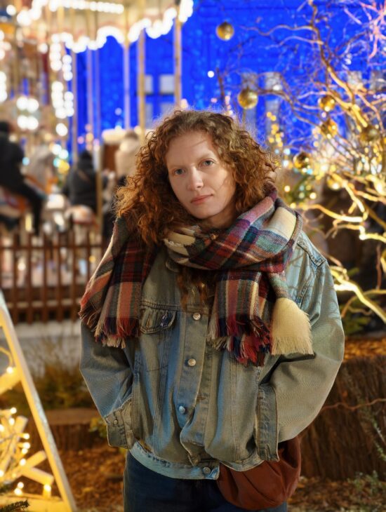

The Motorola Signature offers a very good portrait mode that uses the tele module and its equivalent focal length of 85mm. Subjects are nicely isolated from the background, thanks to good depth estimation across all light conditions. Skin tones are accurate, subject exposure is accurate and fine detail is preserved well.
Motorola Signature – 85mm equivalent focal length makes framing easier, very good depth estimation
Apple iPhone 17 Pro – Shorter equivalent focal length results in less ideal portrait framing, very good depth estimation
Vivo X300 Pro – Nice exposure and color, 85mm equivalent focal length makes framing easier, very good depth estimation

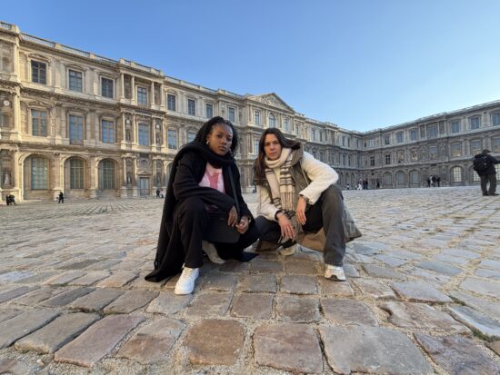

With a 13mm equivalent focal length, the Motorola Signature’s ultra-wide camera offers a wide field of view. Ultra-wide images are good, with accurate white balance and good subject exposure. Detail is nicely preserved while noise levels are kept very low, especially when shooting in daylight.

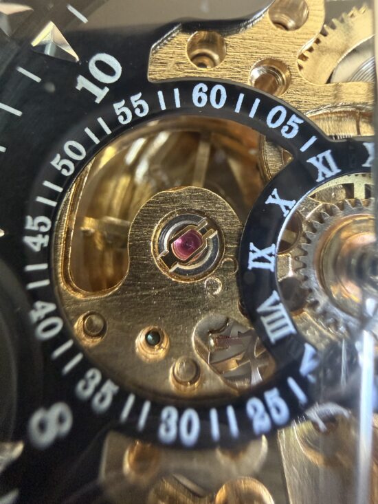

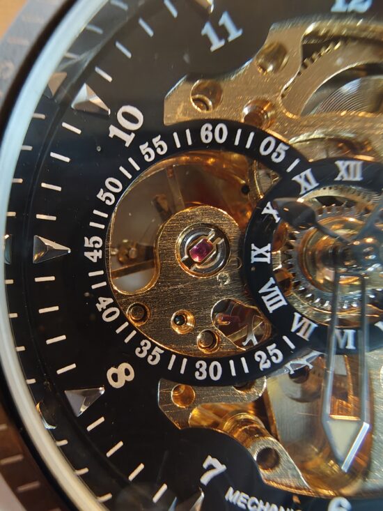

Close-Up
The Motorola Signature switches automatically to macro mode, which uses the ultra-wide camera module, when getting close to a subject. In this mode the camera manages to capture good detail at the center of the frame, but a loss of detail is noticeable closer to the edges. Exposure and color are good.
Motorola Signature – Very good detail at the center of the frame, loss of detail at the edges
Apple iPhone 17 Pro – Good detail at the center of the frame, loss of sharpness at the edges
Vivo X300 Pro – Very good detail

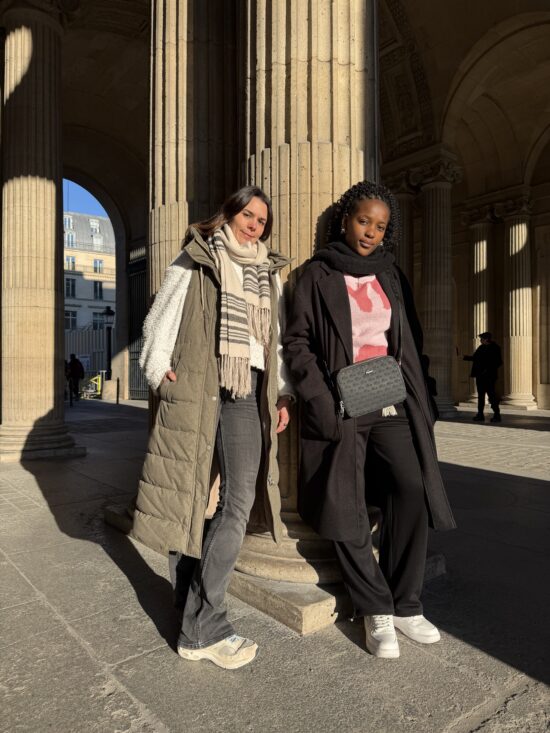

Color is one of the key attributes for technically good pictures. The image quality attributes analyzed are skin-tone rendering, white balance, color shading, and repeatability. For color and skin tone rendering, we penalize unnatural colors according to results gathered in various studies and consumer insights while respecting the manufacturer’s choice of color signature.
Motorola Signature images offer a neutral white balance across all light conditions, making for pleasantly natural skin tones in portrait shots.
Motorola Signature – Nice colors, natural skin tones and neutral white balance
Apple iPhone 17 Pro – Very slight yellow cast
Vivo X300 Pro – Neutral white balance

The Motorola Signature’s ultra-wide camera module offers a very wide 13mm equivalent focal length. Like on the primary module, exposure is good and colors are nice. Some slight color fringing can sometimes be noticeable, though.

Motorola Signature – Wide field of view with good exposure and nice colors
