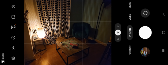

The preview tests analyze the image quality of the camera app image preview, with particular attention to the difference between capture and preview, especially with regards to dynamic range and application of the bokeh effect. The smoothness of exposure, color and focus adaptation are also evaluated when zooming from the minimum to the maximum available zoom factor. The preview frame rate is measured using the Universal Timer LED.
Samsung Galaxy Z Fold4, preview –
clipping of visible lights and shadows
Samsung Galaxy Z Fold4, capture –
good retention of light and shadow
