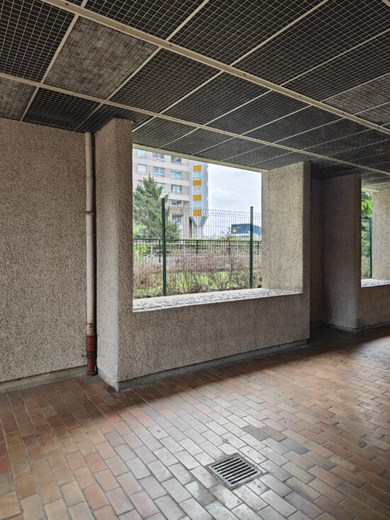

Exposure is one of the key attributes for technically good pictures. The main attribute evaluated is the brightness of the main subject through various use cases such as landscape, portrait, or still life. Other factors evaluated are the contrast and the dynamic range, eg. the ability to render visible details in both bright and dark areas of the image. Repeatability is also important because it demonstrates the camera’s ability to provide the same rendering when shooting several images of the same scene.
The Xiaomi 13 Ultra achieved one of the best results for dynamic range to date, but it did not quite match the class-leader Huawei P60 Pro. Face exposure was generally spot on most of the time, even in backlit scenes with challenging lighting.

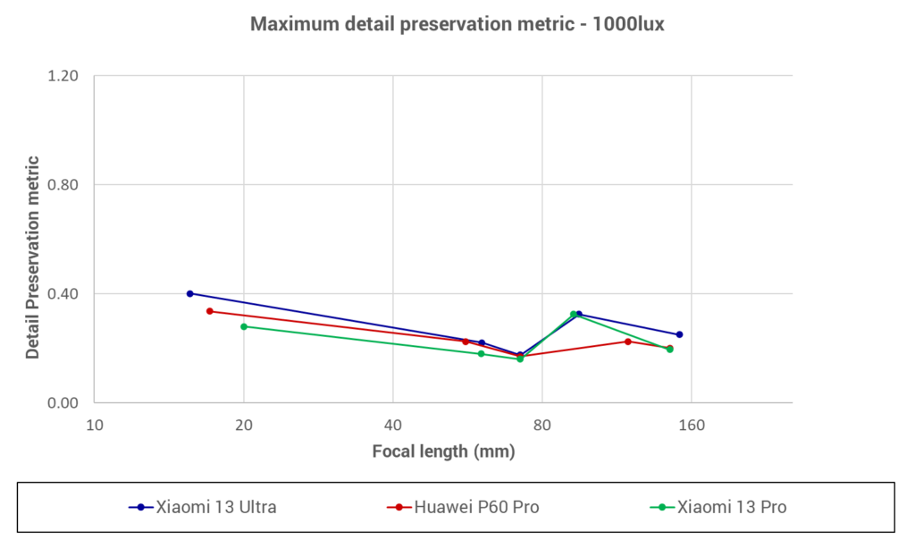

Texture tests analyze the level of details and the texture of subjects in the images taken in the lab as well as in real-life scenarios. For natural shots, particular attention is paid to the level of details in the bright and dark areas of the image. Objective measurements are performed on chart images taken in various lighting conditions from 1 to 1000 lux and different kinds of dynamic range conditions. The charts used are the proprietary SBMARK chart (DMC) and the Dead Leaves chart.
SBMARK CHART (DMC) detail preservation score vs lux levels for tripod and handheld conditions
This graph shows the evolution of the DMC detail preservation score with the level of lux, for two holding conditions. DMC detail preservation score is derived from an AI-based metric trained to evaluate texture and details rendering on a selection of crops of our SBMARK chart.
In our tests the Xiaomi 13 Ultra was capable of rendering very good detail. It was slightly above the 13 Pro, especially in indoor and low-light conditions. Compared to the Huawei P60 Pro, the Xiaomi 13 Ultra applied less sharpening, opting for a more natural rendering. However, the level of fine detail was perceptually lower than on the P60 Pro.

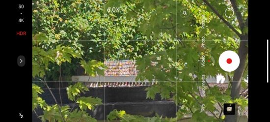

Video Zoom

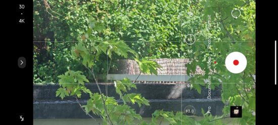

Our testers found the 13 Ultra’s video zoom quality to be poor with HDR video mode enabled. HDR video is only available on the primary camera, and digital zoom is applied for a limited zoom range of 1x to 6x. The resulting image quality was poor.
Xiaomi 13 Ultra – HDR ON – 6x video zoom
Xiaomi 13 Ultra – Lack of detail, moiré
Xiaomi 13 Ultra – HDR OFF – 6x video zoom
Xiaomi 13 Ultra – Good detail, no moiré
With HDR mode switched off, the user experience was much better, with smooth pinch zooming across the entire range. Detail was well preserved at wide settings and long range tele, but some loss of detail was noticeable at close and medium range.

SBMARK CHART (DMC) detail preservation score per focal length
This graph shows the evolution of the DMC detail preservation score with respect to the full-frame equivalent focal length for different light conditions. The x-axis represents the equivalent focal length measured for each corresponding shooting distance and the y-axis represents the maximum details preservation metric score: higher value means better quality. Large dots correspond to zoom ratio available in the user interface of the camera application.
The Xiaomi 13 Ultra comes equipped with two dedicated tele cameras with 75mm and 120mm equivalent focal lengths. In our tests, these cameras provided a very good performance across the entire tele range, up to 200mm. Image rendering was generally pleasant in terms of both exposure and color. Texture rendering was natural and noise was fairly well under control.
Xiaomi 13 Ultra – Indoor tele ~60mm
Xiaomi 13 Ultra – Slight loss of detail, slight noise
Xiaomi 13 Pro – Indoor tele ~60mm
Xiaomi 13 Pro – Loss of fine detail, slight noise
Huawei P60Pro – Indoor tele ~60mm
Huawei P60Pro – Good detail, no noise
The Xiaomi 13 Ultra emphasized natural detail instead of sharpening and ringing. This resulted in pleasant detail rendering, even though some fine detail was lost.

SBMARK engineers capture and evaluate more than 2.5 hours of video in controlled lab environments and in natural low-light, indoor and outdoor scenes, using the camera’s default settings. The evaluation consists of visually inspecting natural videos taken in various conditions and running objective measurements on videos of charts recorded in the lab under different conditions from 1 to 1000+ lux and color temperatures from 2,300K to 6,500K.
The Xiaomi 13 Ultra’s video mode was tested at 4K resolution and 30 frames per second, with Dolby Vision enabled. For the original HDR rendering, the YouTube video samples have to be watched on a compatible HDR screen. On other screens, a compressed SDR video is displayed. The Huawei P60 Pro video samples were recorded in Vivid HDR, while the Xiaomi 13 Pro’s videos were recorded in SDR.
Please note that for illustration and comparison purposes in this article, the HDR video screenshotsare 10-bit files that have been tone-mapped to SDR using a tone mapping technique that renders the perceived target exposure, darks preservation and texture-noise rendering as close as possible to what could be seen on the HDR monitor, but may incorrectly display the highlights and overall perceived contrast.
