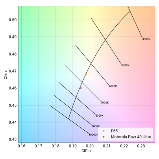

The Motorola Razr 40 Ultra’s default screen settings offered an impressive wide color gamut with intense saturation. But while this might be nice for some users, it might sometimes show strange colors because SDR photo and video formats have a more limited color gamut. However, no color artifacts were noted. For truer colors, however, users can opt for “natural mode”.

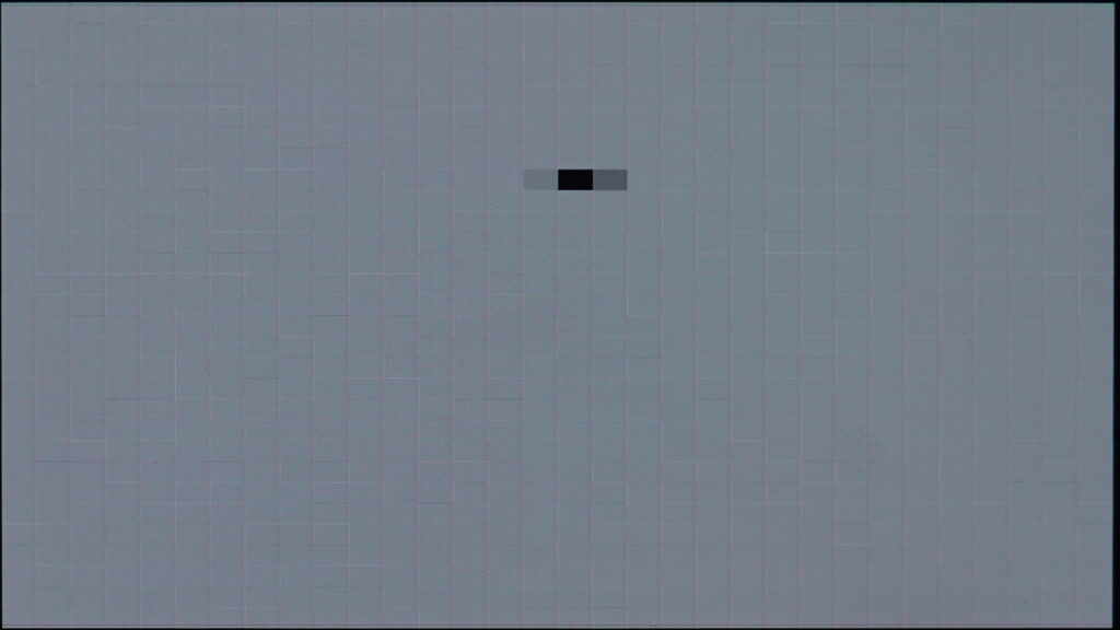

In particular, the screen was very smooth when scrolling and handled video frame drops and judder very well.

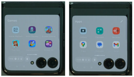

The large coverage screen is equipped with numerous widgets and dedicated apps, including games that can be played directly on the screen. You can also call and text from the screen. Although the cover screen is not tested in our protocol, we still measured its brightness, given its size and expanded functionality. The overlay screen adapts its brightness to ambient lighting, and we measured 1020 nits in a bright lighting environment, sufficient for simple tasks.
The cover screen offers an interface that allows you to use different applications, including games whose format is adapted to the size of the screen.
