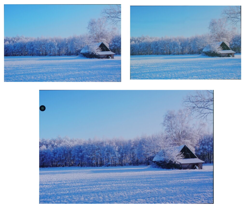

From left: Oppo Find N2 Flip, Samsung Galaxy Z Flip4, Vivo X Fold
Readability in a sunlight environment (>90,000 lux).
From left to right: Oppo Find N2 Flip, Samsung Galaxy Z Flip4, Vivo X Fold from left to right + Images for illustration only

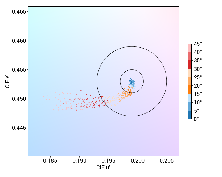

Color behavior on the corner
This graph shows the color shift when the screen is tilted. Each point represents a measurement at a particular angle. The dots within the inner circle show no color change in the corner; those between the inner and outer circle have shifts that only trained experts will see; but those which fall outside the outer circle are evident.
