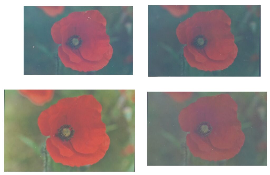

The color attribute evaluates the device’s ability to faithfully reproduce colors. Measurements taken include fidelity, white point color, and gamut coverage. We perform color assessments for different lighting conditions to see how well the device can handle color in its surroundings. Colors are measured using a spectrophotometer in a controlled lighting environment. The perceptual analysis of the color rendering compares with the reference model displayed on a calibrated professional monitor.
Clockwise from top left: Sony Xperia 10 V, Sony Xperia 10 IV, Google Pixel 7a, Samsung Galaxy A54 5G

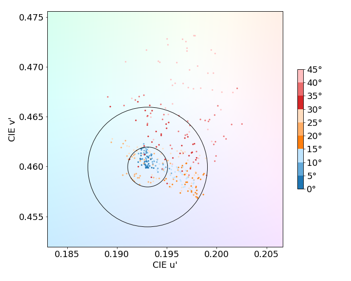

Color behavior on the corner
This graph shows the color shift when the screen is tilted. Each point represents a measurement at a particular angle. The dots within the inner circle show no color change in the corner; those between the inner and outer circle have shifts that only trained experts will see; but those which fall outside the outer circle are evident.

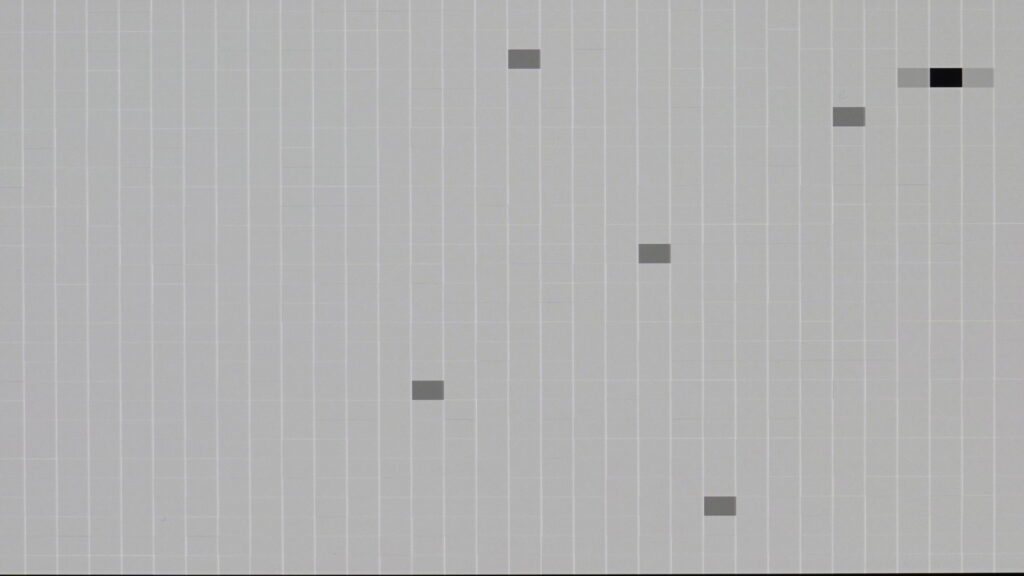

The motion attribute evaluates the handling of dynamic content. Frame drops, motion blur, and playback artifacts are examined using games and videos.
The video frame drops
These long exposure photos feature the number of frame irregularities in a 30 second video. Good performance shows a regular pattern (a flat gray image or a pull-down pattern).

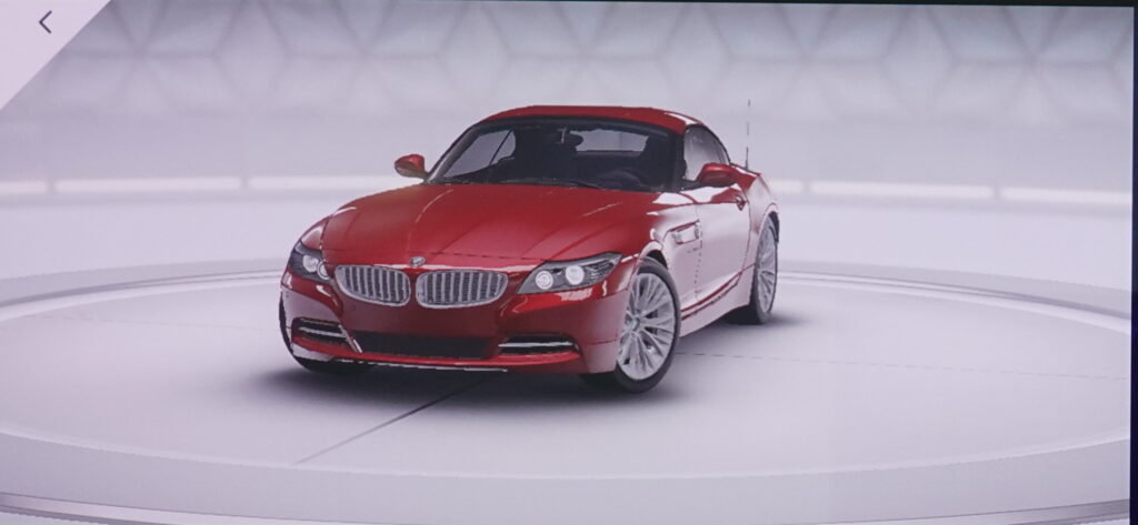

Evaluating artifacts means checking performance, image rendering, and motion artifacts that can impact the end-user experience. SBMARK accurately measures device reflectance and flicker, and evaluates the impact of residual aliasing when playing video games, among other characteristics.
Aliasing (foreground)
Sony Xperia 10V
