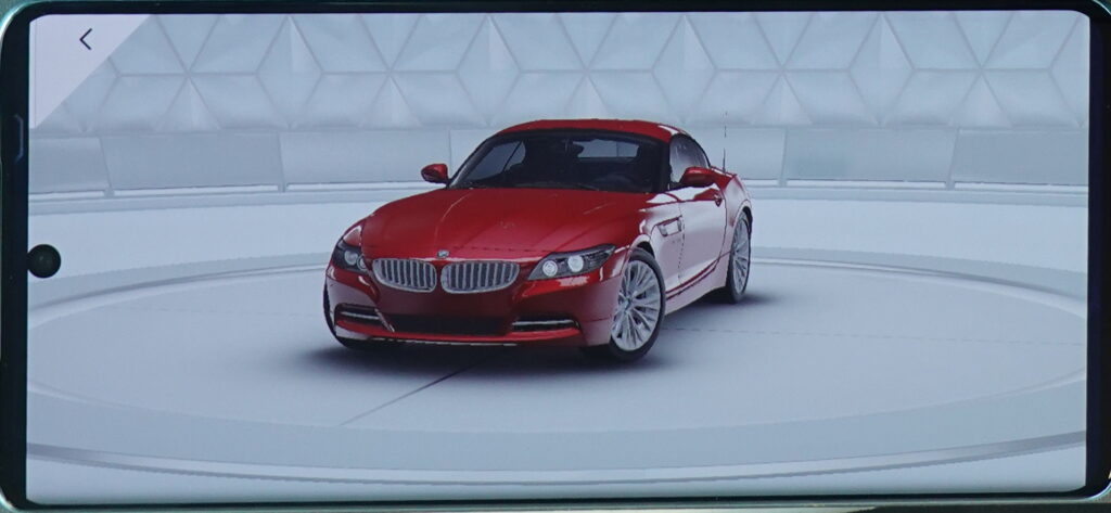

Like its predecessor, the Vivo X100 Pro’s weakest attribute in the protocol was motion due to dropped frames, which could affect the gaming experience.

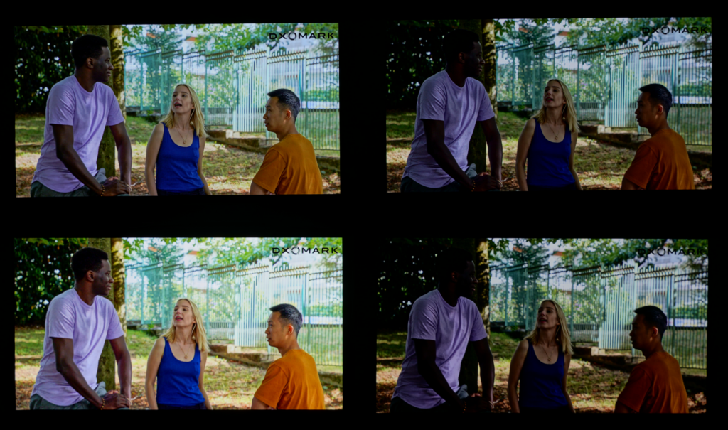

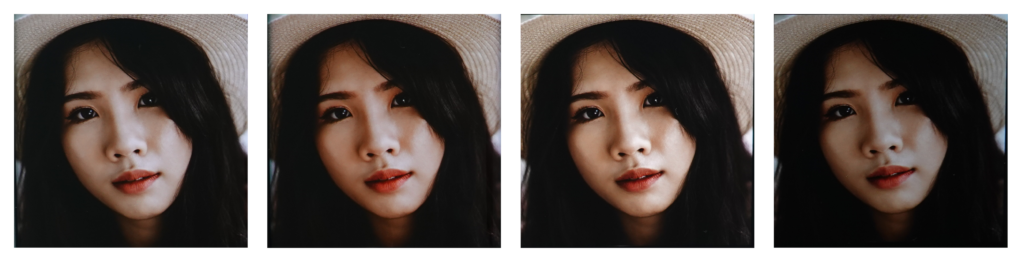

From left to right: Vivo X100 Pro, Vivo X90 Pro+, Huawei Mate 60 Pro, Samsung Galaxy S24 Ultra

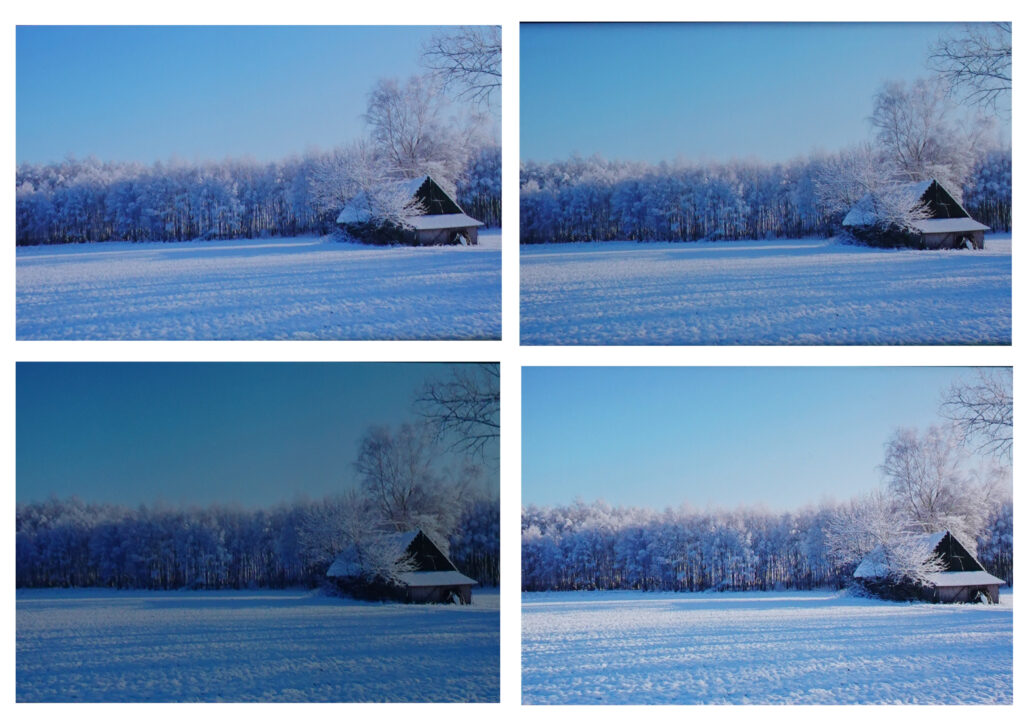

Clockwise from top left: Vivo X100 Pro, Vivo X90 Pro+, Huawei Mate 60 Pro, Samsung Galaxy S24 Ultra

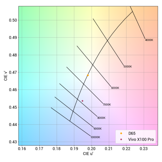

Color fidelity measurements

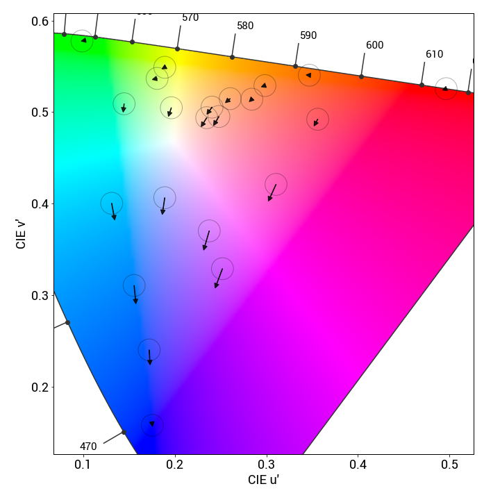

Vivo X100 Pro, color fidelity at 1000 lux in the sRGB color space

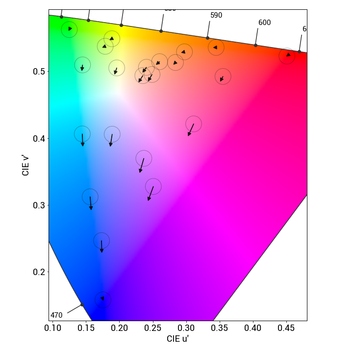

Vivo X100 Pro, color fidelity at 1000 lux in the Display-P3 color space

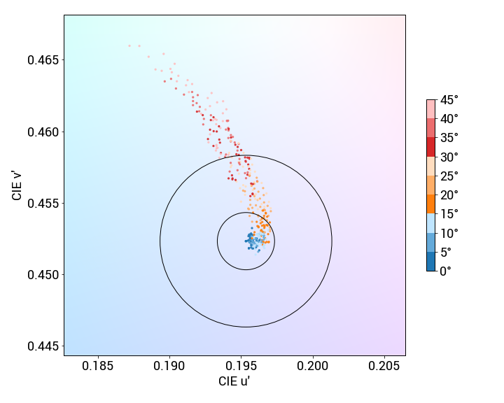

Color behavior on the corner

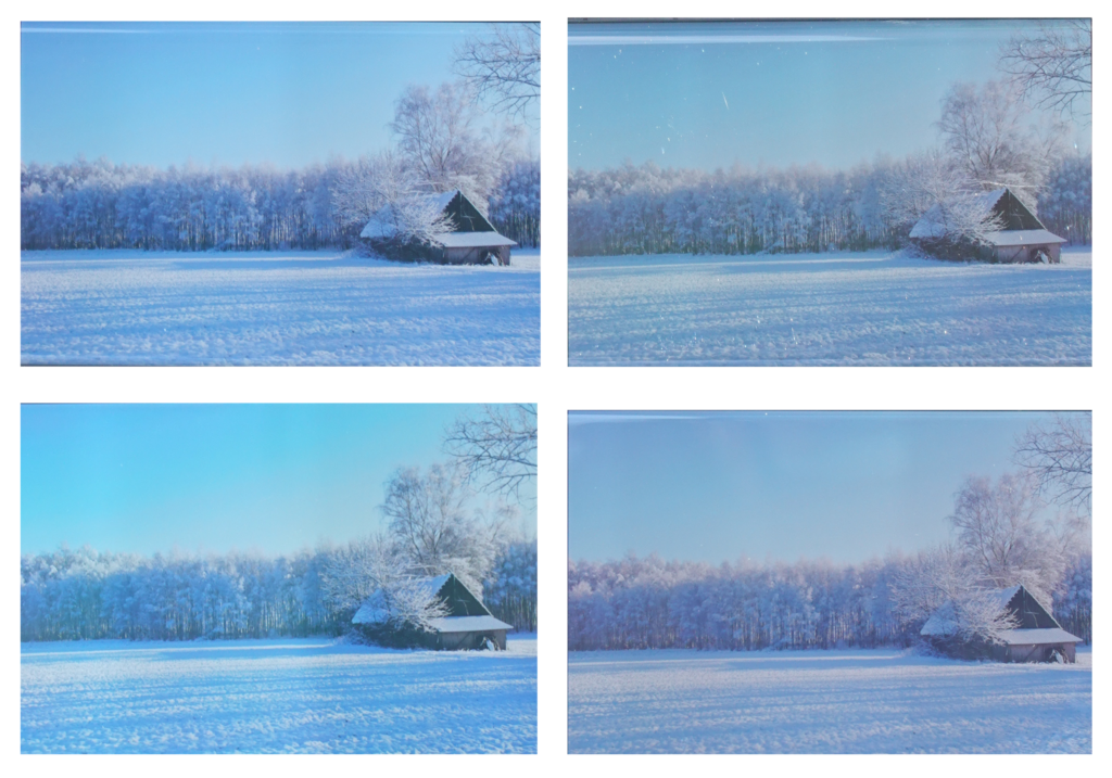

Dropped video frames
To evaluate touch, SBMARK uses a touch robot and a high-speed camera to play and record a series of scenarios for evaluating smoothness, accuracy and response time.
