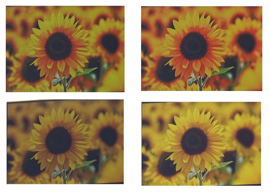

In the following illustrations, the S23 Ultra’s color under bright lighting was oversaturated, but it was still a slight improvement over its predecessor’s color, even if it wasn’t a complete fix.
Clockwise from top left: Samsung Galaxy S23 Ultra, Samsung Galaxy S22 Ultra, Apple iPhone 14 Pro Max, Google Pixel 7 Pro
The Samsung S23 Ultra tended to oversaturate colors while keeping the same hue. However, skin tones looked natural.

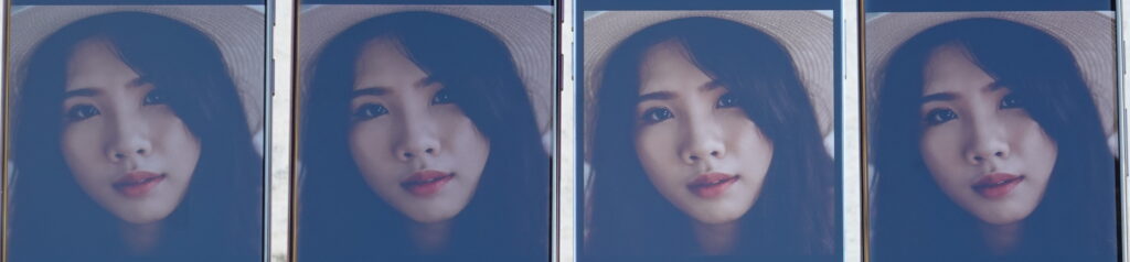

In one corner, the white dot takes on a blue to green tint.
Color behavior on the corner
This graph shows the color shift when the screen is tilted. Each point represents a measurement at a particular angle. The dots within the inner circle show no color change in the corner; those between the inner and outer circle have shifts that only trained experts will see; but those which fall outside the outer circle are evident.
Color shift on the corner
From left: Samsung Galaxy S23 Ultra, Samsung Galaxy S22 Ultra, Apple iPhone 14 Pro Max, Google Pixel 7 Pro

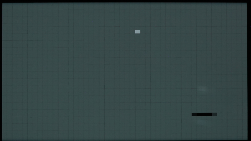

The motion attribute evaluates the handling of dynamic content. Frame drops, motion blur, and playback artifacts are examined using games and videos.
The handled frame of the Samsung Galaxy S23 Ultra drops noticeably better than the S22 Ultra, as well as providing better responsiveness when using the interface to navigate a video.
The video frame drops
These long exposure photos feature the number of frame irregularities in a 30 second video. Good performance shows a regular pattern (a flat gray image or a pull-down pattern).

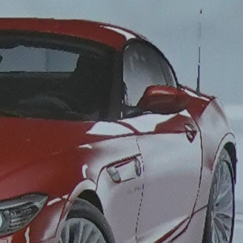

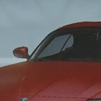

Evaluating artifacts means checking performance, image rendering, and motion artifacts that can impact the end-user experience. SBMARK accurately measures device reflectance and flicker, and evaluates the impact of residual aliasing when playing video games, among other characteristics.
The S23 Ultra had the same flickering issue and showed visible aliasing as the S22 Ultra (albeit slightly improved); it also handles vibrations a bit better than the old phone.
Aliasing (foreground)
Samsung Galaxy S23 Ultra – Crop 1
Samsung Galaxy S23 Ultra – Crop 2
Samsung Galaxy S23 Ultra – Crop 3
