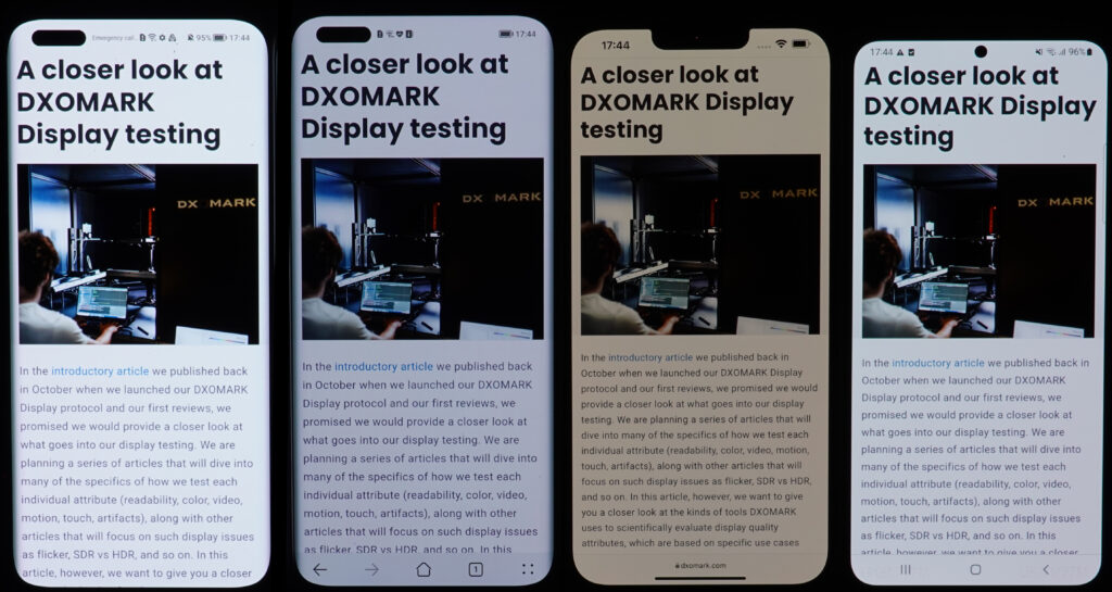

Readability evaluates the ease and comfort with which users can read stationary content (photos and web) on the display under various real-life conditions. SBMARK uses its Display Bench to recreate ambient light conditions ranging from total darkness to bright sunlight. In addition to laboratory tests, perceptual analysis is also carried out in real-life environments.
Readability in a low light environment (0 lux).
Left to right: Honor Magic4 Pro, Honor Magic4 Ultimate, Apple iPhone 13 Pro Max, Samsung Galaxy S22 + (Exynos)
Readability indoors (1000 lux).

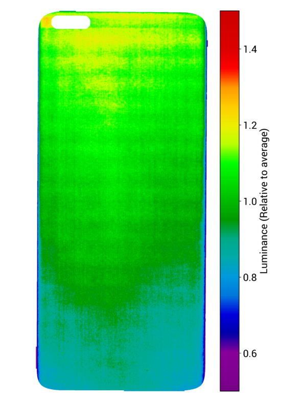

This graph shows the uniformity of the display with a gray pattern of 20%. The more green the color is visible, the smoother the display.

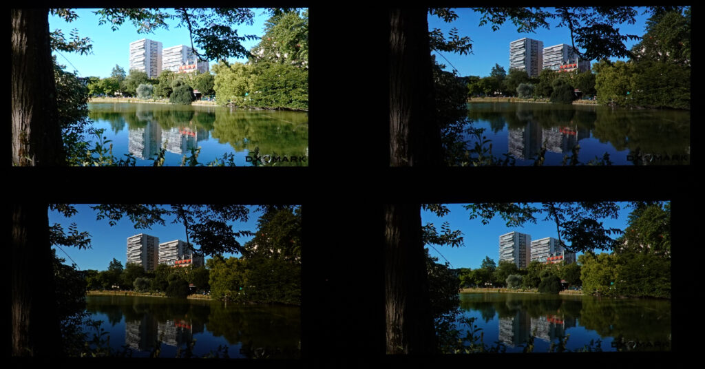

White point under illuminant D65 at 1000 lux
Clockwise from top left: Honor Magic4 Pro, Honor Magic4 Ultimate, Samsung Galaxy S22 + (Exynos), Apple iPhone 13 Pro Max

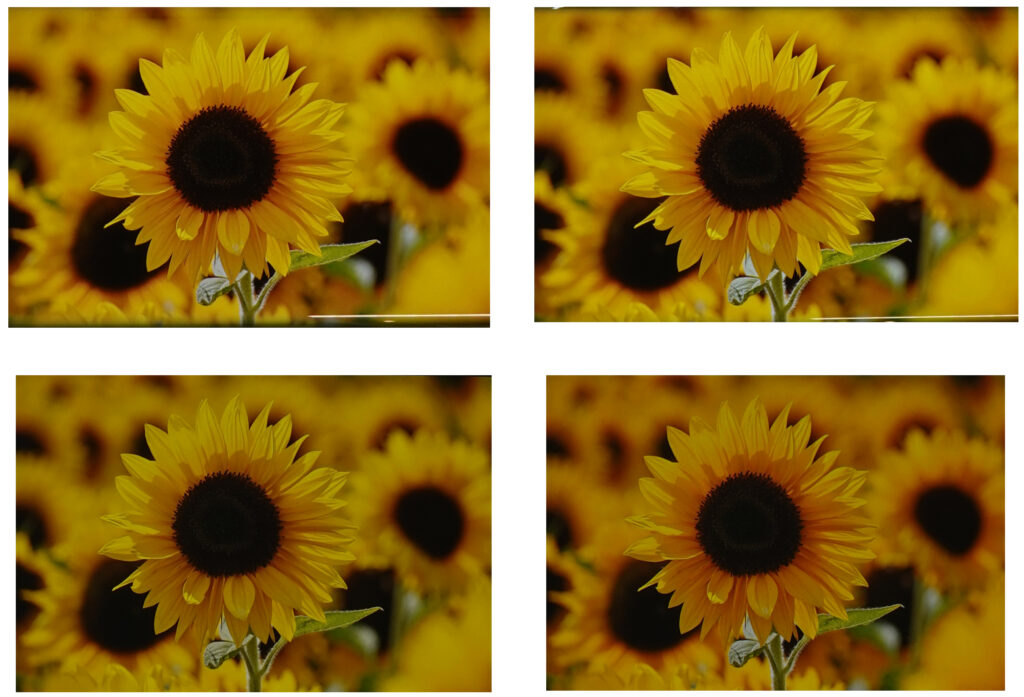

Our video attribute evaluates the Standard Dynamic Range (SDR) and High Dynamic Range (HDR10) video handling of each device indoors and in low light conditions. We measure the tone mapping, color gamut, brightness and contrast of the display. We perform perceptual analysis Cons our professional reference monitor (Sony BVM-HX310) to ensure that the rendering respects the artistic intent.

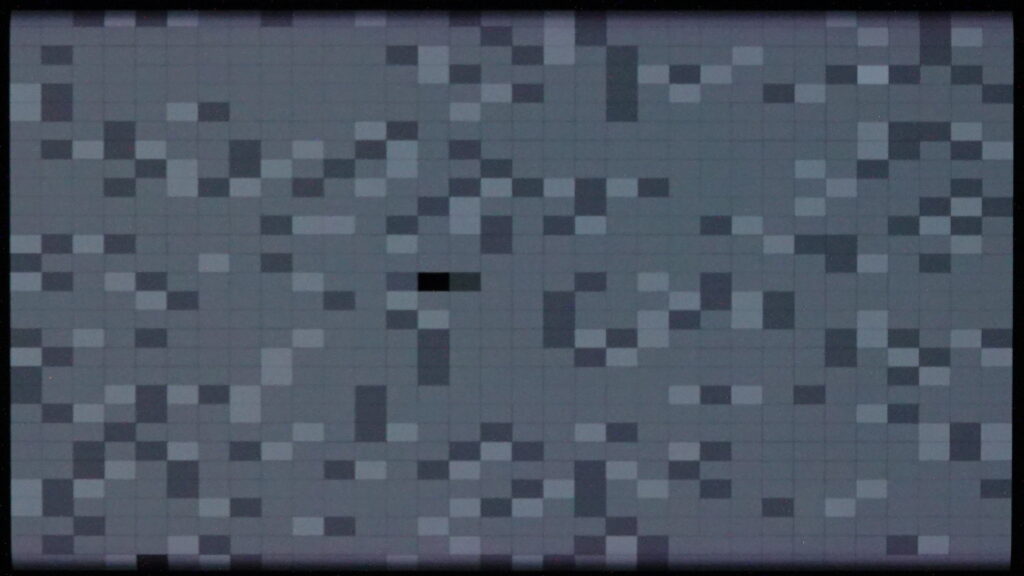

The video frame drops to 30 fps
These long exposure photos present the number of frame irregularities in a 30 second video. A good performance shows a regular pattern (a flat gray image or a drop-down pattern).
