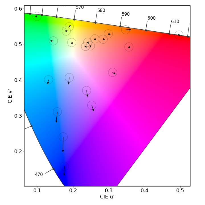

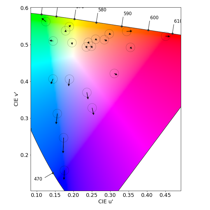

In our display evaluation, our testers found the S24’s screen colors to be a huge improvement over its S23 predecessor. Colors on the S24 were much more accurate than previous S-series models, particularly outdoors, correcting the color artifact noted on the S23-series. The new type of color signature of the S24 series, with the same color rendering on all three models, offers a much more “natural” rendering than the previous series. However, when viewing the S24’s screen from an angle, the screen colors changed, but not as much as on the S24 Ultra, a factor that helped the S24 score slightly better in the color attribute.

Color fidelity measurements
Samsung Galaxy S24, color fidelity at 1000 lux in the sRGB color space
Samsung Galaxy S24, color fidelity at 1000 lux in the Display-P3 color space

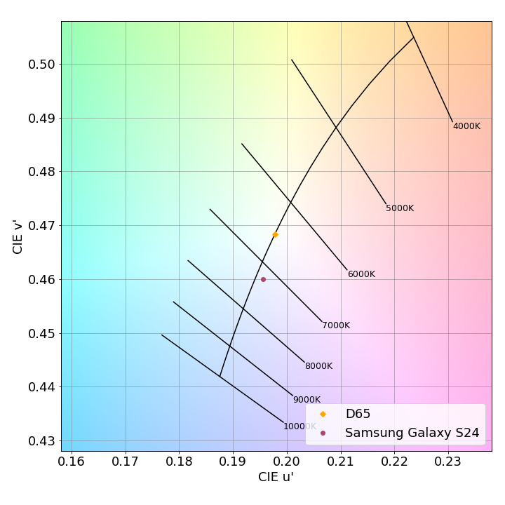

Color behavior on the corner
Color shift on the corner

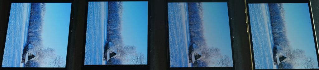

From left to right: Samsung Galaxy S24, Samsung Galaxy S23, Apple iPhone 15, Google Pixel 8

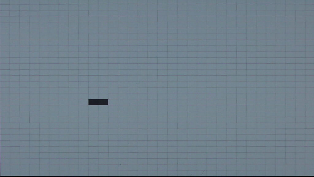

Dropped video frames
To evaluate touch, SBMARK uses a touch robot and a high-speed camera to play and record a series of scenarios for evaluating smoothness, accuracy and response time.
Aliasing (foreground)
Samsung Galaxy S24
