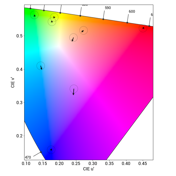

Color fidelity measurements
Vivo X60 Pro (Snapdragon), 1000 lux color fidelity in the sRGB color space
Vivo X60 Pro (Snapdragon), color fidelity at 1000 lux in the DCI-P3 color space
Each arrow represents the color difference between a target color model (arrow base) and its actual measurement (arrowhead). The longer the arrow, the more visible the color difference. If the arrow stays inside the circle, the color difference will only be visible to trained eyes.

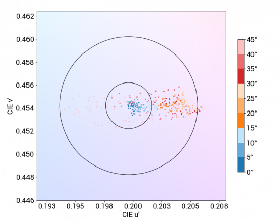

Behavior of the color on the corner
This graph shows the shift of color when the screen is tilted. Each point represents a measurement with a particular angle. The points inside the inner circle show no color change in the corner; those between the inner and outer circle have shifts that only trained experts will see; but those who fall outside the outer circle are noted.

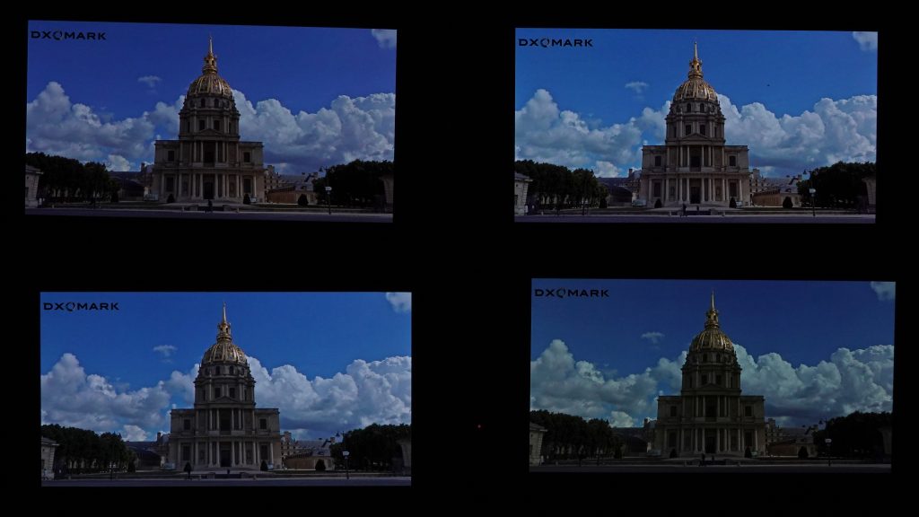

Our video attribute evaluates the Standard Dynamic Range (SDR) and High Dynamic Range (HDR10) video handling of each device indoors and in low-light conditions. We measure the tone mapping, color gamut, brightness and contrast of the display. We perform perceptual analysis Cons our professional reference monitor (Sony BVM-HX310) to ensure that the rendering respects the artistic intent.
Clockwise from top left: Vivo X60 Pro (Snapdragon), Vivo X60 Pro +, Motorola Edge 20 Pro, OnePlus 9 Pro

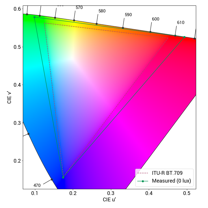

Range coverage for video content
Primary colors are measured in both HDR10 and SDR. The extracted color gamut shows the extent of the color area that the device can render. To respect the artistic intent, the measured gamut should match the main color space of each video.
