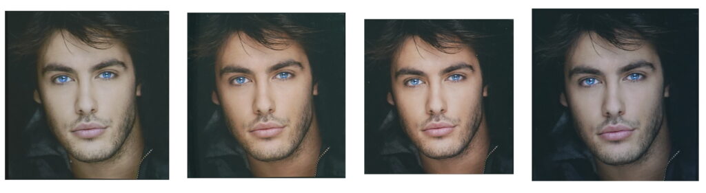

Readability evaluates the ease and comfort with which users can read the still content (photos and web) on the display under various real-life conditions. SBMARK uses its Display Bench to recreate ambient light conditions ranging from total darkness to bright sunlight. In addition to laboratory tests, perceptual analysis is also performed in real-life environments.
From left: Samsung Galaxy A54 5G, Samsung A53 5G, Google Pixel 6a, Xiaomi 12T
Readability in a sunlight environment (> 90,000 lux).

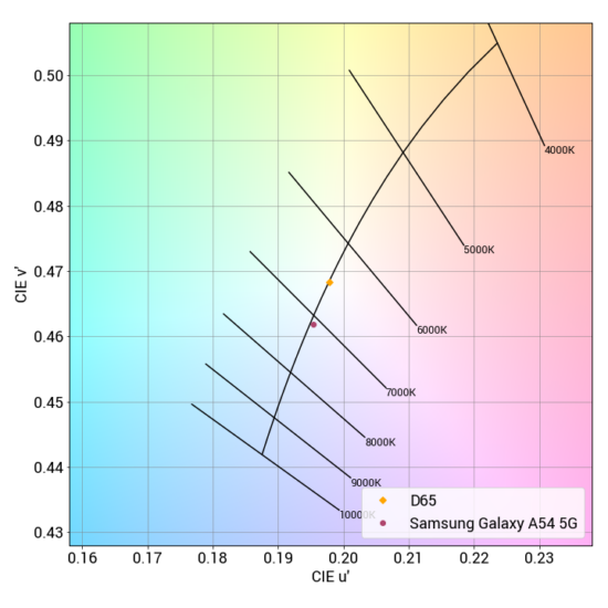

The color attribute evaluates the device’s ability to faithfully reproduce colors. Measurements taken include fidelity, white point color, and gamut coverage. We perform color assessments for different lighting conditions to see how well the device can handle color in its surroundings. Colors are measured using a spectrophotometer in a controlled lighting environment. The perceptual analysis of the color rendering compares with the reference model displayed on a calibrated professional monitor.

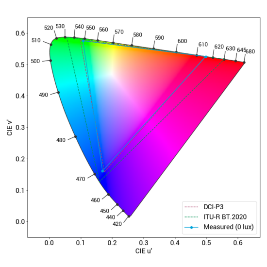

Primary colors are measured in both HDR10 and SDR. The extracted color gamut shows the extent of color area that the device can render. To meet artistic intent, the measured gamut should match the primary color space of each video.

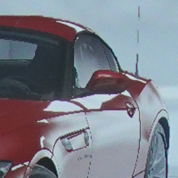

Evaluating artifacts means checking performance, image rendering, and motion artifacts that can impact the end-user experience. SBMARK accurately measures device reflectance and flicker, and evaluates the impact of residual aliasing when playing video games, among other characteristics.
Aliasing (foreground)
Samsung Galaxy A54 5G – Crop1
Samsung Galaxy A54 5G – Crop 2
Samsung Galaxy A54 5G – Crop3
