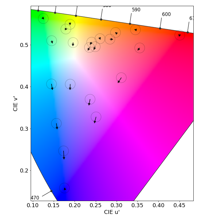

Color fidelity measurements
Xiaomi 13 Ultra, color fidelity at 1000 lux in the sRGB color space
Xiaomi 13 Ultra, color fidelity at 1000 lux in Display-P3 color space
Each arrow represents the color difference between a target color pattern (arrow base) and its actual measurement (arrow tip). The longer the arrow, the more visible the color difference. If the arrow stays inside the circle, the color difference will only be visible to trained eyes.
