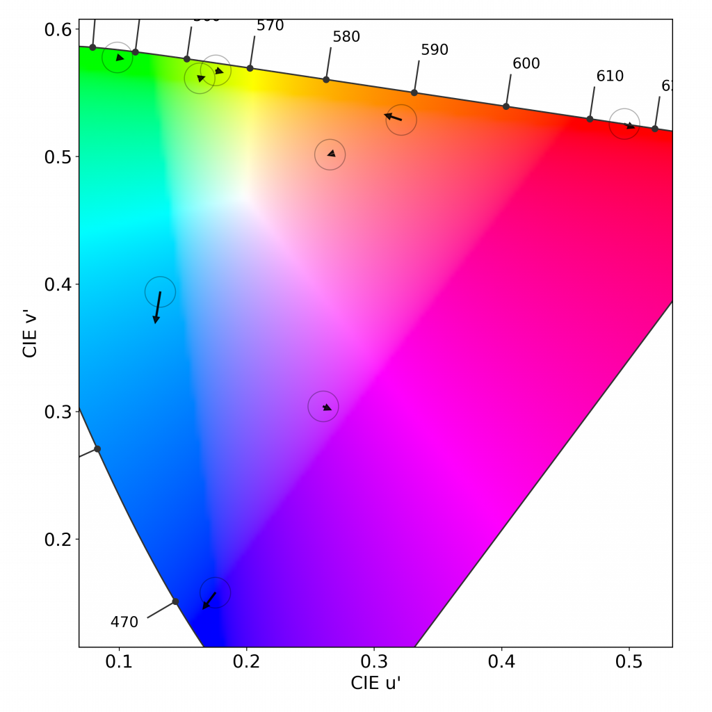

In our lab tests, the S22 Ultra (Exynos) demonstrates good overall color fidelity, as shown in tthe graph at the bottom left. It is better than the S21 Ultra (Exynos) and comparable to OnePlus 9 Pro. The center of each circle is the target color; anything outside the circle represents a noticeable difference in color. The further the arrowhead is outside the circle, the more users will notice the difference between the color on the display and the color of the actual object or graphic next to it. The scatter plot on the right shows that the S22 Ultra (Exynos) shifts towards blue when viewed from an angle.
Samsung Galaxy S22 Ultra (Exynos), 1000 lux color fidelity in the P3 color space
Samsung Galaxy S22 Ultra 5G (Exynos), white dot on the corner

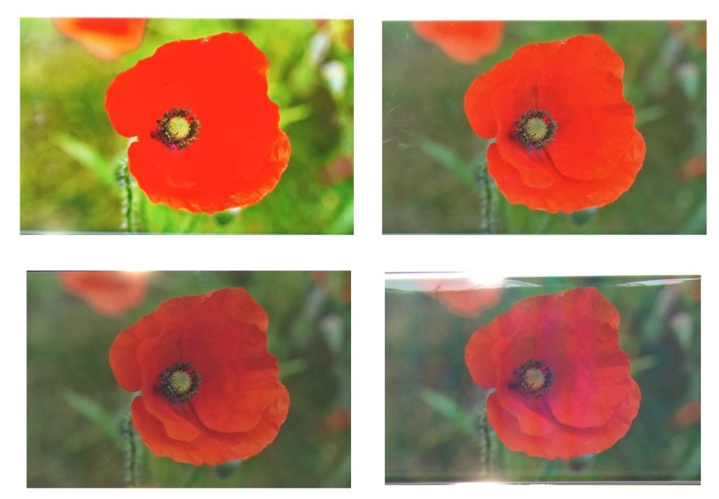

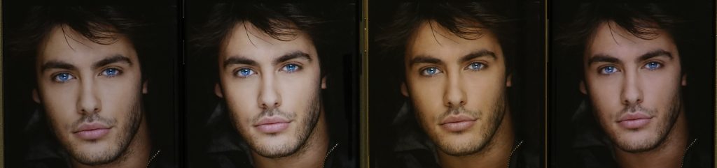

In sunlight, in addition to excellent readability, the colors on the complexion of the S22 Ultra (Exynos) are faithful, especially when compared to the OnePlus9 Pro, which has a reddish complexion rendering:
Sunlight skin tone rendering
Left to right: Samsung Galaxy S22 Ultra (Exynos), Samsung Galaxy S21 Ultra 5G (Exynos), Apple iPhone 13 Pro Max, OnePlus 9 Pro
Photo credit: SBMARK; for illustration only

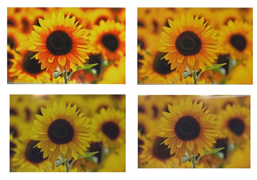

But even in sunlight, however, the S22 Ultra (Exynos) aggressively pushes saturation to its maximum level, with the effect that all color shades disappear in many images, as illustrated in the example above. bottom left.
Color rendering in sunlight
Clockwise from top left: Samsung Galaxy S22 Ultra (Exynos), Samsung Galaxy S21 Ultra 5G (Exynos), OnePlus 9 Pro, Apple iPhone 13 Pro Max

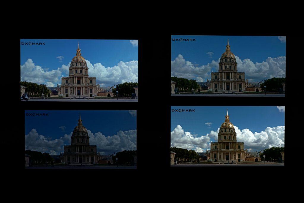

The highlights are well handled and the colors are very faithful on the S22 Ultra (Exynos) as seen in the photo below. Both the S21 Ultra 5G (Exynos) and the iPhone 13 Pro Max, however, also show accurate colors, but show a blue and yellow cast respectively, while the S22 Ultra (Exynos) is the more neutral of the three smartphones.
Video rendering in a low-low environment (0 lux).
Clockwise from top left: Samsung Galaxy S22 Ultra (Exynos), Samsung Galaxy S21 Ultra 5G (Exynos), Apple iPhone 13 Pro Max, OnePlus 9 Pro
The excellent tone mapping of the S22 Ultra (Exynos) and its adapted brightness qualify it for the top slot in the Video attribute.

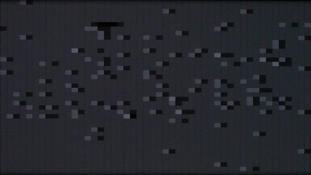

For motion, although it handles frame drops a little better than its predecessor during gaming, the S22 Ultra (Exynos) scores lower than the S21 Ultra 5G (Exynos) and its competitors due to frame drops during video playback. In the test images of the S22 Ultra (Exynos) at 30 fps and 60 fps in a row, the ideal result would be smooth gray fields; instead, you can see many brighter and darker squares which are indicative of frame drops.
The video frame drops
Samsung Galaxy S22 Ultra 5G (Exynos), the frame drops to 30 fps
Samsung Galaxy S22 Ultra 5G (Exynos), the frame drops to 60 fps

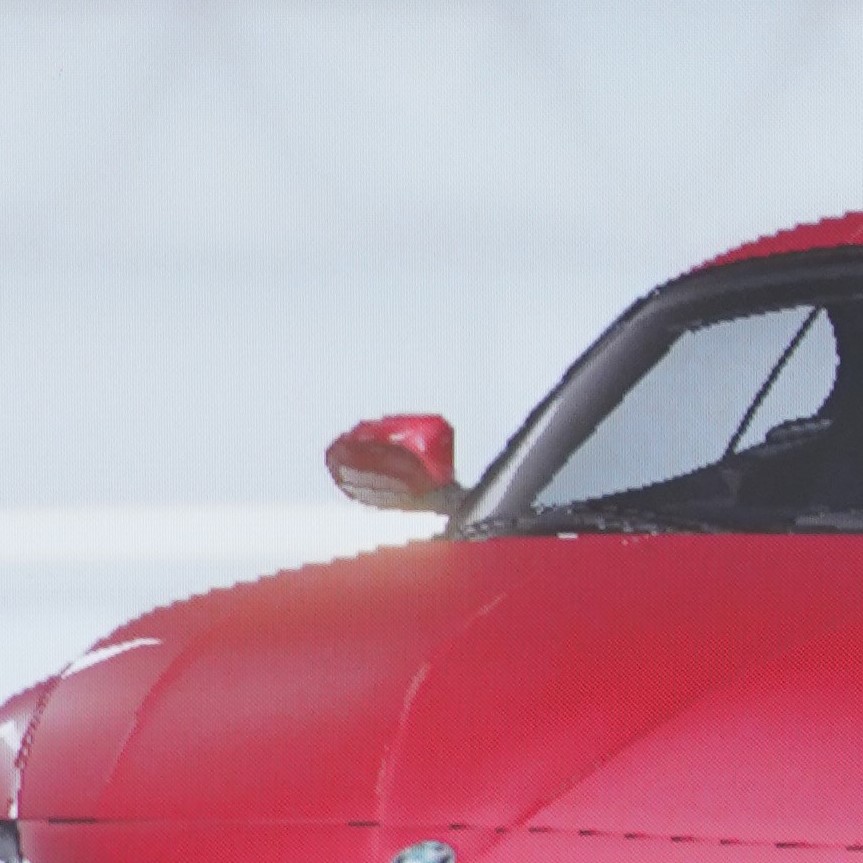

Ghost touches are very common, with or without the protection from accidental contact option activated. However, aliasing has improved slightly over the S21 Ultra 5G (Exynos).
Alias (foreground)
Samsung Galaxy S22 Ultra (Exynos), aka
Samsung Galaxy S21 Ultra 5G (Exynos), aka
