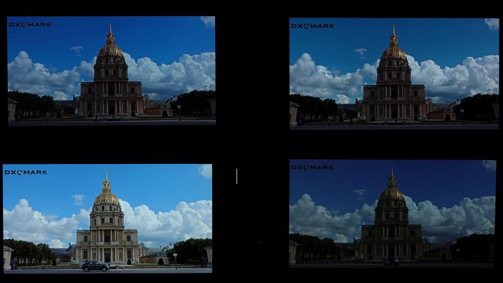

Readability evaluates the ease and comfort with which users can read stationary content (photos and web) on the display under various real-life conditions. SBMARK uses its Display Bench to recreate ambient light conditions ranging from total darkness to bright sunlight. In addition to laboratory tests, perceptual analysis is also carried out in real-life environments.
Readability in an outdoor environment (20,000 lux).
From left: Vivo X70 Pro (MediaTek), Vivo X70 Pro +, Motorola Edge 20 Pro, Xiaomi 11T Pro

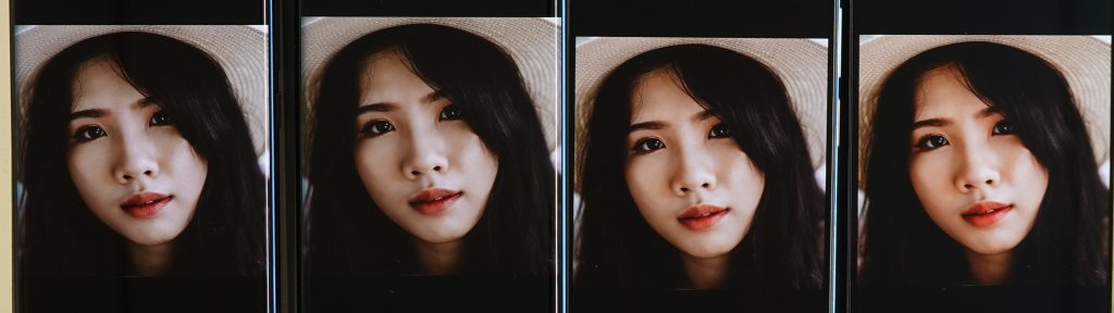

Readability in a sunlight environment (> 90 0000 lux).

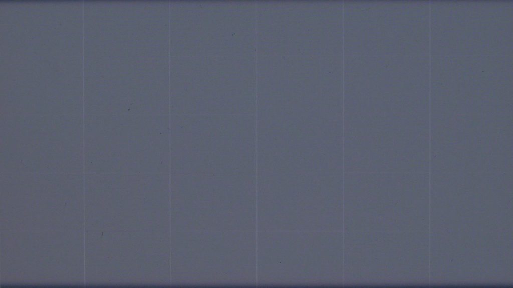

This graph shows the uniformity of the display with a gray pattern of 20%. The more green the color is visible, the smoother the display.

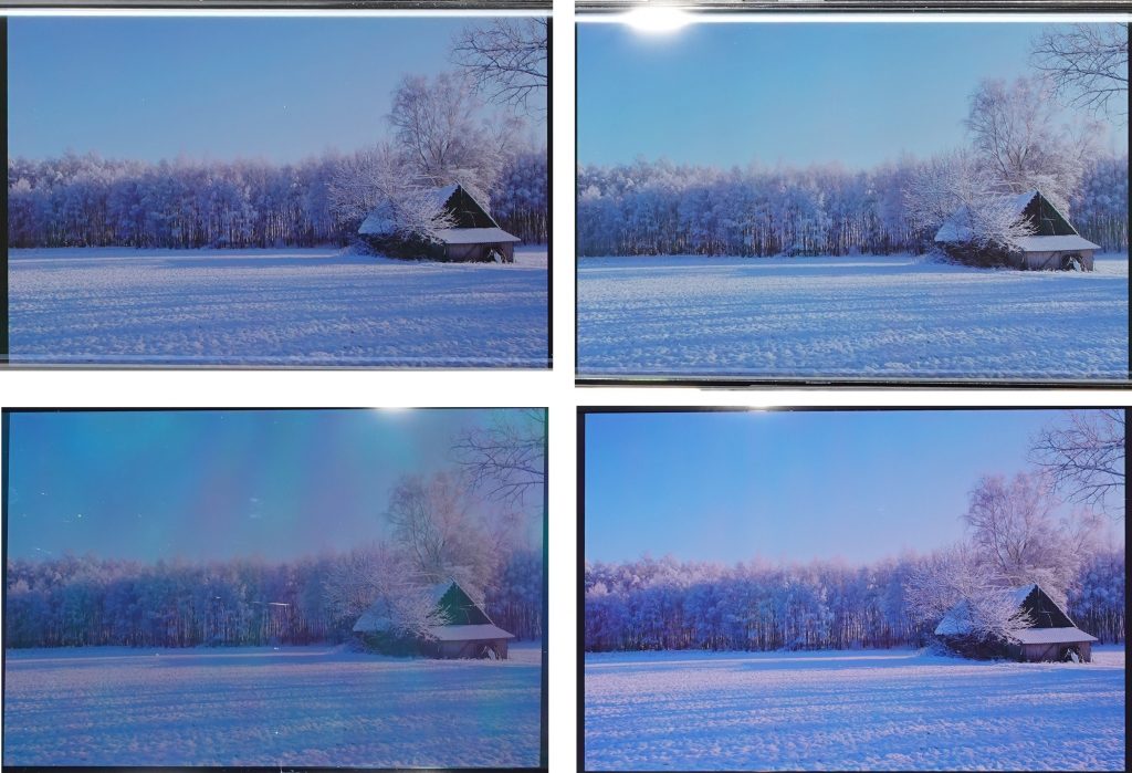

Color rendering in sunlight (> 90 0000 lux)
Clockwise from top left: Vivo X70 Pro (MediaTek), Vivo X70 Pro +, Motorola Edge 20 Pro, Xiaomi 11T Pro

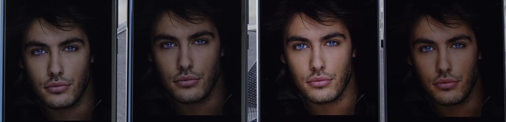

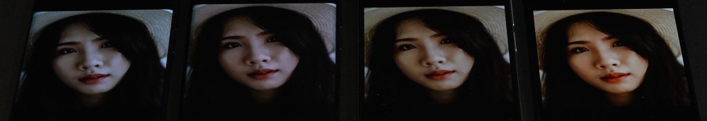

Our video attribute evaluates the Standard Dynamic Range (SDR) and High Dynamic Range (HDR10) video handling of each device indoors and in low-light conditions. We measure the tone mapping, color gamut, brightness and contrast of the display. We perform perceptual analysis Cons our professional reference monitor (Sony BVM-HX310) to ensure that the rendering respects the artistic intent.

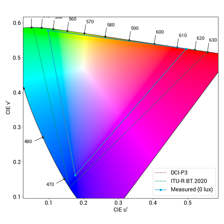

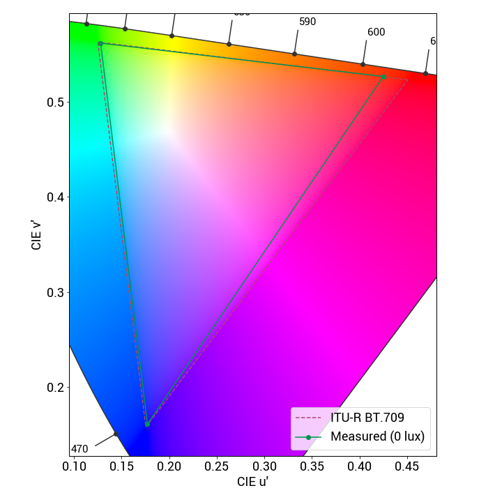

Range coverage for video content
Primary colors are measured in both HDR10 and SDR. The extracted color gamut shows the extent of the color area that the device can render. To respect the artistic intent, the measured gamut should match the main color space of each video.

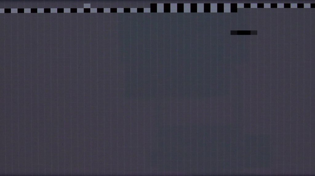

The video frame drops
These long exposure photos present the number of frame irregularities in a 30 second video. A good performance shows a regular pattern (a flat gray image or a drop-down pattern).
