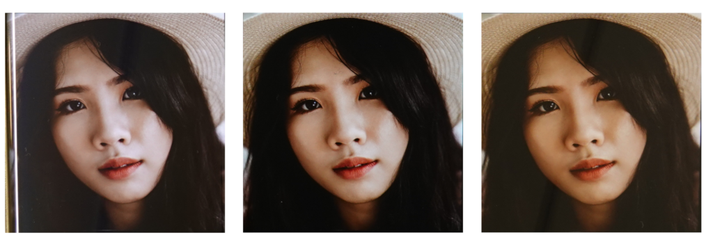

Readability evaluates the user’s ease and comfort in viewing stationary content, such as photos or a web page, on the display under different lighting conditions. Our measurements performed in laboratories are complemented by perceptual tests and analyses.
Skin tone rendering in an indoor environment (1000 lux).
From left to right: Oppo Find X7 Ultra, Samsung Galaxy S24 Ultra, Apple iPhone 15 Pro Max
Skin tone rendering in a sunny environment (>90,000 lux).
