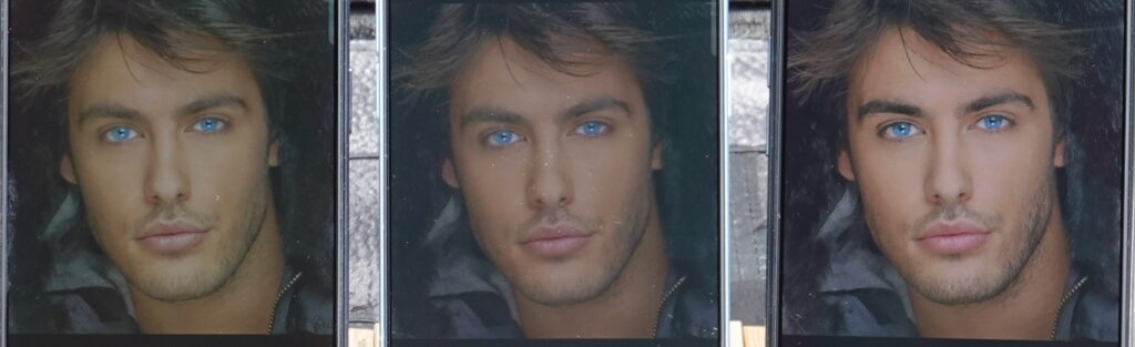

Readability indoors (1000 lux).
From left to right: Oppo Reno8 Pro 5G, Oppo Reno6 Pro 5G, Xiaomi 11T

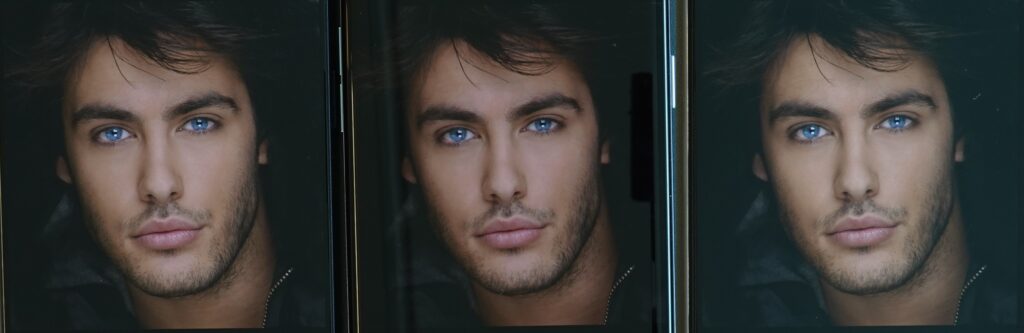

Readability in a sunlight environment (> 90 0000 lux).
The display of the Oppo Reno8 Pro 5G, top left, has lost a few points compared to its brother Reno8 5G, bottom left, in readability in sunlight. As the example shows, the dark tones of the Pro were less visible than the Reno8.

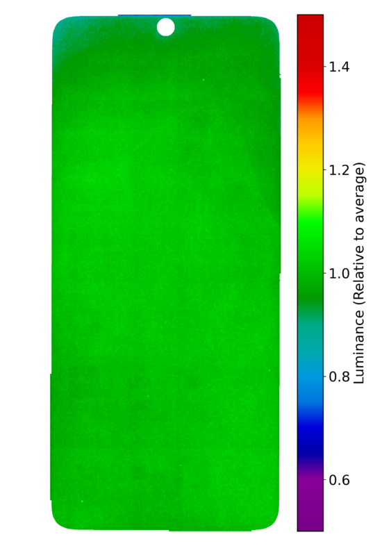

This graph shows the uniformity of the display with a gray pattern of 20%. The more green the color is visible, the smoother the display.

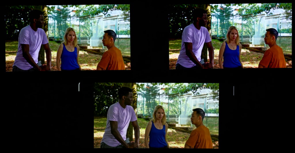

Our video attribute evaluates the Standard Dynamic Range (SDR) and High Dynamic Range (HDR10) video handling of each device indoors and in low-light conditions. We measure the tone mapping, color gamut, brightness and contrast of the display. We perform perceptual analysis Cons our professional reference monitor (Sony BVM-HX310) to ensure that the rendering respects the artistic intent.
Clockwise from top left: Oppo Reno8 Pro 5G, Oppo Reno6 Pro 5G, Xiaomi 11T(Photo for illustrative purposes only)

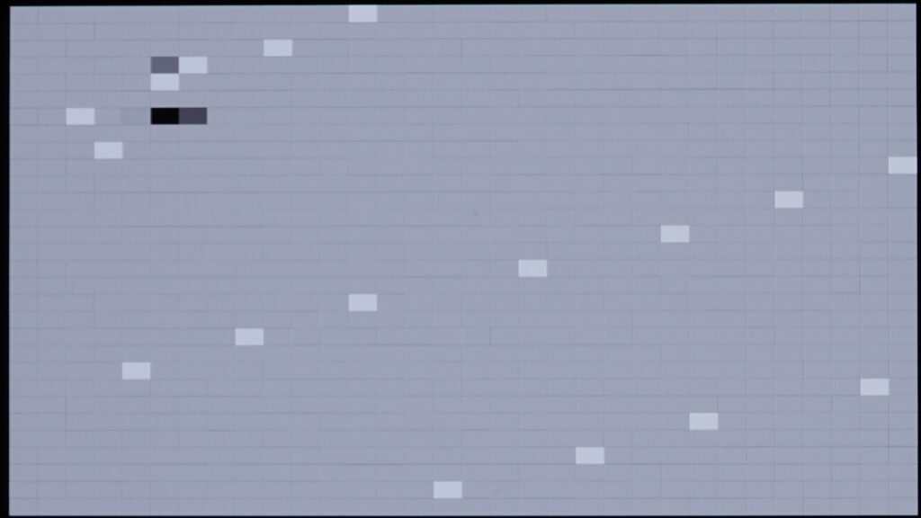

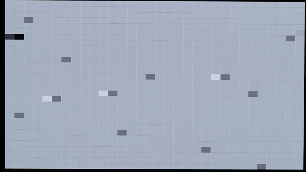

The video frame drops to 30 fps
These long exposure photos present the number of frame irregularities in a 30 second video. A good performance shows a regular pattern (a flat gray image or a drop-down pattern).

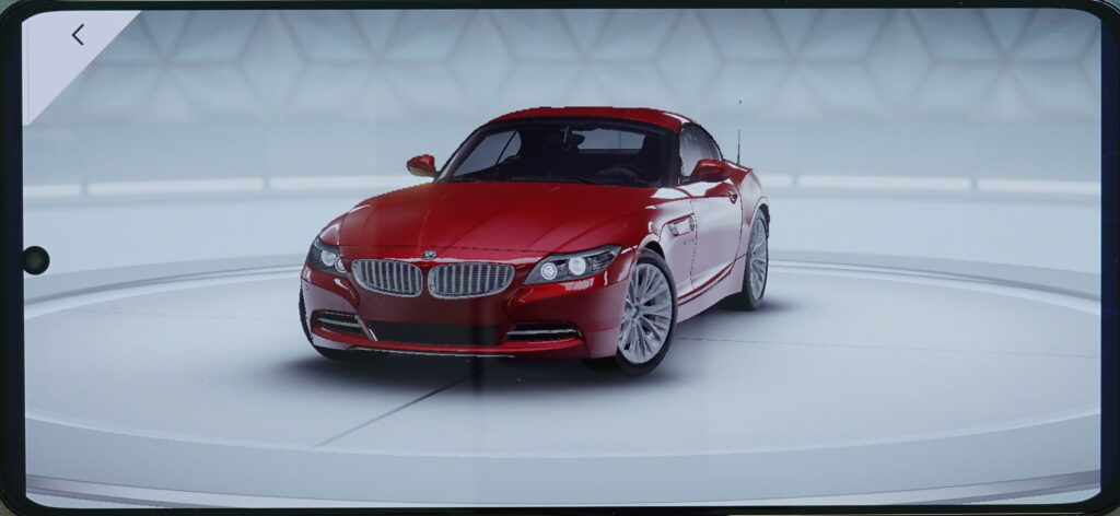

This response time test accurately evaluates the time elapsed between a single tap of the robot on the screen and the displayed action. This test is applied to activities that require high responsiveness, such as play.
