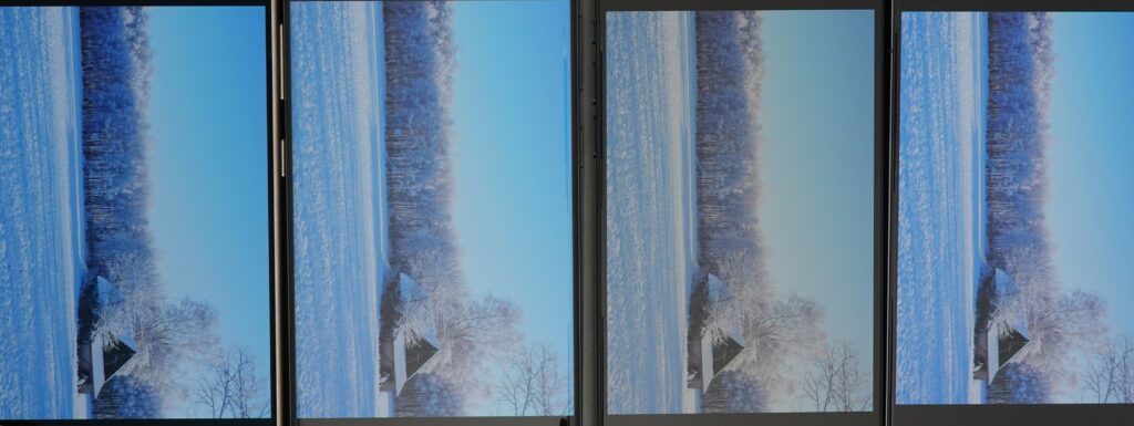

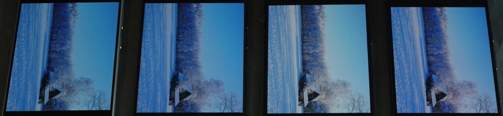

In terms of readability, the S24 Ultra was just shy of achieving the maximum score with its impressive performance in harsh environments. In our tests under sunlight, the device achieved a measured peak brightness of 2572 nits (close to the advertised 2600), which is significantly higher than the Galaxy S23 Ultra’s 1750 nits. Additionally, the addition of anti-reflective glass serves to deepen contrast to make images more vivid in challenging conditions. These combined performances mean that in direct sunlight it is not necessary to find a shaded area or cover the screen with your hand to be able to see and read what appears on the display. While performance was great outdoors, screen brightness could be a bit inaccurate in other conditions: Our test results showed that screen brightness could sometimes be too high at night and too low in indoor environments. interior.

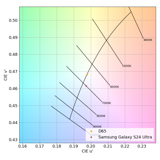

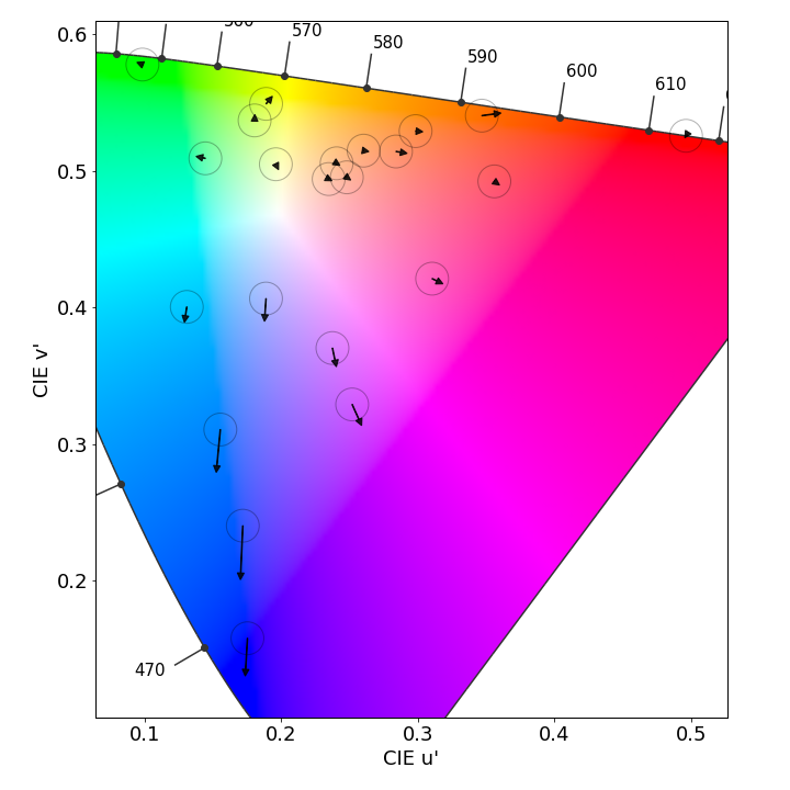

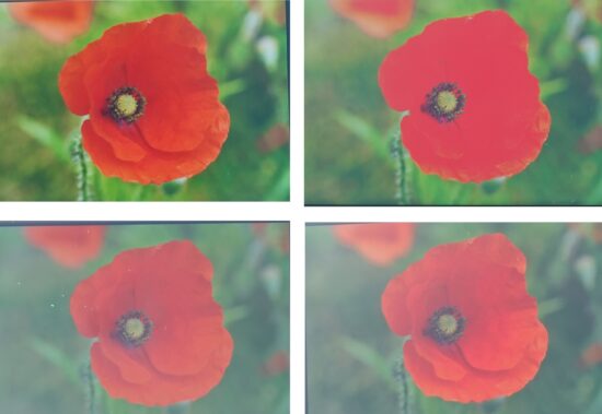

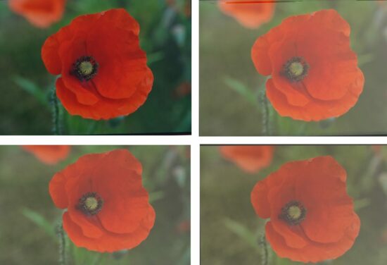

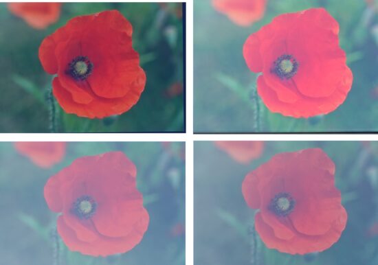

The Samsung Galaxy S24 Ultra’s color fidelity and performance were much better than the S23 Ultra’s, particularly outdoors where the S24 Ultra corrected its predecessor’s lack of color cast, but still remained a bit ‘ behind the maximum score. Additionally, viewing the screen at an angle would show a slight shift towards pink and green.

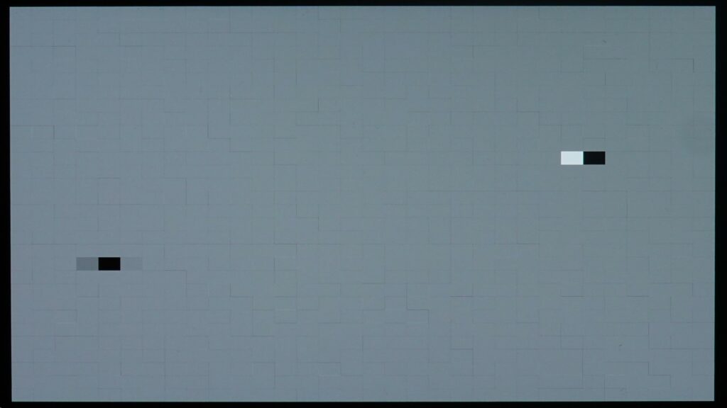

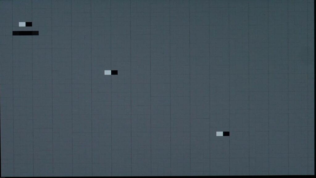

Motion performance earned a top score for the S24 Ultra thanks to the excellent way it handled frame discrepancies during video playback. Furthermore, the display would adapt its refresh rate to that of the video frame rate, thus avoiding vibrations.

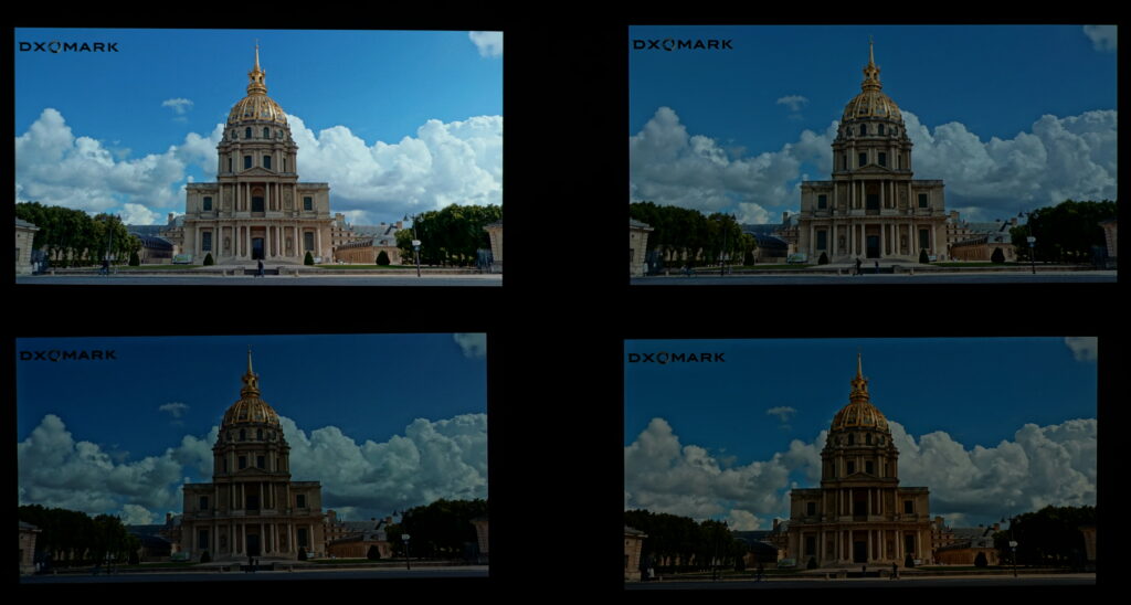

The S24 Ultra was supposed to provide a very similar video experience to its predecessor, but that wasn’t the case. The S24 Ultra wasn’t able to achieve the S23 Ultra’s better performance in videos mainly because the screen was too bright to comfortably view content in a low-light environment.

From left to right: Samsung Galaxy S24 Ultra, Samsung Galaxy S23 Ultra, Apple iPhone 15 Pro Max, Google Pixel 8 Pro
Readability in an outdoor environment (20,000 lux).

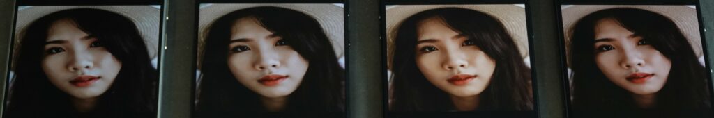

Readability at a 45° angle

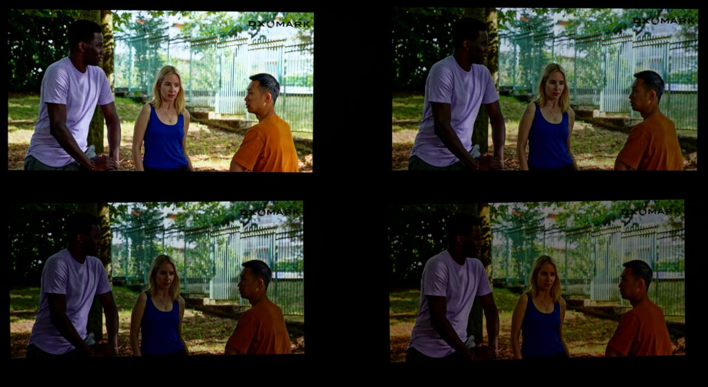

Clockwise from top left: Samsung Galaxy S24 Ultra, Samsung Galaxy S23 Ultra, Apple iPhone 15 Pro Max, Google Pixel 8 Pro
Outdoor color rendering (20,000 lux)

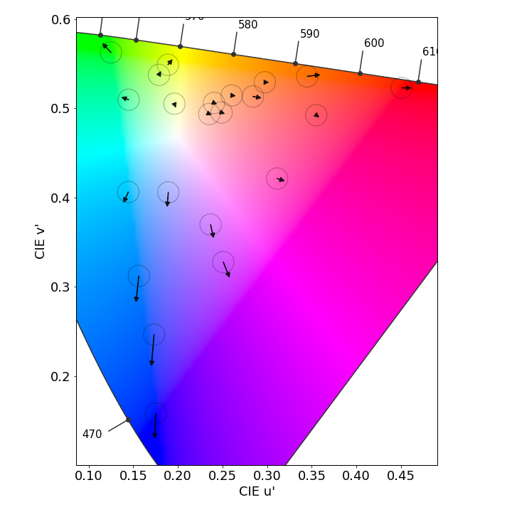

Color fidelity measurements
Samsung Galaxy S24 Ultra, color fidelity at 1000 lux in the sRGB color space
Samsung Galaxy S24 Ultra, color fidelity at 1000 lux in the Display-P3 color space

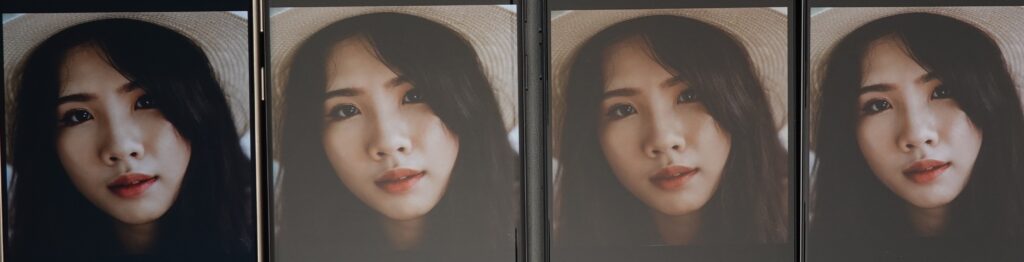

Color behavior on the corner
Color shift on the corner

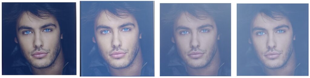

Dropped video frames

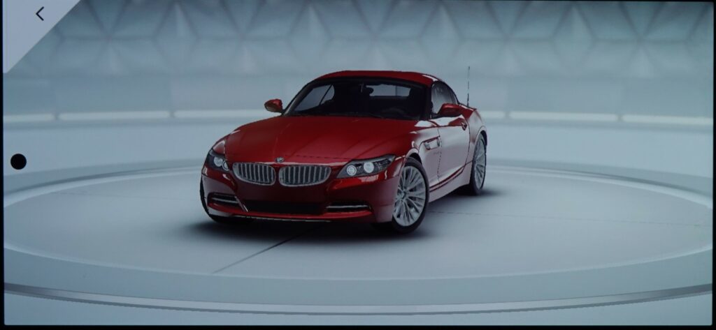

Aliasing (foreground)
