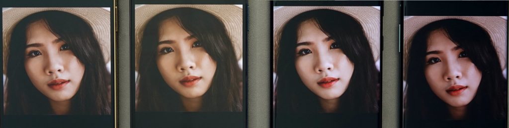

Overall readability is exceptional both inside and out. In indoor conditions (as in the illustration below), the Samsung Galaxy S21 Ultra 5G (Snapdragon) is brighter but shows less detail in the hair than the iPhone 13 Pro Max, which provides the most faithful image rendering.
Readability indoors (1000 lux).
Left to right: Apple iPhone 13 Pro Max, Apple iPhone 12 Pro Max, Samsung Galaxy S21 Ultra 5G (Snapdragon), OnePlus 9 Pro
Photo for illustrative purposes only

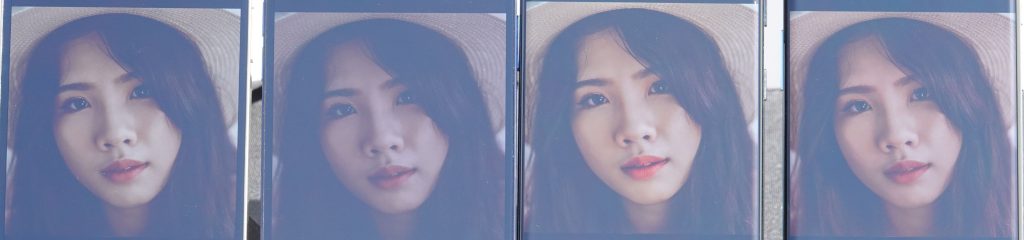

The Apple iPhone 13 Pro Max is very readable in sunlight, while maintaining a natural-looking color rendering. The 13 Pro Max shows a big improvement over the 12 Pro Max in terms of brightness, but also in terms of the visibility of details in dark areas. Note that in the illustration below, the Samsung image appears brighter than the 13 Pro Max image (1379 nits measured on the Samsung and 1066 nits measured on the iPhone), but our engineers found that after a few minutes in sunlight , the S21 Ultra 5G (Snapdragon) would reduce its brightness, presumably to avoid overheating. The 13 Pro Max had no problems in similar conditions and maintained its brightness.
Readability in a sunlight environment (> 90 0000 lux).

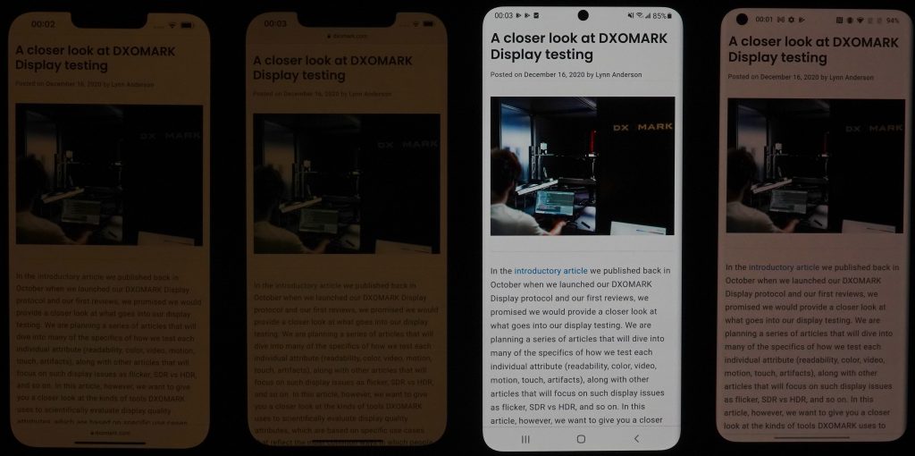

The Apple iPhone 13 Pro Max adjusts its brightness very smoothly to changing lighting conditions. With the default settings, however, the device is still too dark during night reading (blue light filter disabled):
Readability in a low light environment (0 lux).
BLF off, left to right: Apple iPhone 13 Pro Max, Apple iPhone 12 Pro Max, Samsung Galaxy S21 Ultra 5G (Snapdragon), OnePlus 9 Pro

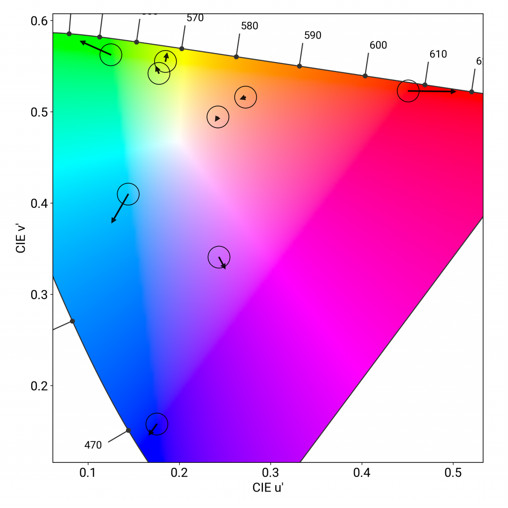

Samsung Galaxy S21 Ultra 5G (Snapdragon), 1000 lux color fidelity, sRGB color space. Many arrows extend outside the circles, which means that the color differences are noticeable.
Each arrow represents the color difference between a target color model (arrow base) and its actual measurement (arrowhead). The longer the arrow, the more visible the color difference. If the arrow stays inside the circle, the color difference will only be visible to trained eyes.

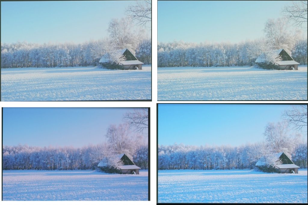

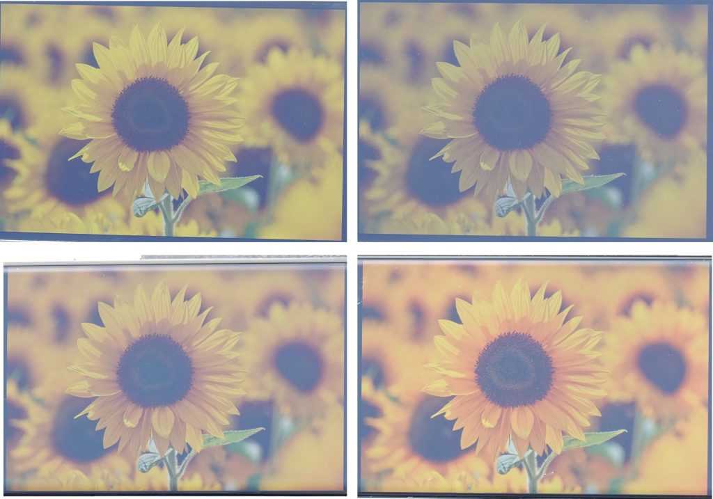

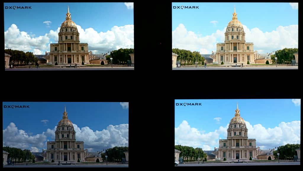

Although the iPhone 13 Pro Max has a slight green cast on the outside, it is even more accurate and pleasing than the Samsung Galaxy S21 Ultra 5G (Snapdragon), which is too saturated and orange.
Color rendering in sunlight (> 90 0000 lux)
Clockwise from top left: Apple iPhone 13 Pro Max, Apple iPhone 12 Pro Max, Samsung Galaxy S21 Ultra 5G (Snapdragon), OnePlus 9 Pro

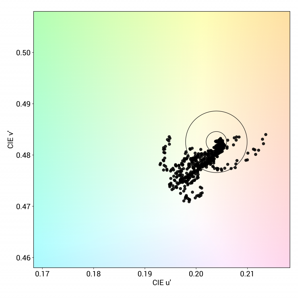

Apple iPhone 13 Pro Max, close-up of the white point showing the scattering. Note that the scatter stays quite close to the outer circle, which means that the color differences are barely noticeable.

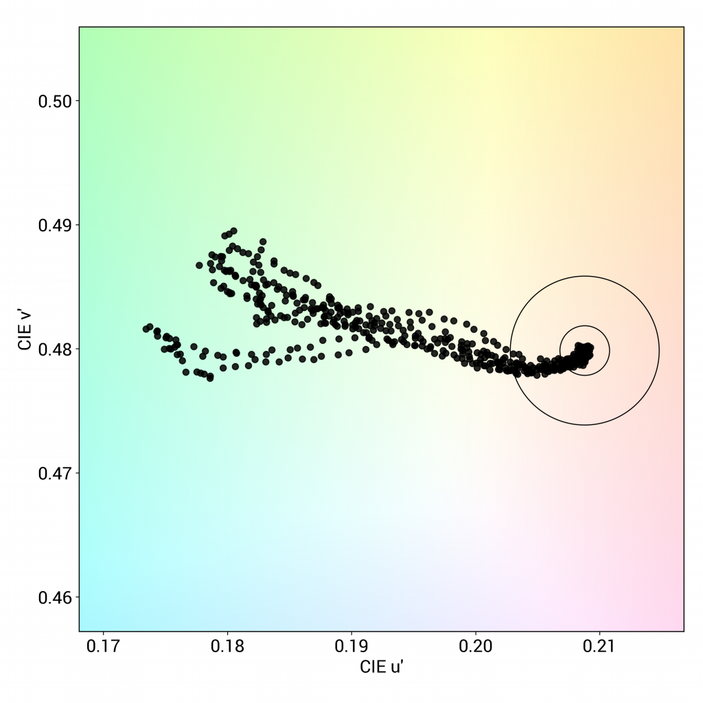

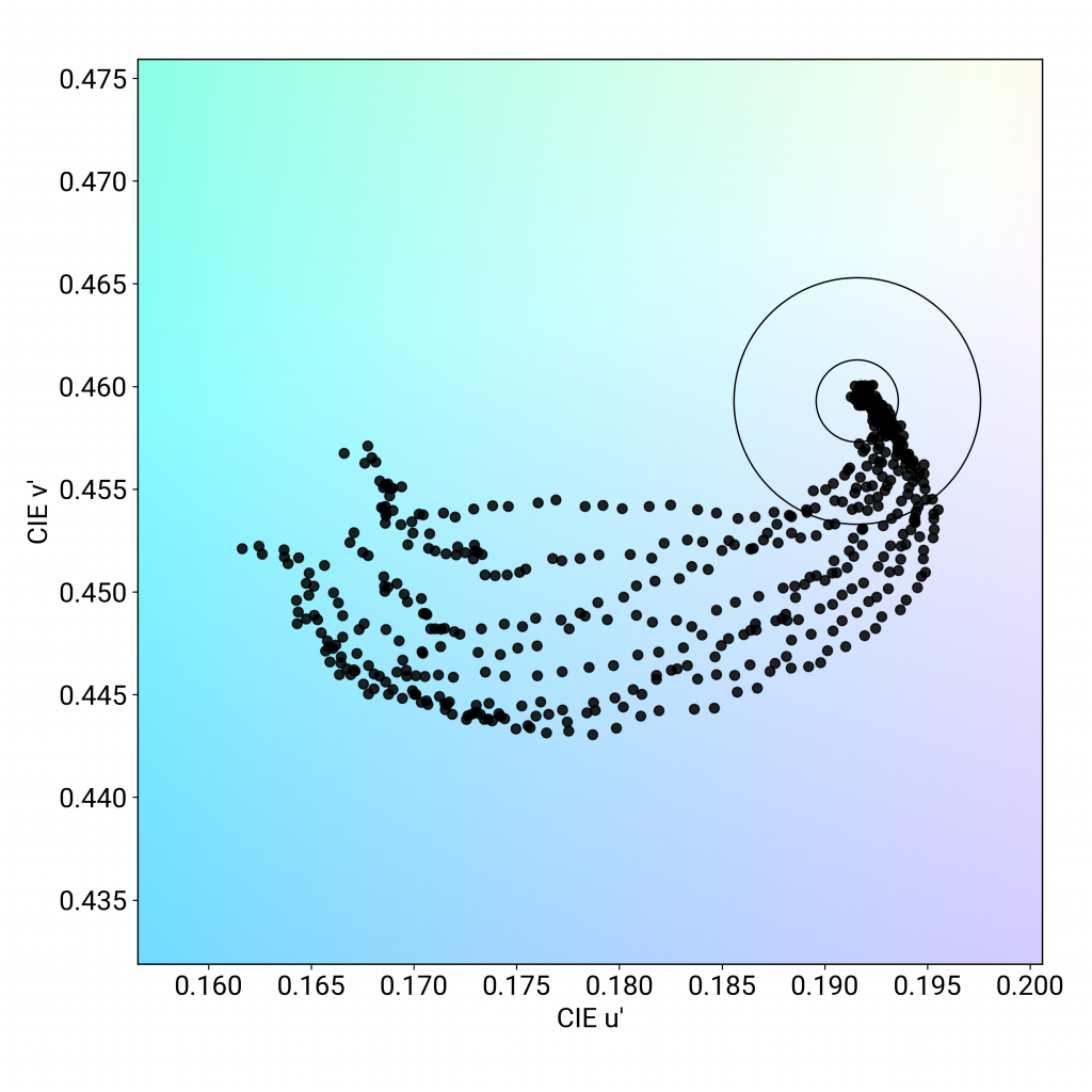

Apple iPhone 12 Pro Max, close-up of the white point showing the scattering. The scatter heading towards the blue-green becomes more and more evident the further it is from the outer circle.
Samsung Galaxy S21 Ultra 5G (Snapdragon), close-up of the white dot showing the scatter. The scatter that goes through the violet towards the blue-cyan becomes more evident the further it is from the outer circle.
This graph shows the shift of color when the screen is tilted. Each point represents a measurement with a particular angle. The points inside the inner circle show no color change in the corner; those between the inner and outer circle have shifts that only trained experts will see; but those who fall outside the outer circle are noted.

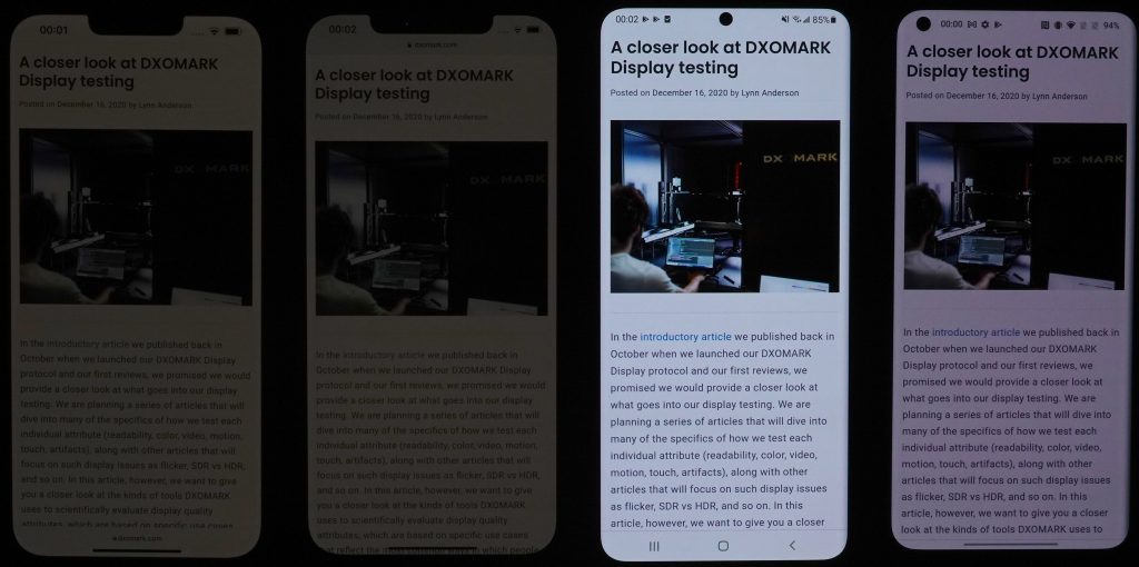

But while its overall color rendering is much improved over the 12 Pro Max, the iPhone 13 Pro Max still has the same very noticeable orange cast with the 12 Pro Max’s activated blue light filter.
Color temperature rendering with BLF ON in a low light environment (0 lux).
BLF on, left to right: Apple iPhone 13 Pro Max, Apple iPhone 12 Pro Max, Samsung Galaxy S21 Ultra 5G (Snapdragon), OnePlus 9 Pro

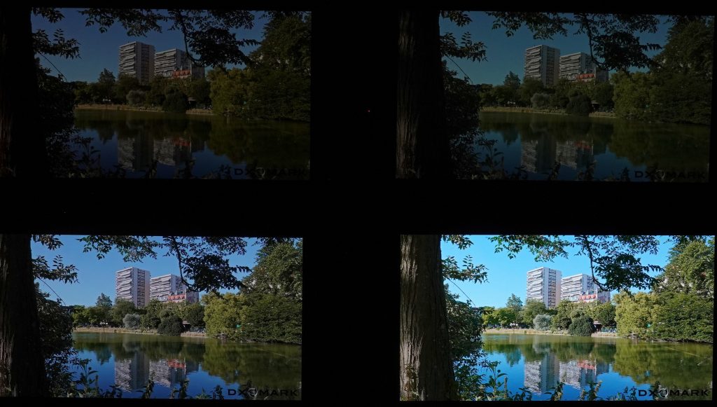

The Apple iPhone 13 Pro Max is great for watching HDR10 videos. There are no dropped frames or vibrations, and its HDR rendering is outstanding. Additionally, it has wider dynamic range and good brightness, and does a better job with contrast and tone mapping than the 12 Pro Max.
Video contrast (HDR), clockwise from top left: Apple iPhone 13 Pro Max, Apple iPhone 12 Pro Max, Samsung Galaxy S21 Ultra 5G (Snapdragon), OnePlus 9 Pro. Note that although the clouds and trees in the photo illustrating the performance of the iPhone 13 Pro Max may appear cropped, the actual rendering on the device itself does not show any cropping.

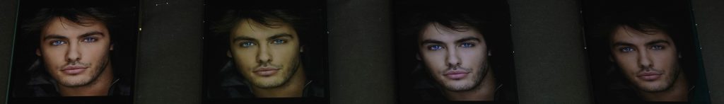

In low light, the iPhone 13 Pro Max is significantly dimmer than the Samsung Galaxy S21 Ultra 5G (Snapdragon) when playing SDR content, and Apple users may want to manually increase the brightness:
Video contrast (SDR), clockwise from top left: Apple iPhone 13 Pro Max, Apple iPhone 12 Pro Max, Samsung Galaxy S21 Ultra 5G (Snapdragon), OnePlus 9 Pro

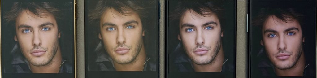

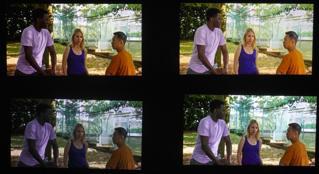

The video colors of the iPhone 13 Pro Max are faithful, especially compared to the 12 Pro Max, which has a visibly yellow cast. When evaluated Cons the test reference photo, the colors of both the 13 Pro Max and Samsung only land on both sides, with the 13 Pro Max on the warmer side and the Samsung appearing a bit cooler.
Clockwise from top left: Apple iPhone 13 Pro Max, Apple iPhone 12 Pro Max, Samsung Galaxy S21 Ultra 5G (Snapdragon), OnePlus 9 Pro. Skin tones are actually rendered more accurately, with the The hotter iPhone 13 Pro Max and the Samsung Galaxy S21 Ultra 5G (Snapdragon) a little cooler.

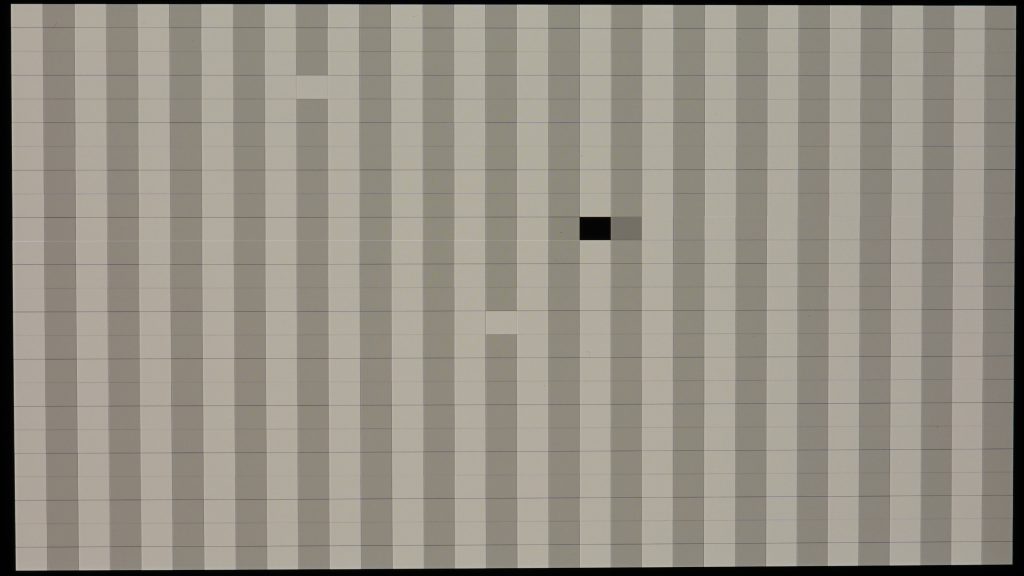

The Apple iPhone 13 Pro Max shows no frame drops or stutters when playing videos, unlike the 12 Pro Max, S21 Ultra 5G (Snapdragon) and OnePlus 9 Pro. Furthermore, the iPhone 13 Pro Max has no tremors at 24, 30 and 60 fps, which also applies to the Samsung device. To show a 24fps video on a 60Hz display, like on the iPhone 12 Pro Max, the device must perform a 3: 2 pulldown as shown in the photo below.
Moving objects appear sharp in videos. The device is responsive when jumping forward or backward in videos; however, there may be some blocking or pixeling artifacts in some cases, but this behavior is quite rare.
While gaming, our testers found no frame drops with the iPhone 13 Pro Max, although some were visible on the 12 Pro Max and S21 Ultra 5G (Snapdragon).

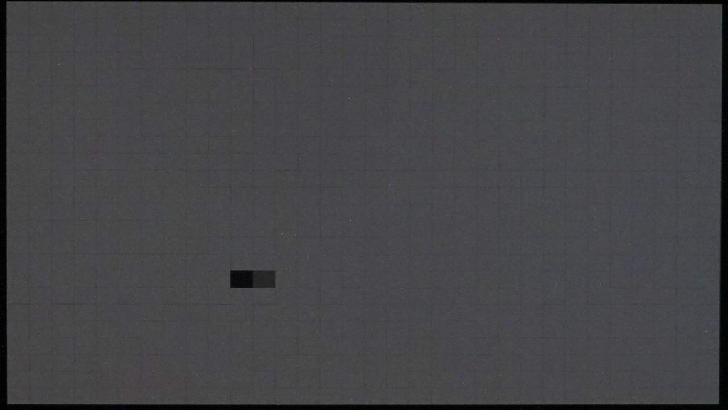

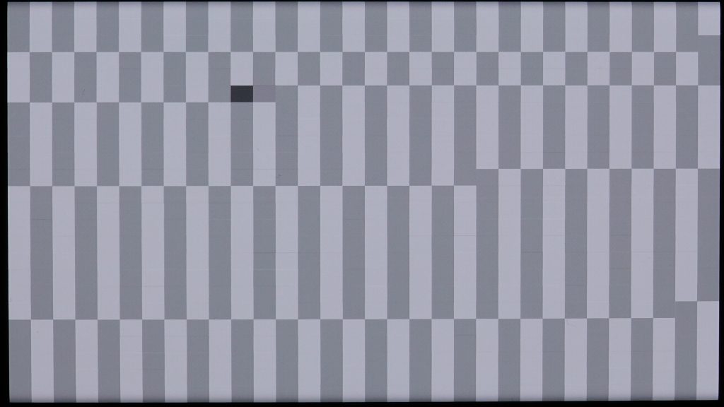

The video frame drops
Apple iPhone 13 Pro Max, illustration of frame drops on a 24 fps video; no frame falls or visible vibrations
Apple iPhone 12 Pro Max, illustration of frame drops on a 24 fps video; 3: 2 pulldown judder pattern and two visible stammers
OnePlus 9 Pro, illustration of frame drops on a 24 fps video; 3: 2 pulldown pattern and some visible frame drops
Samsung Galaxy S21 Ultra 5G (Snapdragon), illustration of frame drops on a 24 fps video; no jerks, but some stammering is visible
