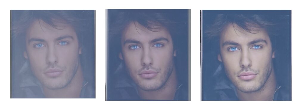

Readability evaluates the ease and comfort with which users can read the still content (photos and web) on the display under various real-life conditions. SBMARK uses its Display Bench to recreate ambient light conditions ranging from total darkness to bright sunlight. In addition to laboratory tests, perceptual analysis is also performed in real-life environments.
From left: OnePlus 11, OnePlus 10 Pro, Samsung Galaxy S23+
Readability in a sunlight environment (>90,000 lux).

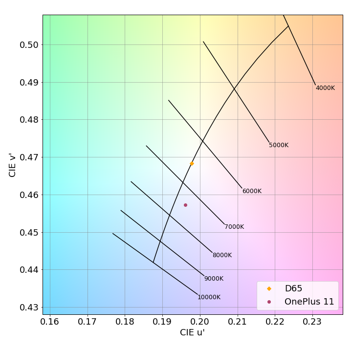

Color fidelity measurements
OnePlus 11, color fidelity at 1000 lux in the sRGB color space
OnePlus 11, color fidelity at 1000 lux in Display-P3 color space
Each arrow represents the color difference between a target color pattern (arrow base) and its actual measurement (arrow tip). The longer the arrow, the more visible the color difference. If the arrow stays inside the circle, the color difference will only be visible to trained eyes.

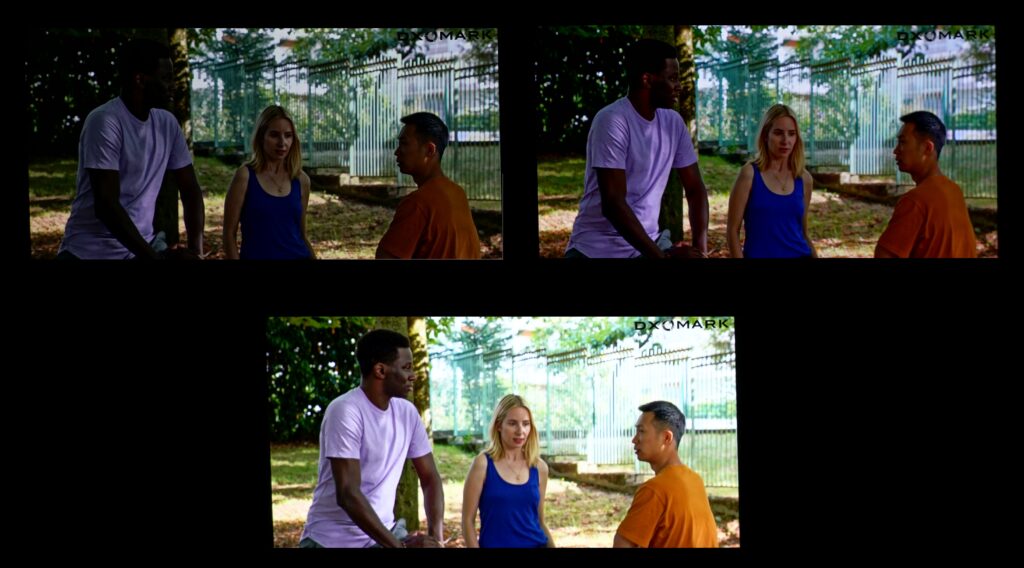

Our video attribute evaluates each device’s Standard Dynamic Range (SDR) and High Dynamic Range (HDR10) video handling in indoor and low-light conditions. We measure the tone mapping, color gamut, brightness and contrast of the display. We perform perceptual analysis Cons our professional reference monitor (Sony BVM-HX310) to ensure rendering respects artistic intent.
Clockwise from top left: OnePlus 11, OnePlus 10 Pro, Samsung Galaxy S23+
Primary colors are measured in both HDR10 and SDR. The extracted color gamut shows the extent of color area that the device can render. To meet artistic intent, the measured gamut should match the primary color space of each video.

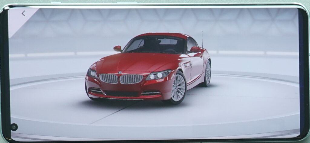

Evaluating artifacts means checking performance, image rendering, and motion artifacts that can impact the end-user experience. SBMARK accurately measures device reflectance and flicker, and evaluates the impact of residual aliasing when playing video games, among other characteristics.
Aliasing (foreground)
One Plus 11
