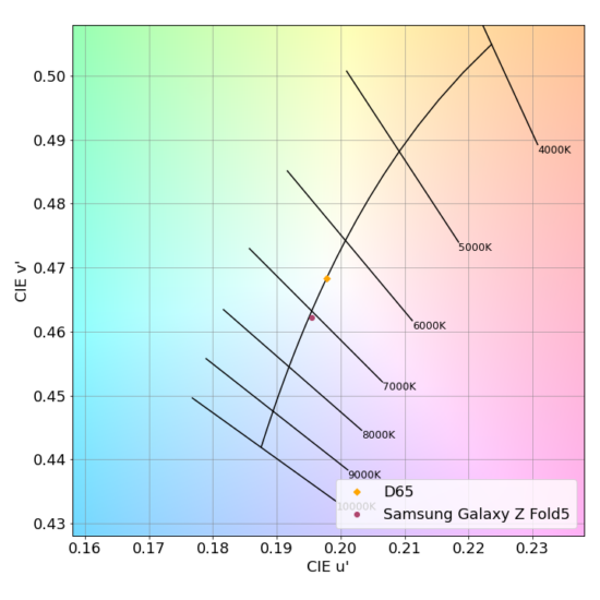

White point under illuminant D65 at 1000 lux
Clockwise from top left: Samsung Galaxy Z Fold5, Google Pixel Fold, Honor Magic Vs

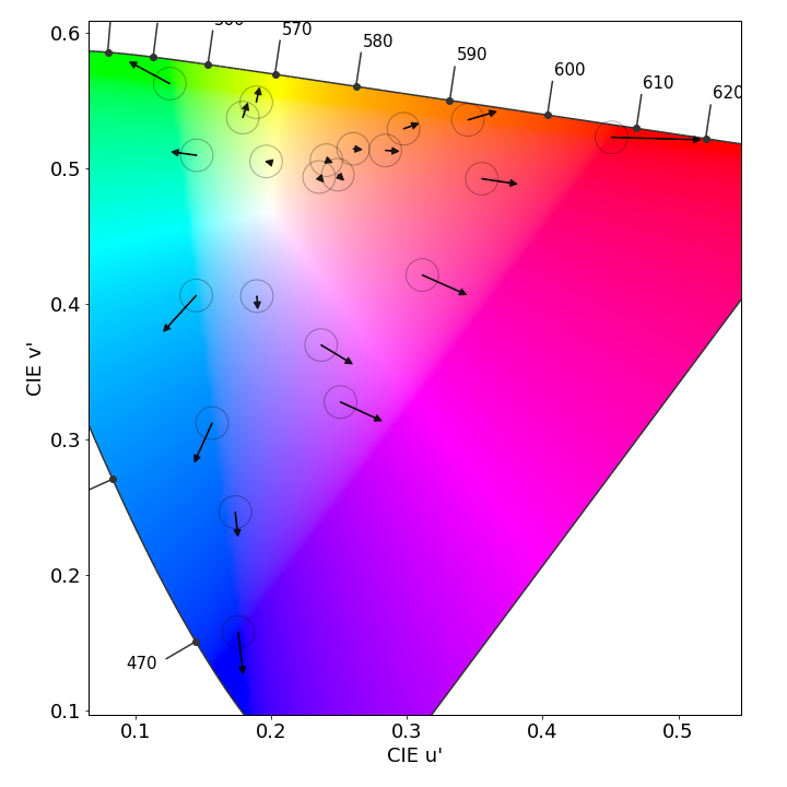

Color fidelity measurements
Samsung Galaxy Z Fold5, color fidelity at 1000 lux in the sRGB color space
Samsung Galaxy Z Fold5, color fidelity at 1000 lux in Display-P3 color space
Each arrow represents the color difference between a target color pattern (arrow base) and its actual measurement (arrow tip). The longer the arrow, the more visible the color difference. If the arrow remains inside the circle, the color difference will only be visible to expert eyes.
