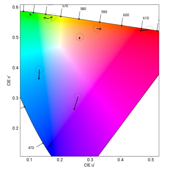

Color fidelity measurements
Honor 70, color fidelity at 1000 lux in the sRGB color space
Honor 70, color fidelity at 1000 lux in the DCI-P3 color space
Each arrow represents the color difference between a target color model (arrow base) and its actual measurement (arrowhead). The longer the arrow, the more visible the color difference. If the arrow remains inside the circle, the color difference will only be visible to trained eyes.

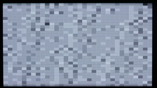

The video frame drops
These long exposure photos present the number of frame irregularities in a 30 second video. A good performance shows a regular pattern (a flat gray image or a drop-down pattern).
