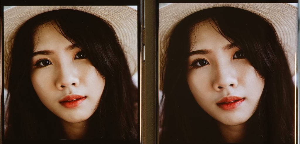

In ambient light conditions, photo viewing was affected by a yellow cast, but this did not affect skin tone. The slight yellow cast was also evident when watching the film.

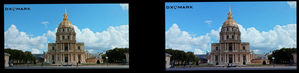

Readability evaluates the ease and comfort with which users can read the display in different real-life conditions on static content (photos and web). SBMARK uses its Display Bench to recreate ambient light conditions ranging from total darkness to bright sunlight. In addition to laboratory tests, perceptual analysis is also carried out in real-life environments.
Indoor at 1000 lux, left to right: Samsung Galaxy S22 + (Exynos) and Samsung S22 Ultra (Exynos)

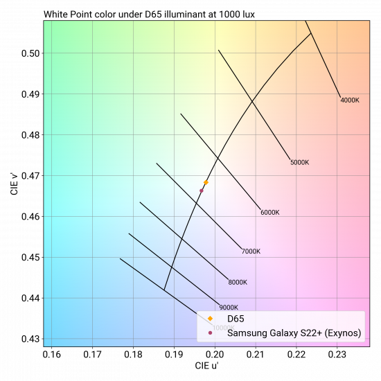

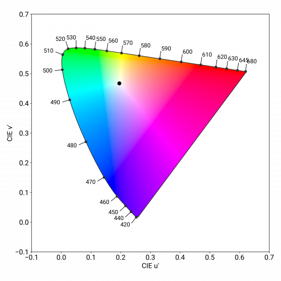

White point color temperature in indoor lighting conditions (1000 lux)

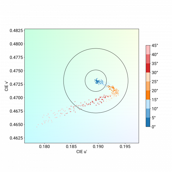

This graph shows the shift of color when the screen is tilted. Each point represents a measurement with a particular angle. The points inside the inner circle show no color change in the corner; those between the inner and outer circle have shifts that only trained experts will see; but those who fall outside the outer circle are noted.
White dot on the corner, Samsung Galaxy S22 + (Exynos)

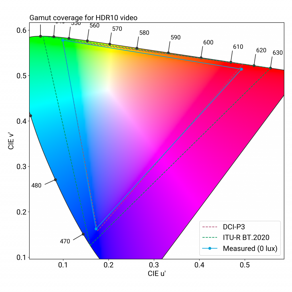

Our video attribute evaluates the Standard Dynamic Range (SDR) and High Dynamic Range (HDR10) video handling of each device indoors and in low-light conditions. We measure the tone mapping, color gamut, brightness and contrast of the display. We perform perceptual analysis Cons our professional reference monitor (Sony BVM-HX310) to ensure that the rendering respects the artistic intent.

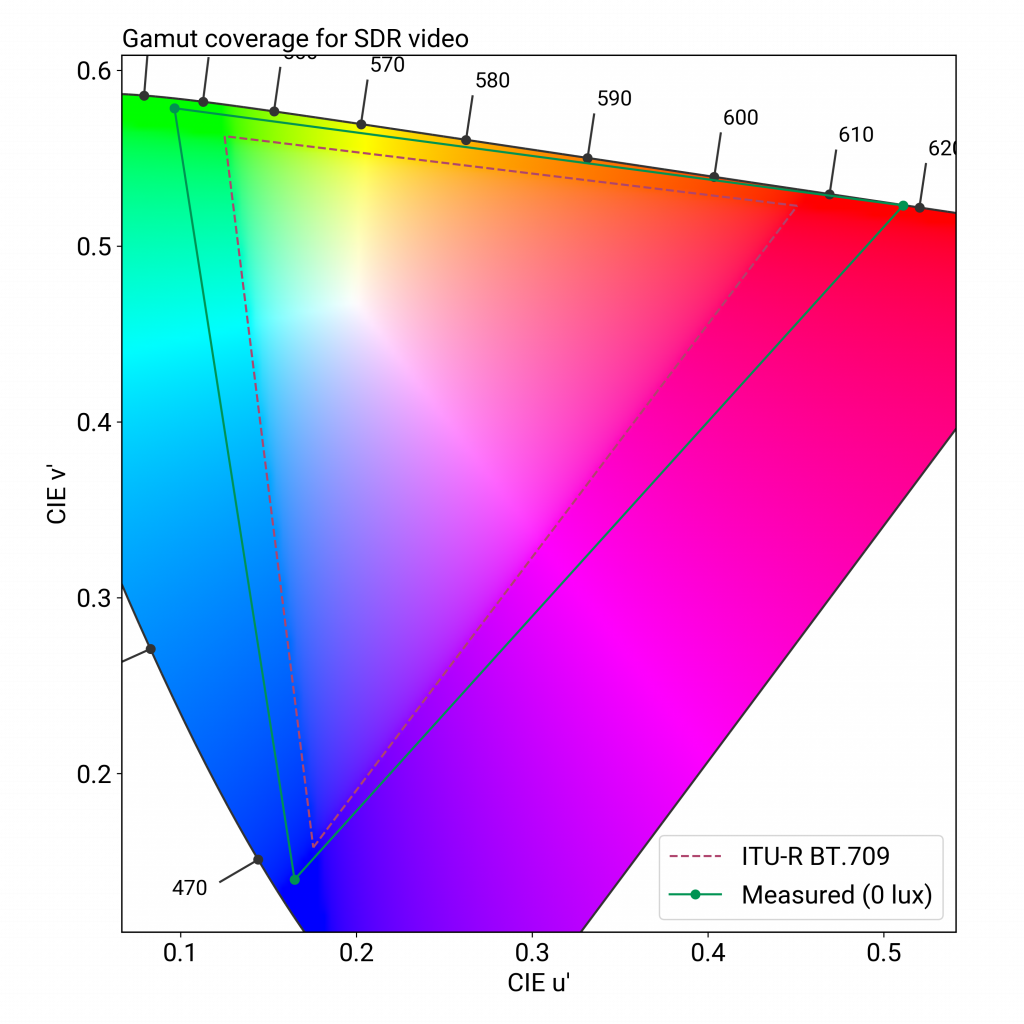

Primary colors are measured in both HDR10 and SDR. The extracted color gamut shows the extent of the color area that the device can render. To respect the artistic intent, the measured gamut should match the mastering color space of each video.
Left to right: Samsung Galaxy S22 + (Exynos), Samsung Galaxy S22 Ultra (Exynos)

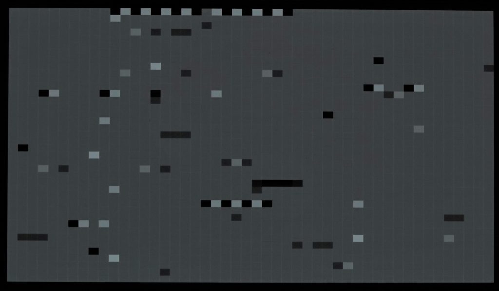

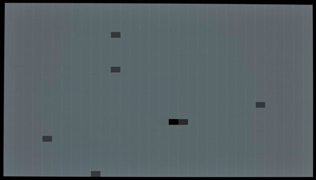

The video frame drops
Samsung Galaxy S22 + (Exynos) at 30 fps
Samsung Galaxy S22 + (Exynos) at 60 fps
This long exposure photo presents the number of frame irregularities in a 30 second video. A good performance shows a regular pattern (a flat gray image or a drop-down pattern).
