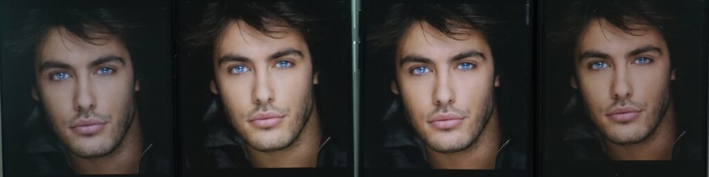

Readability evaluates the ease and comfort with which users can read stationary content (photos and web) on the display in various real-life conditions. SBMARK uses its Display Bench to recreate ambient light conditions ranging from total darkness to bright sunlight. In addition to laboratory tests, perceptual analysis is also carried out in real-life environments.
Readability indoors (1000 lux).
From left: Xiaomi 12T Pro, Xiaomi 11T Pro, Oppo Reno8 Pro 5G, Google Pixel 6

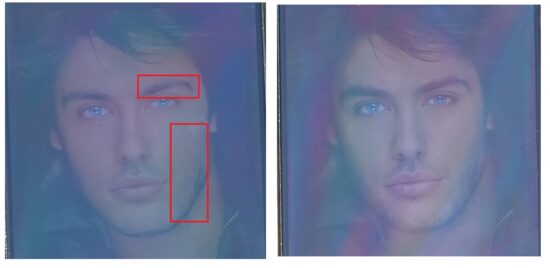

Readability in a sunlight environment (> 90 0000 lux).
Xiaomi 12T Pro, on the left, shows significantly fewer details in sunlight than the 12T in sunlight.

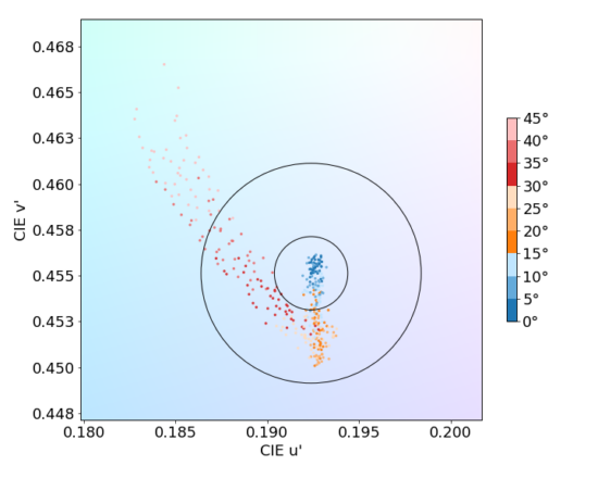

Behavior of the color on the corner
This graph shows the shift of color when the screen is tilted. Each point represents a measurement with a particular angle. The points inside the inner circle show no color change in the corner; those between the inner and outer circle have shifts that only trained experts will see; but those who fall outside the outer circle are noted.

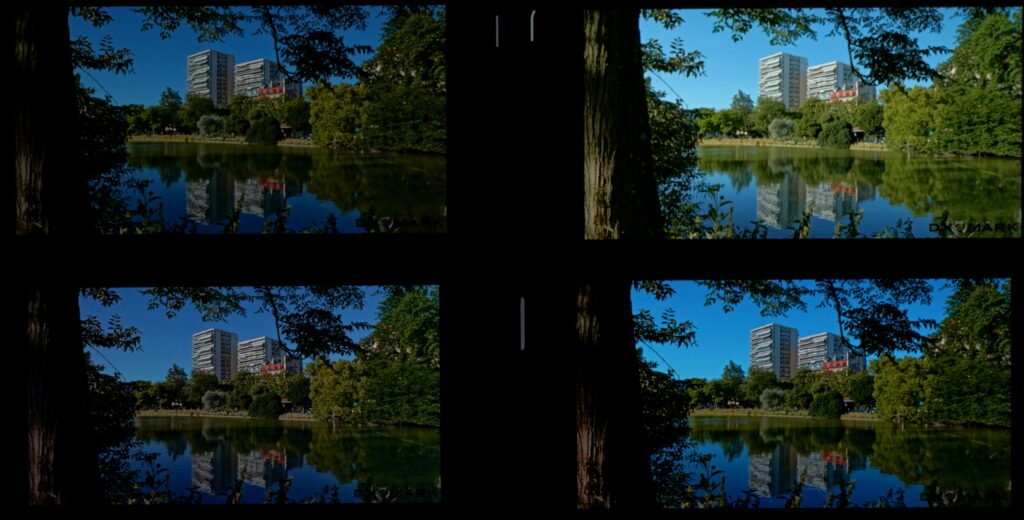

Our video attribute evaluates the Standard Dynamic Range (SDR) and High Dynamic Range (HDR10) video handling of each device indoors and in low light conditions. We measure the tone mapping, color gamut, brightness and contrast of the display. We perform perceptual analysis Cons our professional reference monitor (Sony BVM-HX310) to ensure that the rendering respects the artistic intent.
Clockwise from top left: Xiaomi 12T Pro, Xiaomi 11T Pro, Oppo Reno8 Pro 5G, Google Pixel 6
