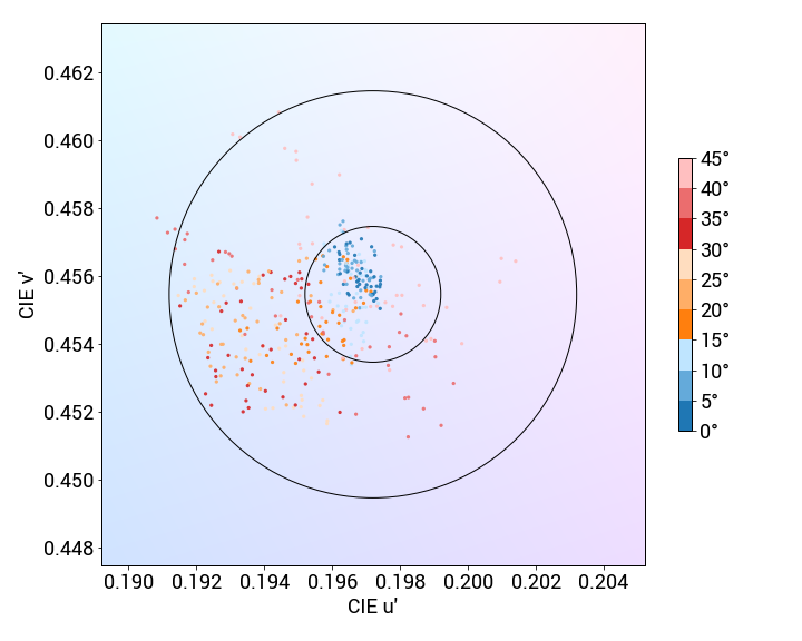

Behavior of the color on the corner
This graph shows the color shift when the screen is tilted. Each point represents a measurement with a particular angle. The points inside the inner circle show no color change in the corner; those between the inner and outer circle have shifts that only trained experts will see; but those who fall outside the outer circle are noted.

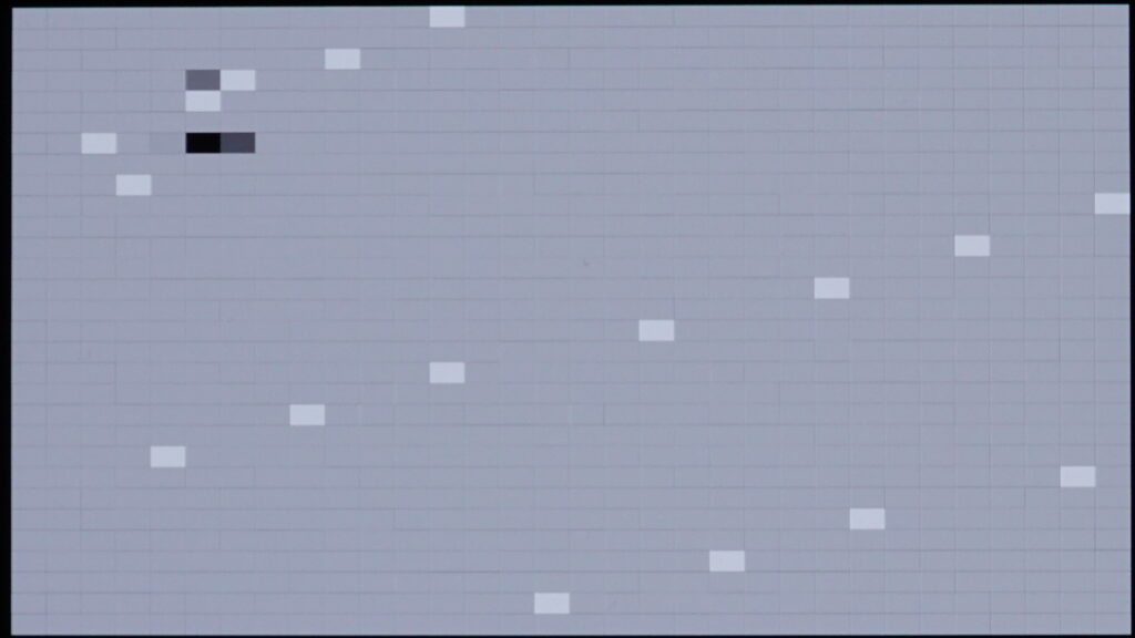

The video frame drops to 30 fps
These long exposure photos present the number of frame irregularities in a 30 second video. A good performance shows a regular pattern (a flat gray image or a drop-down pattern).
