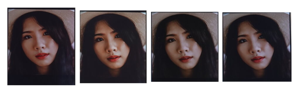

Readability evaluates the ease and comfort with which users can read the still content (photos and web) on the display under various real-life conditions. SBMARK uses its Display Bench to recreate ambient light conditions ranging from total darkness to bright sunlight. In addition to laboratory tests, perceptual analysis is also performed in real-life environments.
From left to right: Black Shark 5 Pro, Black Shark 4 Pro, Realme GT 2 Pro, Xiaomi 12T Pro

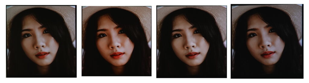

Readability in a sunlight environment (>90 0000 lux).

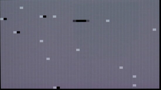

The video frame drops
These long exposure photos feature the number of frame irregularities in a 30 second video. Good performance shows a regular pattern (a flat gray image or a pull-down pattern).

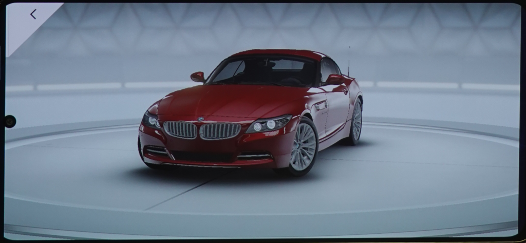

Evaluating artifacts means checking performance, image rendering, and motion artifacts that can impact the end-user experience. SBMARK accurately measures device reflectance and flicker, and evaluates the impact of residual aliasing when playing video games, among other characteristics.
Aliasing (foreground)
Black Shark 5Pro
Black Shark 5 Pro – Crop1
Black Shark 5 Pro – Crop 2
Black Shark 5 Pro – Crop3
